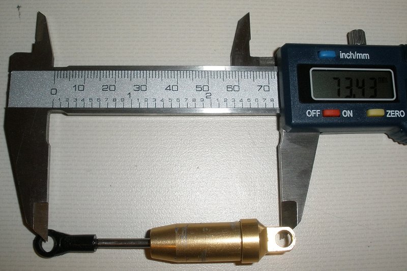

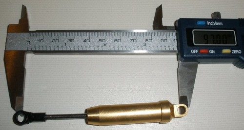

Re: First post! my ultima project and questions
Here are some Kyosho Gold shock specs so you can compare with your shock sizes.
Front expanded hole-to-hole length: ~73 mm
Rear expanded hole-to-hole length: ~97 mm
Using spacers and different ball ends, you could probably figure on a workable length +/- 5mm of those specs.
As I said before, I could spare a set of fronts for $25 plus shipping, if you're interested. Kyosho Golds are probably the smoothest, best-performing shocks you could put on that Ultima.
