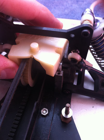

Re: Painting Yz10 Nylon bulk head covers
ummm, Guilty!
I boiled my first set in dye. I forgot to keep them attached to the bulkheads and as you can see by the picture, the cap holes are a little way off.

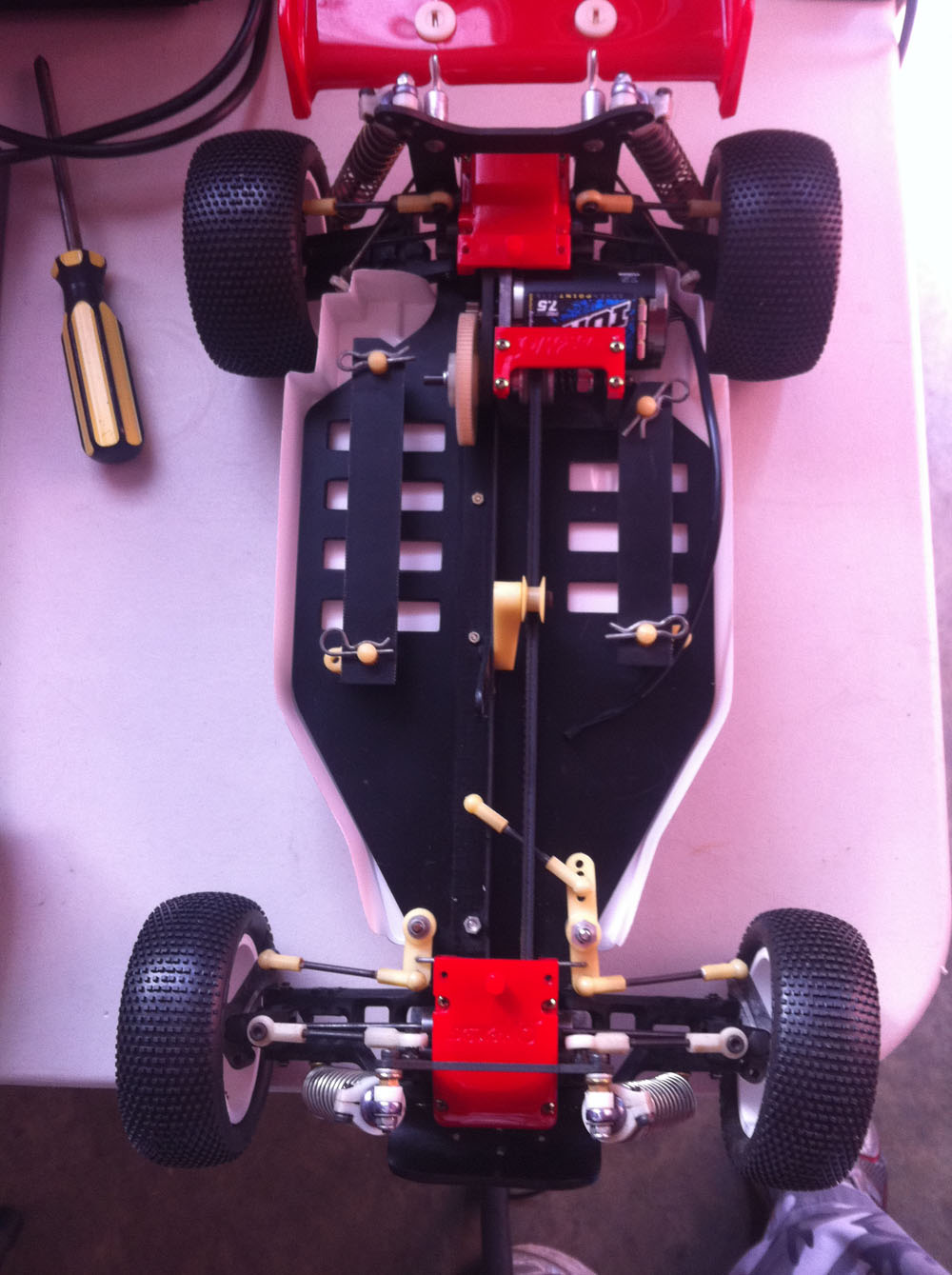

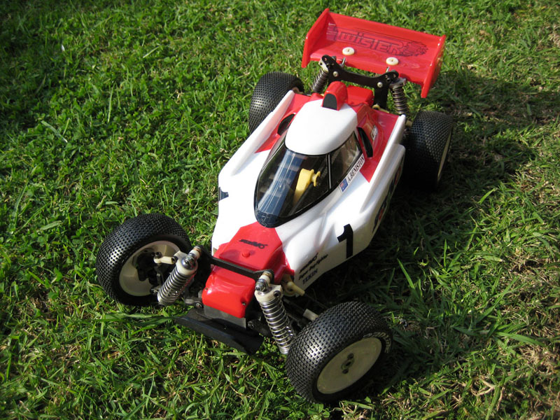

Update.
The Tamiya TS paint worked.
The rctech guys have seen these piccys already, but the paint came up very well. I am really happy with how it has stuck and gone on evenly. I just have to get my white parts back to white after a failed attempt to get them bright yellow.
