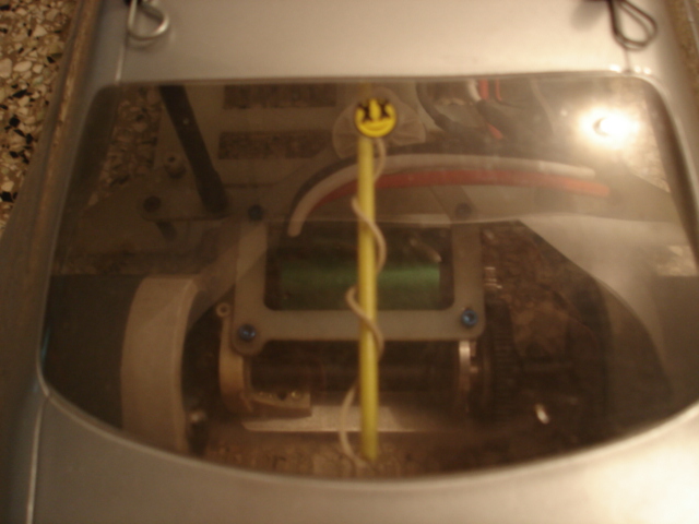

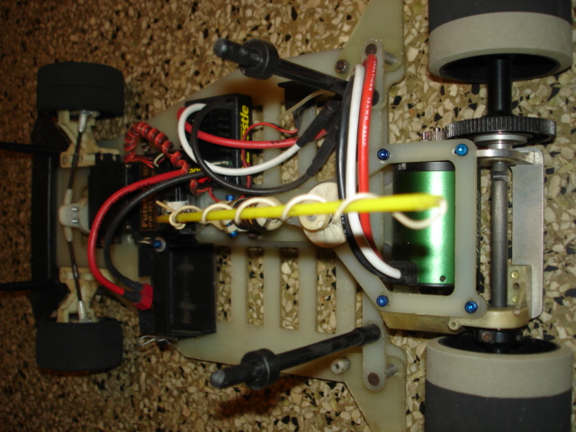

I bought the 4 pole 5700kv sidewinder to run record speeds in a 10lss. I ran a 4200nimh 6 cell with 78/22,23 gearing and saw no problems. I jumped up to a 78/27 and broke the 60mph with no problems (initially).
10 minutes into the run the system shut down at 195 degrees. I did the unthinkable and continued to run high speed blasts and the system shut down at the end of each run. I can verify the fail-safe works perfectly.
60mph from an rc car is pretty damn cool, no doubt. I thought for sure the fun would last at least 30 minutes in one of the lightest 1/10 rc cars in the world... WRONG!!! I will try the same gearing with 3300 + 6 cell batteries next.
I will obviously need to run a lower kv motor in the jammin scrt10. I would appreciate any gearing insight as the truck is something I know absolutely nothing about.

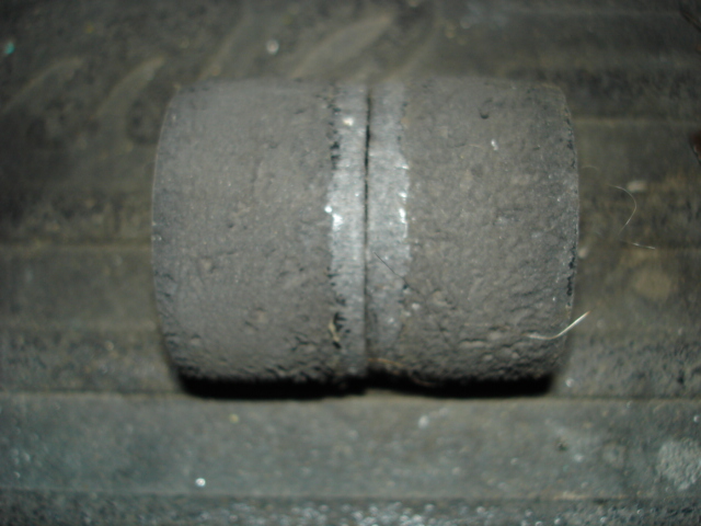

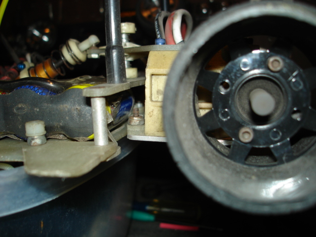

Thanks for the info Rootdown. I was able to overcome the cogging and other interference problems by swapping transmitters. I switched back to my older Japanese Mag Jr. when I realized interference occurred even when I touched the pots on the "newer" transmitter. The pots on the older Jr. are brass, newer are plastic.
I hope the previous shutdowns were a result of increased temps due to interference, glitching and cogging more than the reasonable 78/27 gearing. I plan to step up pinions to the same combo that overheated before. I am running in a parking lot, not a prepared track. Too much power and the car breaks loose. All that to say I am not running the car into the ground. This system would surely burn up in a heavier rc10 running through high traction mud or grass! 78-81/16-18 gearing for the rc10, 78/23 in the pan car to avoid a melt down. Am I expecting too much of a $100 combo???
No wonder my car began to push after a few huge 50+mph ovals... rears have some life left ;) I better pick up a few liters of soda for the track!
