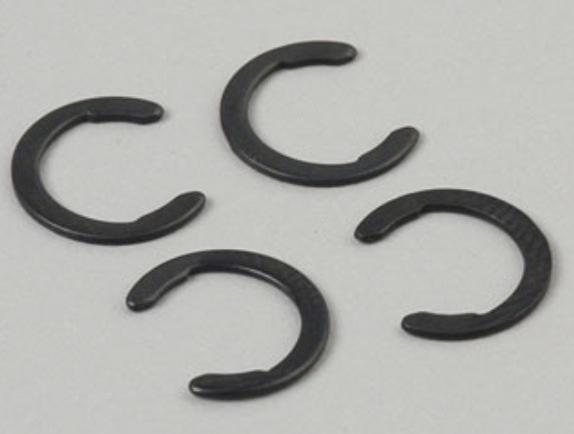

will definitely replace the whole clutch assembly. I just don't like the overall stock design and especially the e-clip. I've seen simpler designs with less parts and a screw or bolt holding the bell on rather than an e-clip. but I guess that would require a normal shaft on the engine.

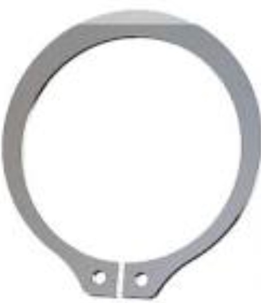

You can use a retaining ring or a c clip if it makes you feel better but honestly I have never had a e clip bounce off, that is strange. A c clip would be my choice tho, and you can find them likely at your local hardware store. If not McMaster Carr for sure. There were gt series engines with a cut crank from OS for sure. I sold plenty of em!
I think you will be happy with a new stock clutch, but is still try to find a mip clutch. Those were the first upgrade I would always recommend, they were awesome!
