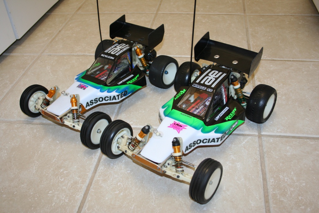

So after replacing the bottom loaders with the top loading shocks, the front 15deg blocks with 25's, the steel inline axels and carriers with the 6221's, the steering bellcranks to the BB ( white worlds 8) ) style, moving the battery cup up to the 7 cell position, replacing the cut up rear bulkhead ( didn't actually need to ) Installing a Stealth, B2 CVD's, 0deg rear truck carriers ( need more of these in white if anyone has some to spare) and installing a graphite tranny brace and proline Feather lite rear wheels and proline wide front wheels, I am actually ( well not technically ) done and it is ready to race-
Of course while I was out getting Greene's car I just had to stop by the LHS to get some Ti screws, Ti Turnbuckles, etc etc
8)

looks good. what body are you throwin' on it?
Posts: 9284
Has thanked: 357 times
Been thanked: 470 times
Re: New Racer for a new track grand opening-
One of Jay's RCPS Turbo Mirages, of course I have to get you to apply the Florescent yellow in it first :lol: :wink:
I have more to do ( of course ), I am going to cut the sides of the chassis down by 1/4", the motor plate, and the front of the nose and the back of the nose- shorten the nose brace tubes and sand the rest of the edges probably send this one to Jake as well for the outer worlds milling service too 8)
