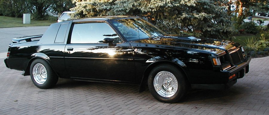

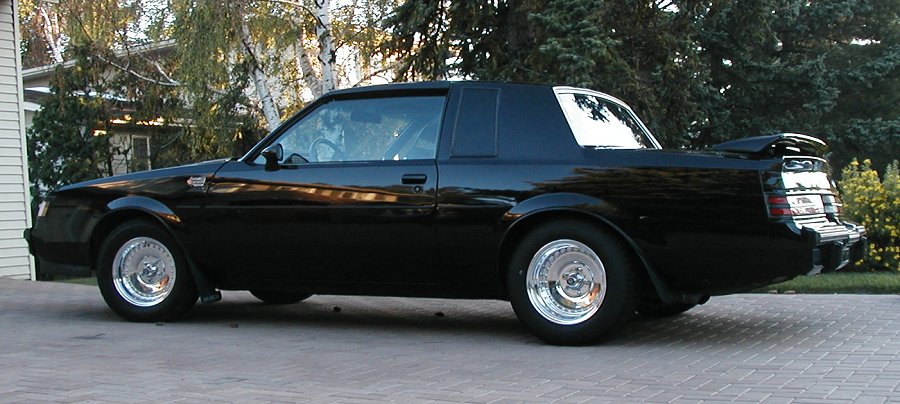

Pictures of how it looks these days...

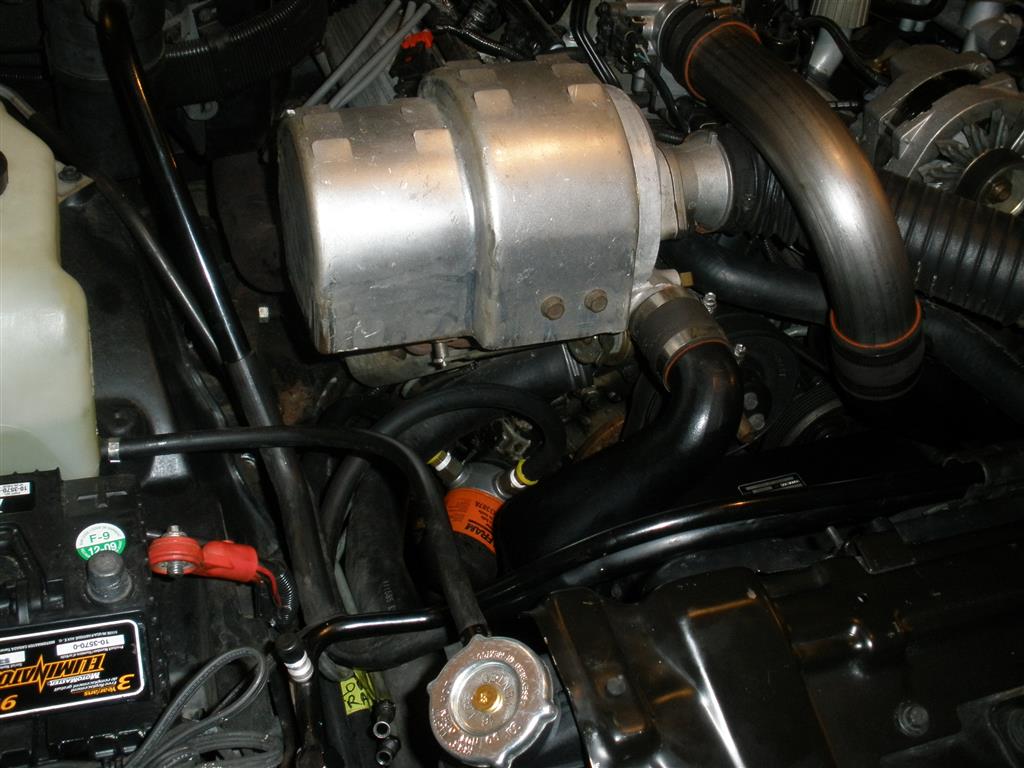

I wasn't able to drive the car much the last couple summers because it had some issues with the brakes & coolant leaking. The brakes were spongy and the brake warning light would come on every time I pressed the pedal, so I couldn't drive it until that was resolved, and I didn't have the funds. My buddy came over to help me bleed the brakes, I topped up the master cylinder, and...same thing. Spongy brakes, brake warning light every time the pedal was touched. :? The problem was ignorance. The GNs had a different brake system than the Hydroboost system that's like every other vacuum-operated brake system you see on GM cars. The Powermaster system only appeared for a few years on the GNs/Turbo T's and operates differently. It's fickle but once you know how it's supposed to work, it's actually quite easy to troubleshoot. The problem was we were overfilling the cylinder reservoirs. :roll: The fender-side one should be about 75% full when cold, and the engine-side is only about 25% full. When you turn the car on, the reservoirs should normally fill up to the correct levels. So once I turkey-basted out the extra fluid and drove around a while, everything sorted itself out.

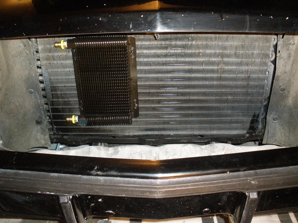

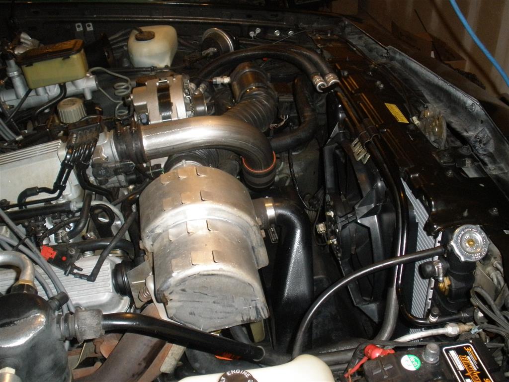

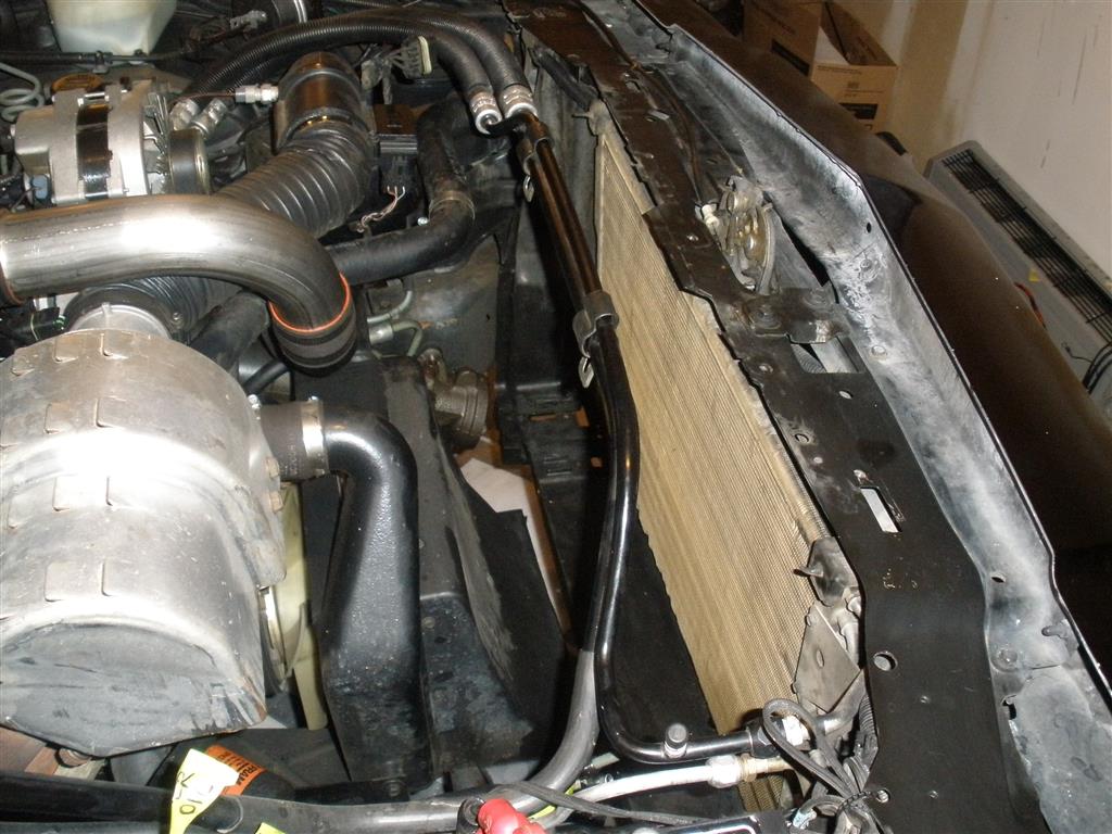

However, even after only a 5-minute drive, after I stopped & turned off the car, it would puke coolant everywhere under the rad. I started off by replacing the "simple things", buying a new 16-lb. rad cap & 160° t-stat. Replacing a t-stat on a Turbo 3.8L is anything but simple, mind you...you have to do a lot of work just to get at it; it doesn't use a gasket like every other car, it has an O-ring; and even more annoying, the "correct" t-stat won't fit directly in the hole; I had to cut it down to reduce the diameter by about 1/2" with tin snips and a file. But even after this, it still puked coolant after a short drive. The rad looked pretty bad on the inside, and hadn't ever been replaced, so now was the time. Unfortunately, a drop-in direct-fit rad for these cars have built-in tranny & engine oil coolers and cost over $500 plus shipping! :o I read about many people doing an F-body ('82 - '92 Camaro) radiator swap, those can be had for under $150 but require an external oil cooler to be installed, and a fair bit of modding to re-route & connect the tranny cooler lines. Since that would save me about $300 after all was said & done, that's what I decided to do.
Pic with old rad removed:
B & M oil cooler mounted:
New oil cooler lines reconnected:
Fan & new rad installed:

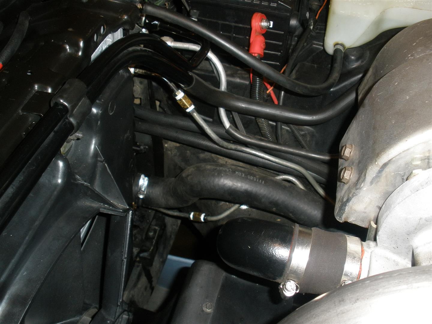

The F-body rad swap requires modding of the tranny cooler lines to make them connect to the new rad, because the original GN rad had both fittings located fairly close together, between the filler hole and lower rad hose, whereas the F-body rad has the upper fitting a bit higher and lower fitting is below the lower rad hose. I'm no expert with a pipe bender/cutter/flaring tool, but I have the kit and put it to good use when I installed an external tranny cooler on my Charger, so I figured I could do some creative re-bending of the tranny lines...but they still would be several inches too short to reach the new rad's fittings.
The original rad had these weird 5/16" steel line extensions that had couplers on the ends, and wrapped around near the top of the rad, to connect to weird 90-degree fittings for the built-in oil cooler. After looking at it, I thought I might be able to disconnect those 5/16" extension lines and re-bend & cut them, add a pair of new pipe fittings, and use the existing couplers to mate up to the tranny cooler lines, so with some careful measuring and bending, that's what I ended up doing. (I figured it would be more work to fabricate all-new tranny cooler lines.) One advantage of this mod over stock is this reduces the number of connections & potential leak points from 8 to 6. After I got everything reconnected, it looked pretty good.
Tranny cooler lines/lower rad hose reconnected:

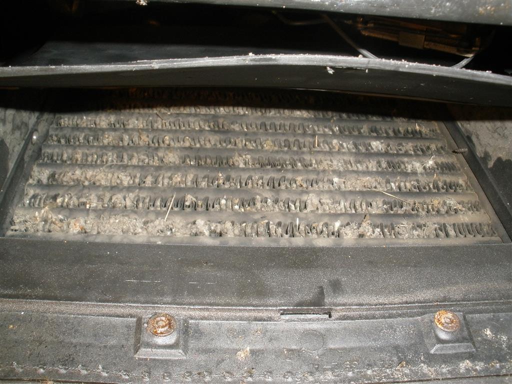

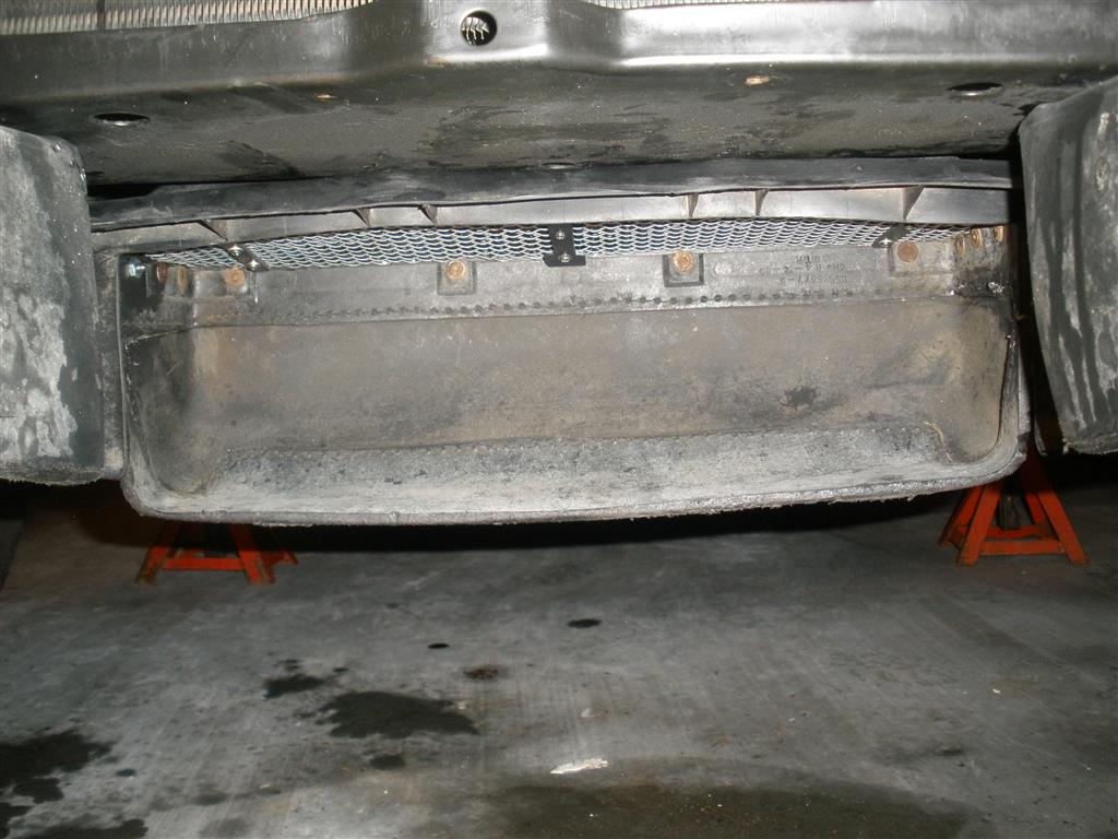

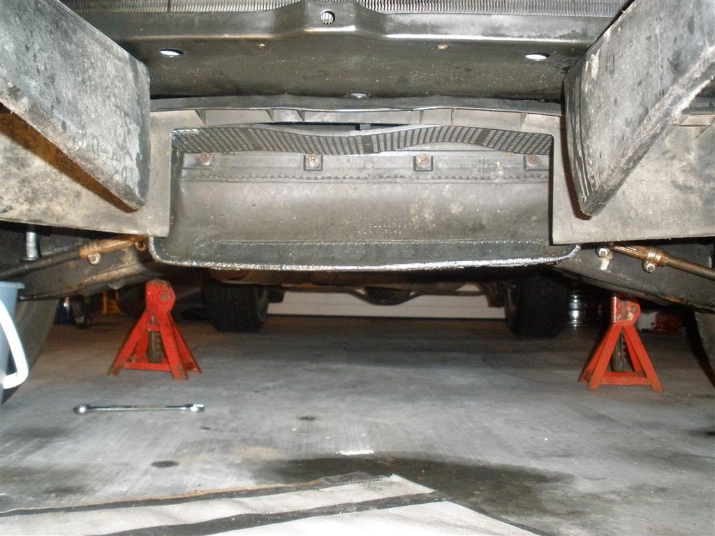

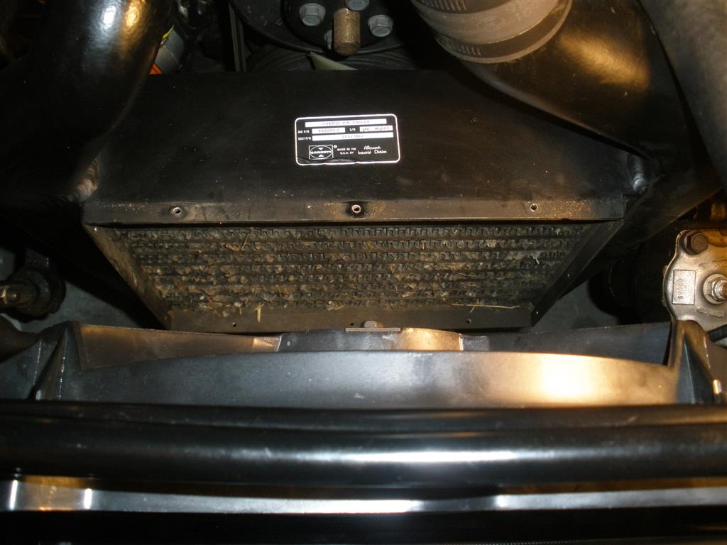

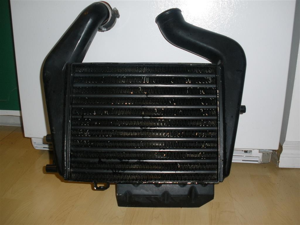

Last night, I got back under the car, reached into the intake duct behind the obstructing fairing and marked off where to cut it so it'll be flush with tire marking chalk. I then pulled out the flexible plastic grille and look what I found:
View from under car
View from above
Removed

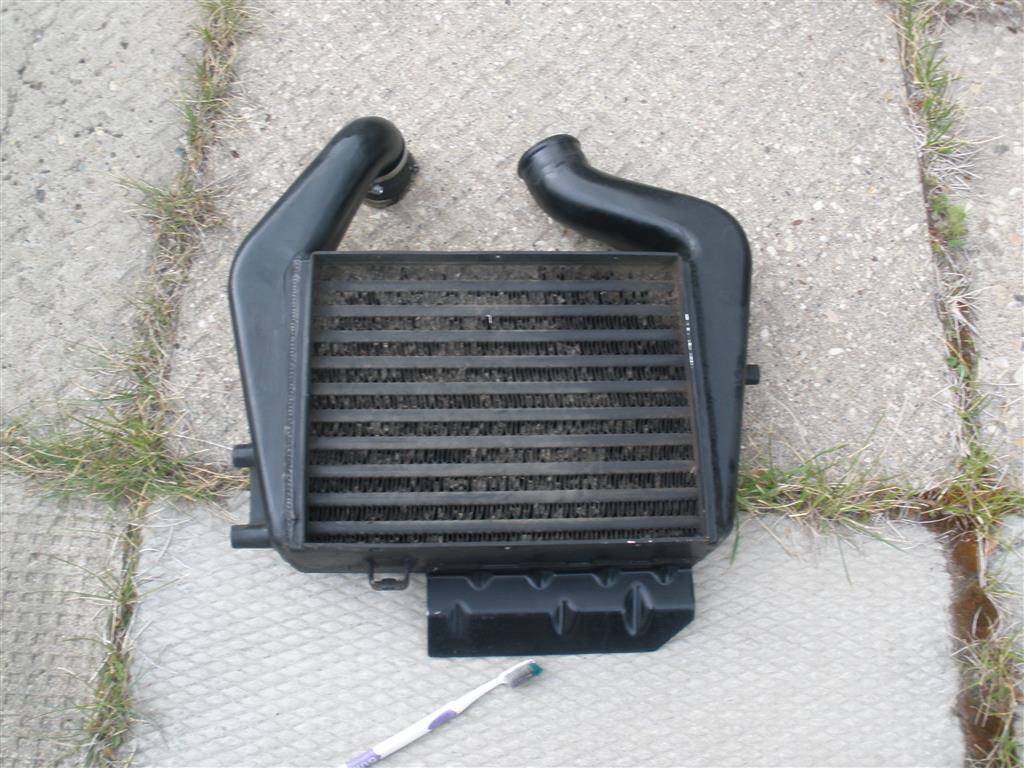

Nice... :shock: 28 years' accumulated ancient insect bodies and greasy, dusty crud. You couldn't even see through the thing. Kind of ironic to be worrying about airflow through the restrictive plastic intake grille when the cooler itself is probably hardly letting any air through. :lol:
I started out trying to brush out the crud from the front of the cooler while it was still installed in the car, but figured that would just push the crud deeper into the fins and not really clean it...so out it came. It was actually quite a pain to clean because it's kind of a sandwich of 2 air radiators, and spraying water or compressed air from one side just blew the crud into the fins on the other side. I used Super Clean, windshield washer fluid with bug remover additive, garden hose sprayer and compressed air and got it 95% clean. You can actually see through it again! 8)

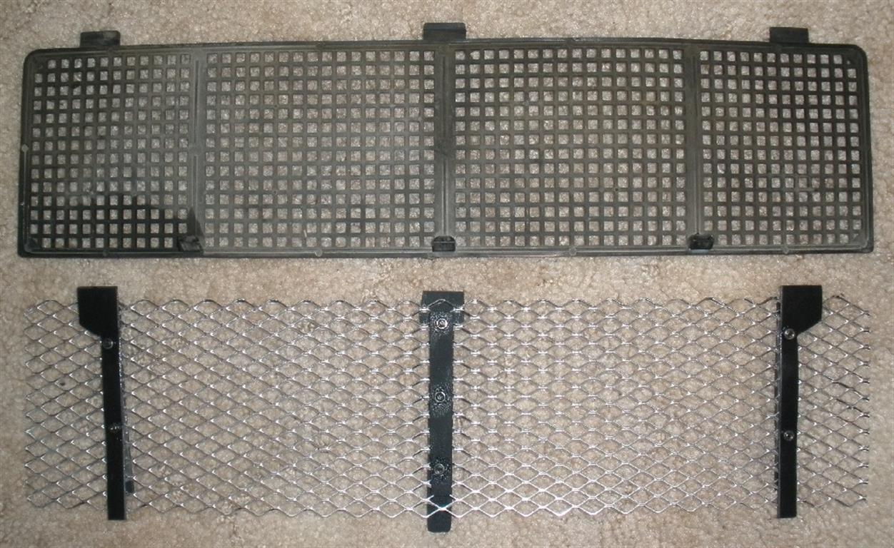

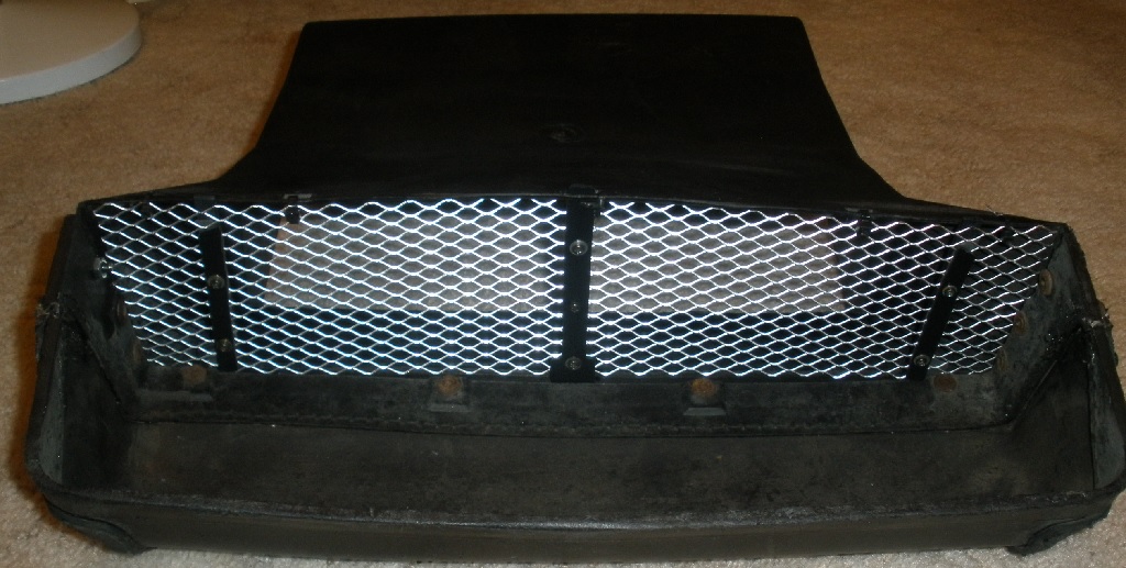

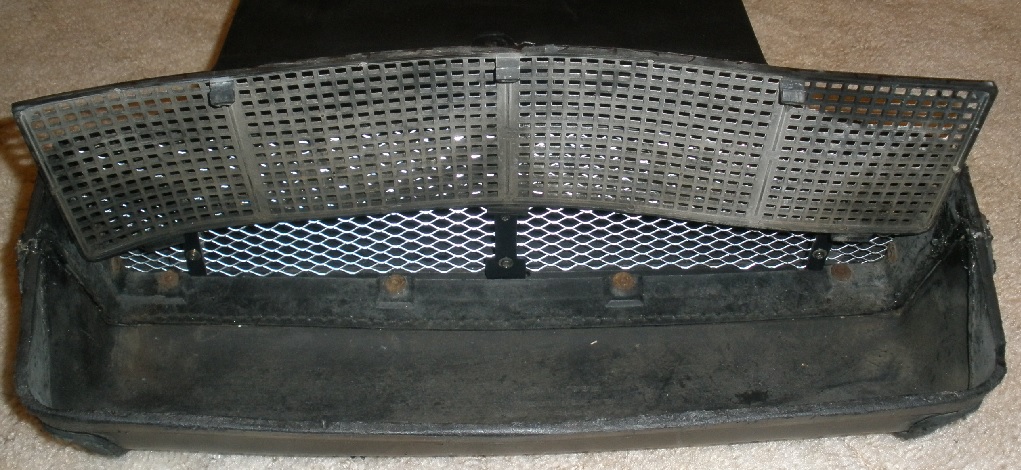

I fabricated a significantly less restrictive intake grille to replace the quite restrictive plastic grille, which looked like it might only allow 50% airflow. The steel mesh I used looks more like 75%. I also widened that bottom plastic fairing to remove the obstruction shown in previous pics, and reinstalled everything the last few days. That, plus cleaning out 28 years' worth of bugsh!t clogging the intercooler rad should help wake her up!
Comparison of the 2 grilles at relatively the same angle as intake air would go:
With widened fairing reinstalled; I'm liking how this looks much better than the way it was originally:
