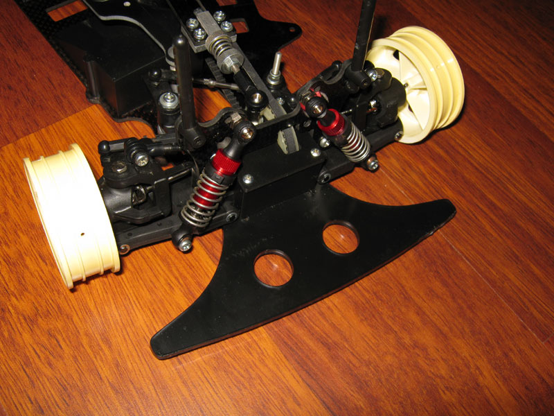

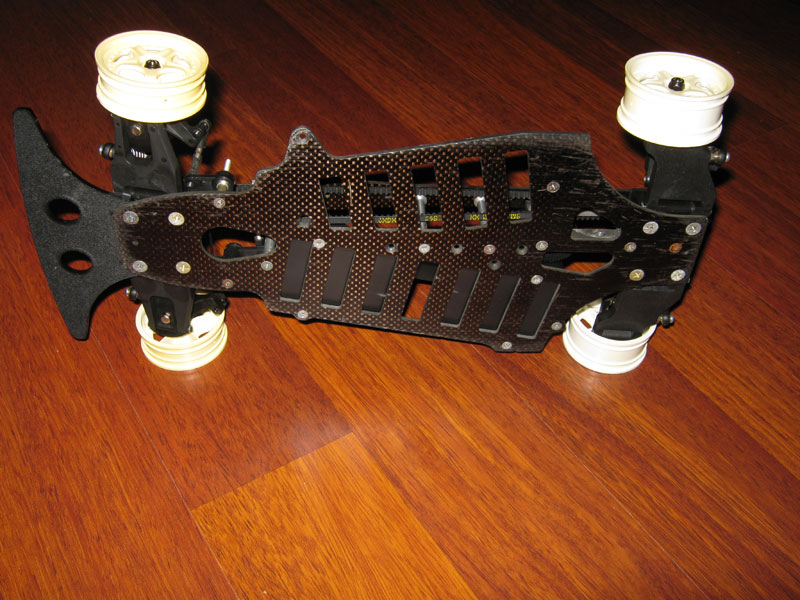

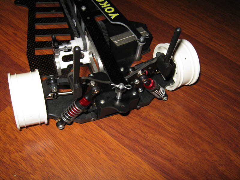

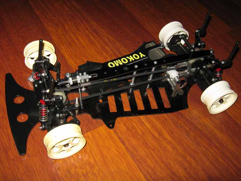

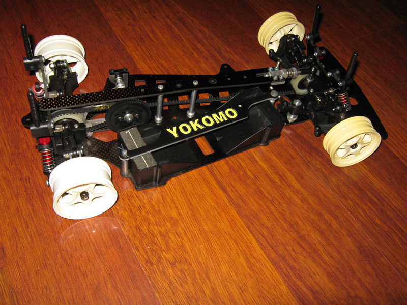

This was built out of one YR-4 2 standard, 2 YR-4 2 Special wreckers, and some parts from a YR-4"M" junker.
Some build notes:

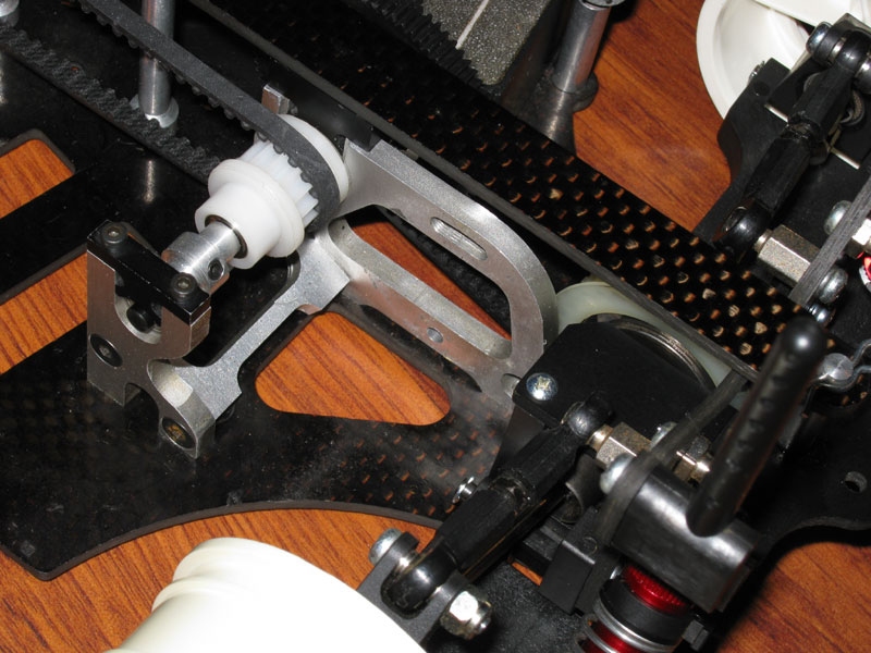

- Tracking down the special front belt for the YR-4 2 Special, which is shorter than that of the standard YR-4 2, was a pain in the ass. What is more annoying is that once installed I discovered the (NIP) belt slacks and skips even with the chassis adjusted for maximum belt tension :? , so I'll have to add a separate belt tensioner.
- Another problem was the choice of layshaft: The original standard layshaft from the YR-4 2 standard with locked spur size was discarded due to a chewed up spur. Both of the alloy Yokomo versions with center oneway I had were made out of supersoft aluminium :roll: (dear Yokomo, is it that hard to use good quality materials?) and had mostly chewed up pulleys. I had one decent rear pulley, so I rumaged in my parts boxes to see what I had for the YR-4. Found one delrin center oneway made by Alex Racing. So by combining parts I managed to build one good layshaft. Still, this chassis will get a slow brushed motor to keep the alloy pulley wear in check.
- Motor mount: one of the wreckers included the very nice alloy Yokomo hop-up.
- Hinge pins: Blackened steel ones were included with the YR-4 2 standard, while the Special junkers had regular steel ones - which had rusted (another WTF choice by Yokomo :roll: ). Guess which ones I used?
- Stainless steel hard universals on all four corners.
- Ball diffs are not super-smooth, but good enough. That little spring washer makes setting the diffs very hard. Not my favorite diff design.
- Battery hold-down and gearbox tops are wrong for the YR-4 2 Special: FRP instead of graphite.
- The bumper is an optional part that was included with the YR-4 2 standard.
- Tech Racing front camber link set. Other turnbuckles pulled off donor cars.
- Those little red shocks...I wonder if they actually do much absorbing?
- Avid bearings all round.
- Alloy steering shafts + ball bearings
- I have the correct wheels for the car, but not the correct tires. I would like to find street tires.
- And I've got the so-often-lost battery foam :lol:
Electronics have been sourced and will be simple: Sanwa 27MHz AM RX, Sanwa BL-Fighter ESC, Sanwa standard servo, 15 turns machine-wound modified motor

I dig that Alex racing one way! Yokomo did make all of the versions of the one way in 3mm and 2mm in a hardened version that did not wear out like the grey ones- :wink:

Most wearing part at that car was the rear diff outdrives. That white pulley/oneway at the layshaft is Alex Racing?

Those little red thingies that have a couple of drops of oil in them do little damping indeed, unless you have some crazy stiff oil in and are able to fill them right and keep refilling them all the time. On my YRF2SP, if I drop the front end by more than 2cm, the chassis hits the ground, bad :lol: what on earth was Masaaki thiking? Still, Masami won a crapload of races with them, so they must be working... somehow :?:
Wack the split washer off those diffs and get some belleville ones instead... makes your life MUCH easier, otherwise it's just so hard to get any diff right, as the tuning window is about 1/256th of a turn. This is poor design indeed. Maybe some other brand's diff spring might actually fit...
