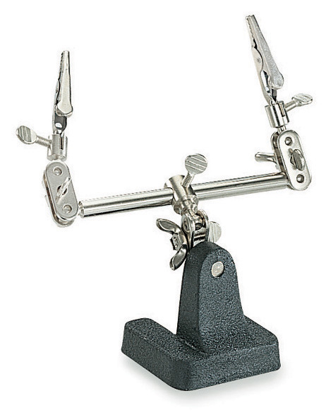

I use a soldering aid, some people call them "helping hands" works great no matter what your soldering :mrgreen:
You can get them at Radio Shack and/or just about anywhere.

I have those, but they never seem to have either firm enough grip or enough weight to prevent the arms from moving even with relatively little pushing. Also, with the cheaper ones (at least the one I have), the ball-joints where the alligator clips articulate wear out and loosen, and cannot be tightened.
But that's just me griping. If I had a choice between connectors requiring such a tool or some that don't, I'd go with the latter. Makes life simpler. :)

Yup I have a set of the helping hands also but the few times i have used them they did move around a lot so i just went back to a pair of needle nose vise grips set to lightly hold the part and if it moves I just put them in my vise. I dont know it works for me and remember if all else fails use a BFH :)
