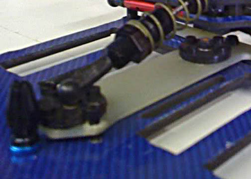

Here she is in all her glory. LOL

I should have assumed that it was the oval car
That's still a good car on the track, Lmk where you
Are racing it and I can get you a baseline set up for it. Not going to be as quick in the corners as a pivot ball
Car, but should still be fun!

The chassis is more than capable. ITs a great car, and regret selling mine ever since. You can put a new front end on it, as this is not an Ideal 1/12 starter car by no stretch it is very finicky if anything is "off" (the OEM Front End). The car was the first to offer a lowered motor mount position. Also the Deltas are great shocks as well. You may want to look for some CRC Shocks, or Associated VCS ones if the Deltas are giving you a hard time.
Your best bet is to disassemble the car and check all parts for tweak as separate items, this way you can eliminate any possible sources of tweak.
How does the car look now? I only ask as from this picture I do not see the set screws in the T-bar, and that itself can cause some handling woes.

^ Agreed, you're missing the "tweek" screws in the t-bar. Older cars with no rear side shocks used these instead.

I have rear side shocks on the car, the deltas I referred to. The car is so close to being very good. My side shocks are beat and I am looking for new ones on a tight budget. I built this car mostly to help keep car counts up and the class running. I also need to swap my t-plate as this one is extremely stiff for our track.

Yeah try the CRCs or windtunnel (like the VCS) shocks they will offer a world of difference if the deltas are shot. What about switching to dampner tubes, and run the set screws in the T-bar? That may end up being cheaper?SoloGraphix wrote:I have rear side shocks on the car, the deltas I referred to. The car is so close to being very good. My side shocks are beat and I am looking for new ones on a tight budget. I built this car mostly to help keep car counts up and the class running. I also need to swap my t-plate as this one is extremely stiff for our track.
