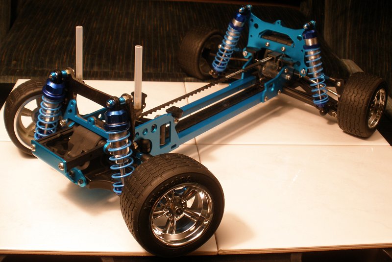

These ones, which you already know about from that other topic in the Kyosho forum. You won't find better shocks for the price.
http://www.ebay.ca/itm/3racing-Aluminum-F-R-Damper-Kyosho-Lazer-ZX-05-ZX5-RC-EP-Buggy-Truck-01-/380411598375?pt=Radio_Control_Vehicles&hash=item58924c5627
Topic: http://www.rc10talk.com/viewtopic.php?f=30&t=25647
On an Optima chassis:

Once you receive them, there are a number of things you can do to extend or shorten them to make them fit various cars, all are quite simple mods like adding spacers inside to reduce the piston travel or installing shorter or longer ball ends/cups. If you buy a set and need help with final lengths, let me know, I'll be glad to help.
EDIT: P.S. The fronts look so big on the front of that Optima because I'm using very short on-road control arms there. With short ball ends and maybe 5mm of plastic spacers inside the pistons, they should fit just like short Kyosho Golds, more or less.
