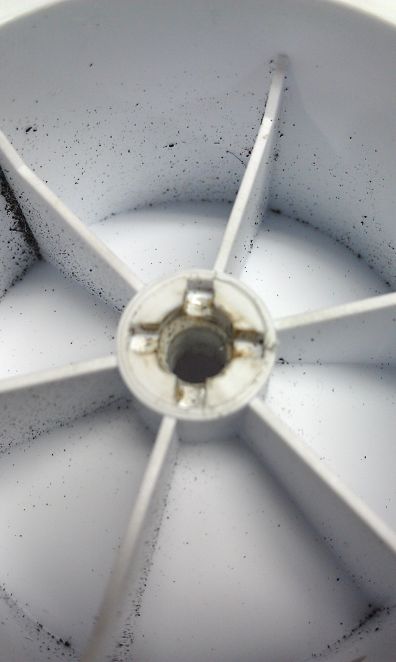

What i did to run modern wheels was:
Thunder Tiger Part PD8982 rear wheels
I used a #4 countersink on them as the 1/4" axles are tapered.
Put a small piece of heat shrink on the axle.
Install your wheel and you are ready to go.
This is for the buggy rear wheels, the truck conversion i am not sure about.
