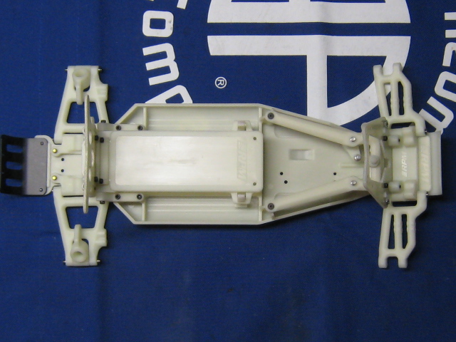

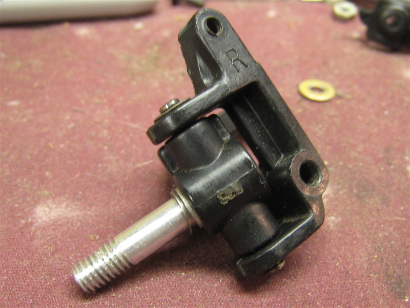

do you ever feel like cutting up perfectly good parts just for the hell of it? i do, and today was one of those days. :mrgreen:

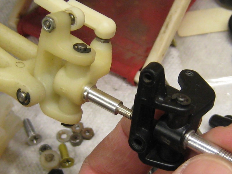

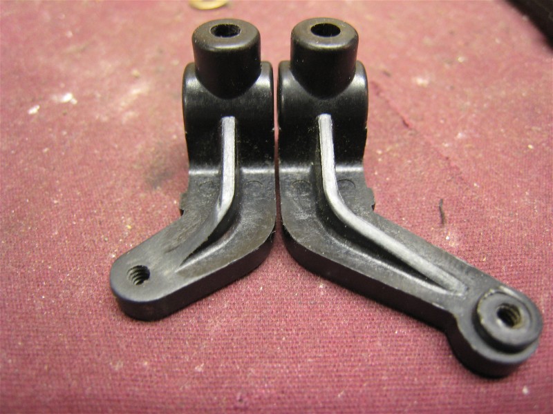

so i'm looking through my little part drawers and stumbled upon my used losi a-1017 lxt/nxt steering knuckle setup. they've been in there for quite a few years after ditching them in favor of something else on a build i was doing. so anyways, here's what i'm talking about....

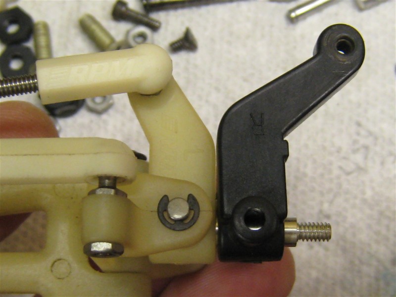

take notice that the castor block is the same as the ones used for the rpm steering enhancement kits for the rc10 buggy and truck.

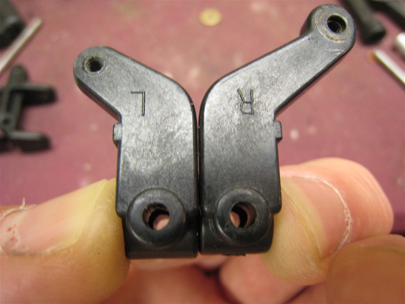

but, the arm is quite diffferent than the buggy (similar to the rpm truck knuckle iirc).
so, i marked the new location, and started drilling, cutting, and grinding.
and ended up with the poor man's steering enhancement kit. :)

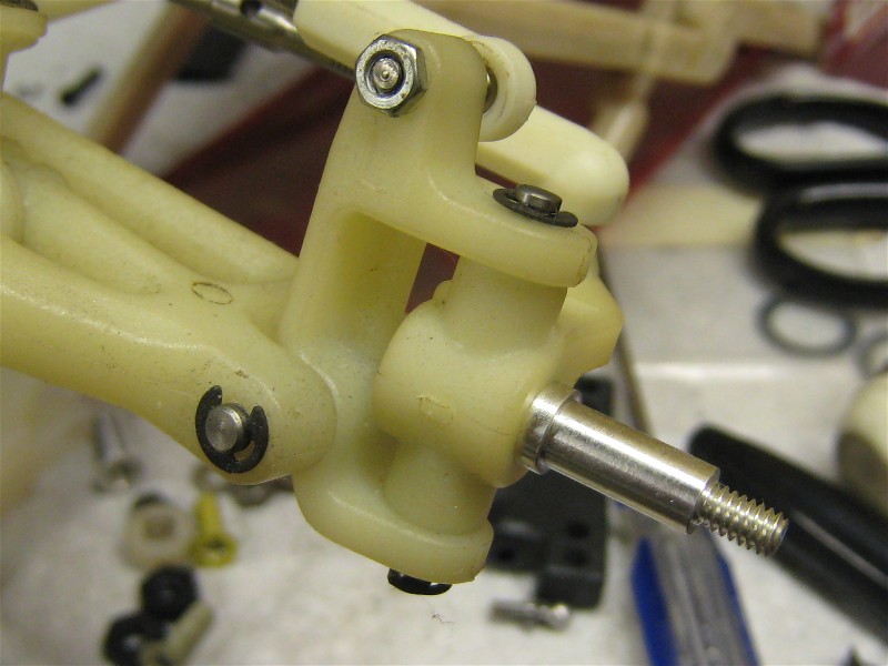

Do the AE inline axles fit the Losi hubs? Or were the RPM axles something different?
Posts: 16808
Re: "The Poor Man's" RPM Steering Enhancement Kit (buggy)
the losi axles are slightly larger, so ae axles wiggle a little bit in the losi knuckles. the rpm knuckles use the ae aluminum axles.
cautrell05
Posts: 209
Joined: Tue Feb 15, 2011 1:51 pm
Location: Norfolk Nebraska
Post by cautrell05 »
A little scotch tape can help with the fit in the steering arm. I did that on the WTF buggy. Associated axles in losi SCT steering arms.
