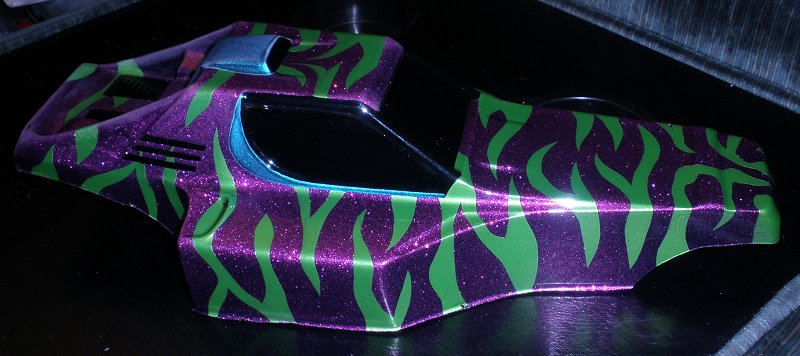

I used painter's tape. First, made a flat piece of cardboard that I coated with packing tape for a palette. Then I would take the painter's tape and stick it to my palette. Next I would slice one edge-very sharp hobby knife-off the tape making it like pin striping...maybe not was wide. Then peel the thin strip from the palette and use the straight edge applying it to the inside of the body. This is how I satisfied my own personal standard.
I still did get some bleed through, especially when I thinned the paint out. Once I go the tape applied I rubbed it with light pressure to get it to stick.
Here is what I got with minimal effort-the line looks a little crooked, but it is actually the shape of the body:

remember 3 to 4 coats let dry betweenMad Racer wrote:Thanks for all the tips guys & Farmer.
Whith those tips Farmer I have done some of them myself. I do use a sharpie and the first coat is very light as you said. I have used the Tamiya tape & is great stuff as Marc said but the little fibers in the tape can be a nightmere. So my next stop will be liquid mask. Any brand works?
I was going to buy a curve Xacto blade but you say not?
Cheers
Mark
