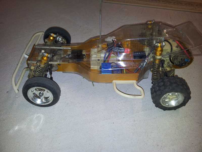

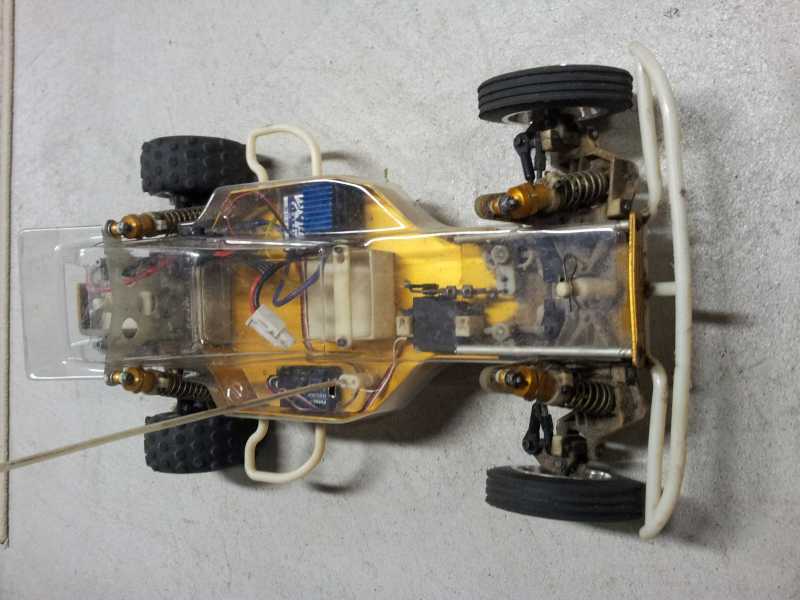

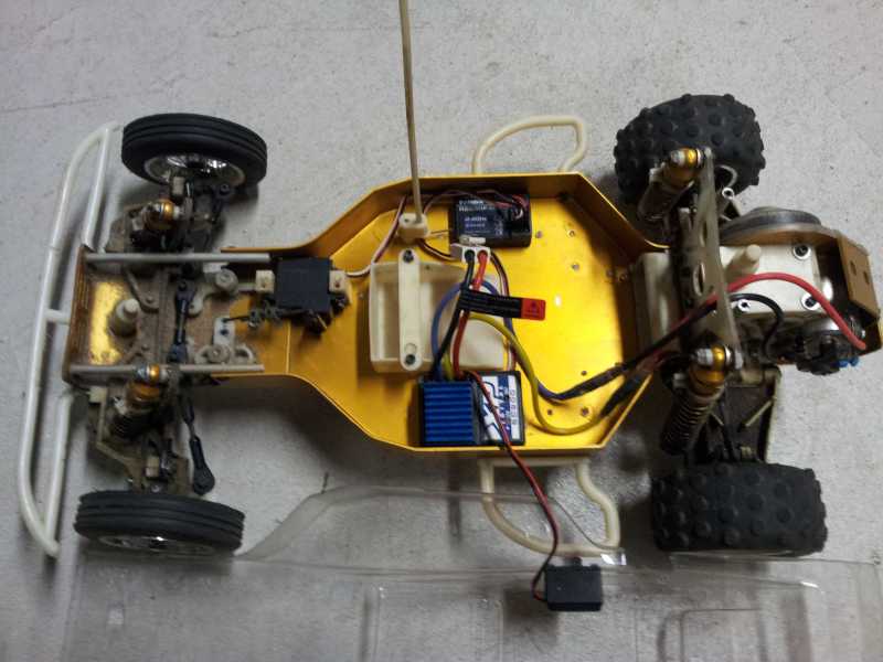

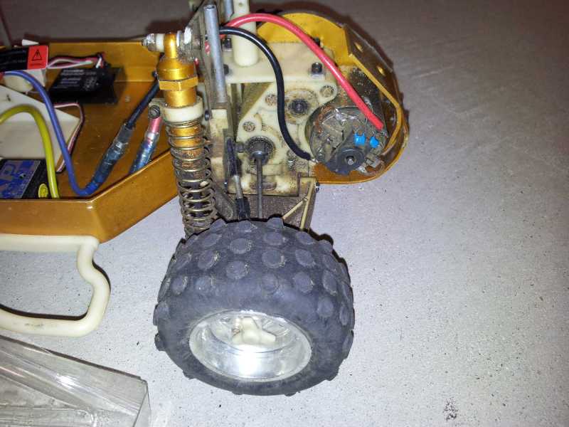

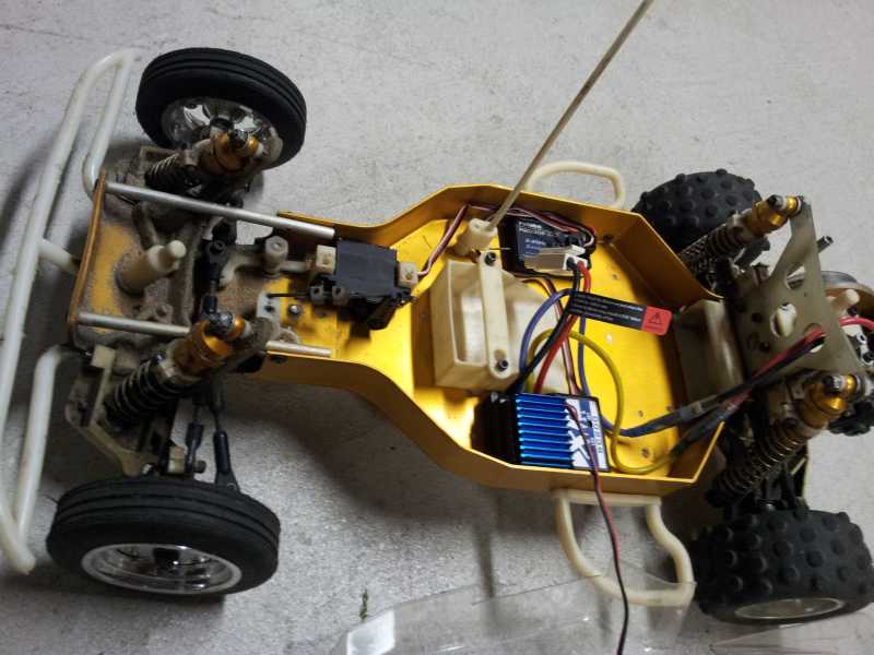

Thanks for the quick feedback Phin! You are correct, I'm not interested in doing a lot of custom modifications to the car. I've also posted a few pics of it here per your request. I have installed an SC200 ESC and a new metal gear servo for steering, but other than that it's still stock.
I took a look at eBay and wasn't really able to find any older stealth transmissions. The original 6-gear never did work great, so I was thinking of upgrading at the same time I do the motor. I still have the original motor and it runs well. It doesn't have the top end speed that the new cars (brushed) have, but it's still a blast to drive. My other option was to get a new car for playing and just keep the RC10 for nostalgia purposes.

Other than a bonk in the nose that looks like it's in pretty good shape. How scratched up is the bottom?
If the bottom is in good shape, and the arms aren't road-rashed to hell it'd be worth cleaning up and finding something else to race. If it's beat up underneath then you wouldn't be crucified for drilling it for a stealth.

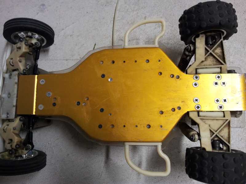

Here's a pic of the bottom. It's a bit dirty, but in pretty good shape for its age. So now I'm not sure what to do with this! I think I will upgrade the motor to the Reedy Radon 17T and leave the diff in its original condition. I'll most likely buy another car for racing and use this one for show. They don't make 'em like this anymore!

Yeah that's a nice one to just clean up. Maybe just get some new rubber for the wheels. You can even leave that Chenowth body clear if you don't have any artistic ability.
