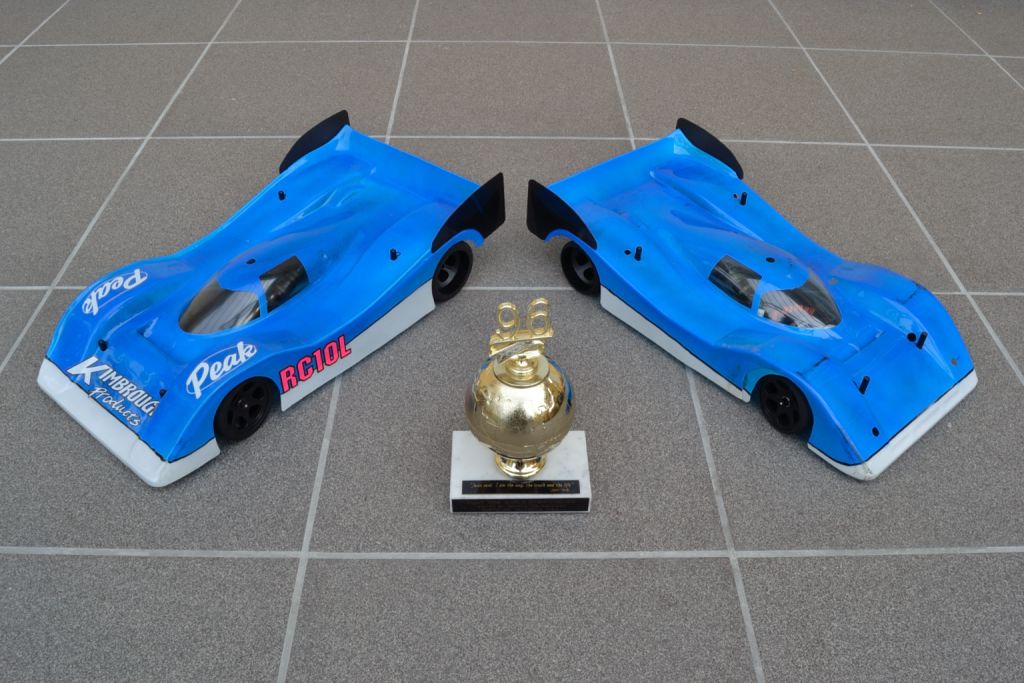

I got these two RC10LC's into my possession. Both were driven in IFMAR 1996 On-Road Worlds (Revelation Raceway).
I've been trying to gather up information about these quite rare cars.
Please let me know if some of my datas ain't right.
RC10LC was some kind of Limited Edition or Prototype for the 1996 On-Road World Championships.
It was a complete kit packed in RC10LS box and did not include any manual.
It was never released to actual production.
Associated had two different bodies for it.
On the right: Nissan 96 GTP #6139 (Yes, I know, the T3 Ford Truck body has the same number!)
On the left: Nissan GTP #????
I have one uncut clear #6139 body. That's why I'm sure about the type and code. The unknown body on the left is my only one.
Front end is lower and it has lifted side edges. More downforce I assume.

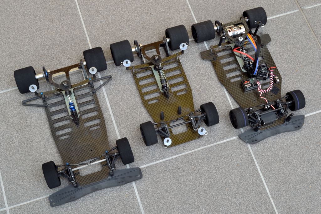

Here you can see the size of the RC10LC (210mm wide). It really is short. Reference on the left is RC10L2 (235mm wide). On the right is RC10LSO (200mm wide).

This is what I have so far found out:
RC10LC has clearly unique chassis plate. Rear chassis brace seems to be also one of its kind. It is really close to 10L2 rear chassis brace #8207 but the stanoff holes do not match.
Rear pod upper and lower plates are special versions. Bulkheads are standard #4536 and #4537. T-bar is standard 10L2 #8191.
Front suspension attachment holes match with Super Speedway cars 10LSS and 10LSO. Rear track width is 210mm. It uses long rear axle #8210 but the shorter one #4355 can be used also.

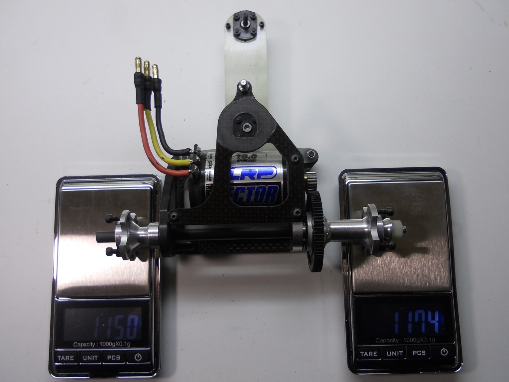

Rear pod is balanced with brushless motor! Nice!
-N-

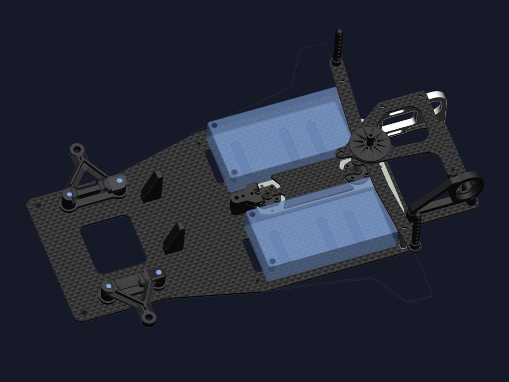

Original chassis thickness is 2mm. I'm going to drive this car mainly indoors so a small increase will probably be a good thing. Will start with 2.4-2.6mm.
Short wheelbase brings more stiffness also.
So this is going to be my prototype of a prototype...
While making the 3d-model I named the assembly NIX10LC. Yes, that's a good name. I just leave it there.
-N-

yeah i have one of those driven by Petri kyrölainen not sure about the spelling but i bought it from him back in the day tried to order part for it once but they had never heard of it.
i also have un cut body for it I talked to protoform they made the body for it bitd but they have destroyed the mold some year ago.
mvh Isobarik

Niki wrote:Rear pod is balanced with brushless motor! Nice!
-N-
Reduce the right rear hub to two screws and it would likely balance out perfect :wink:
