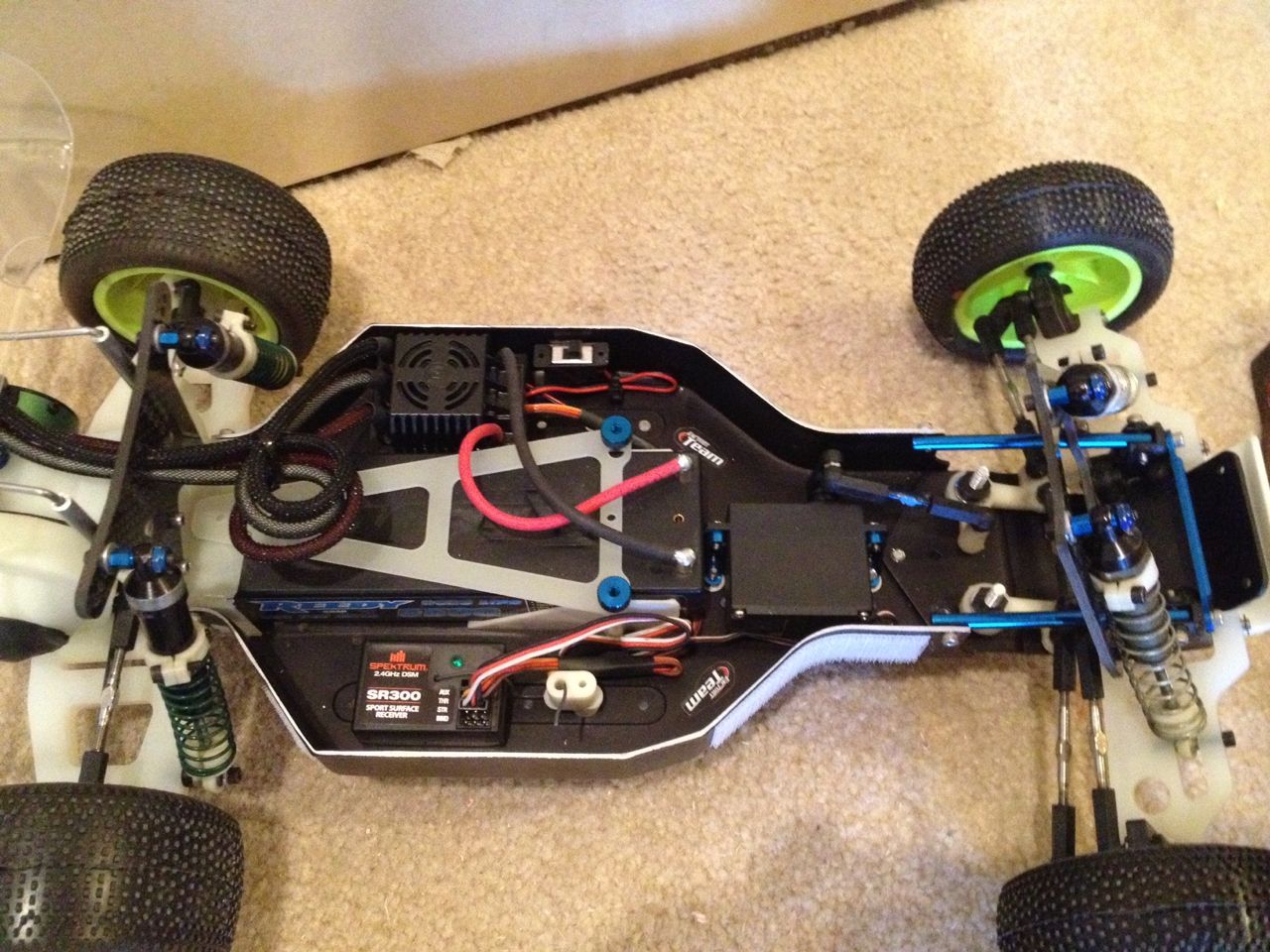

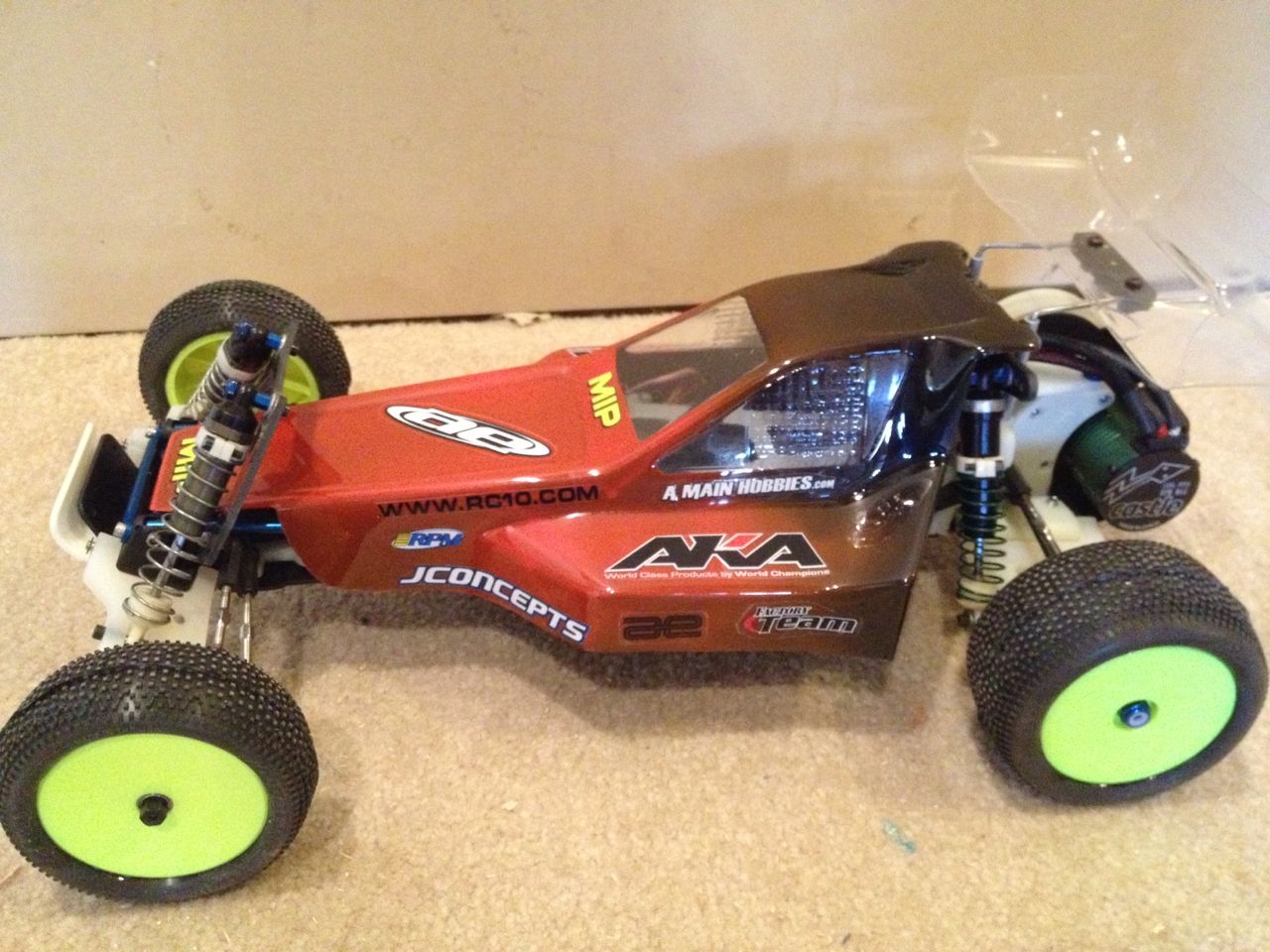

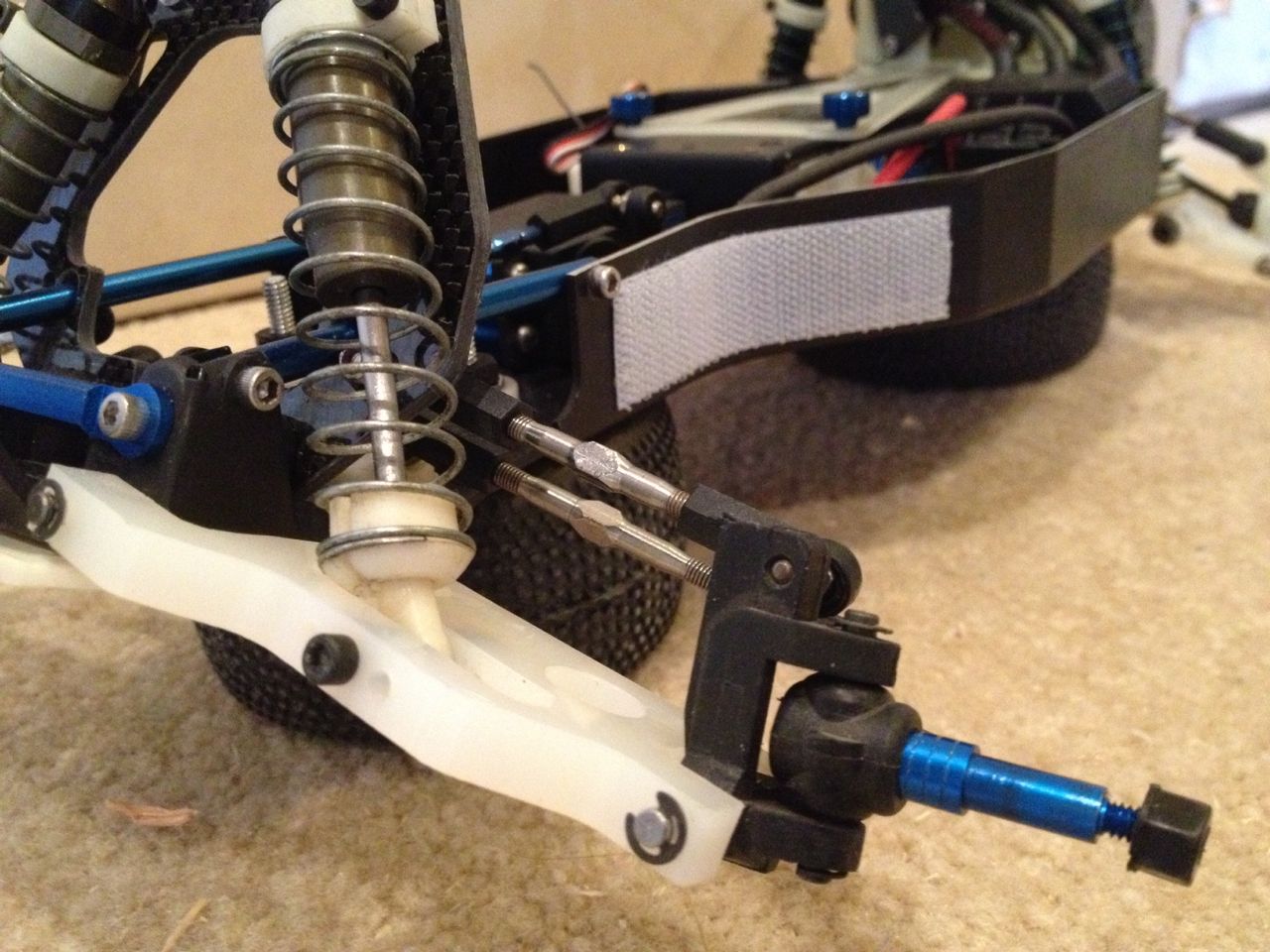

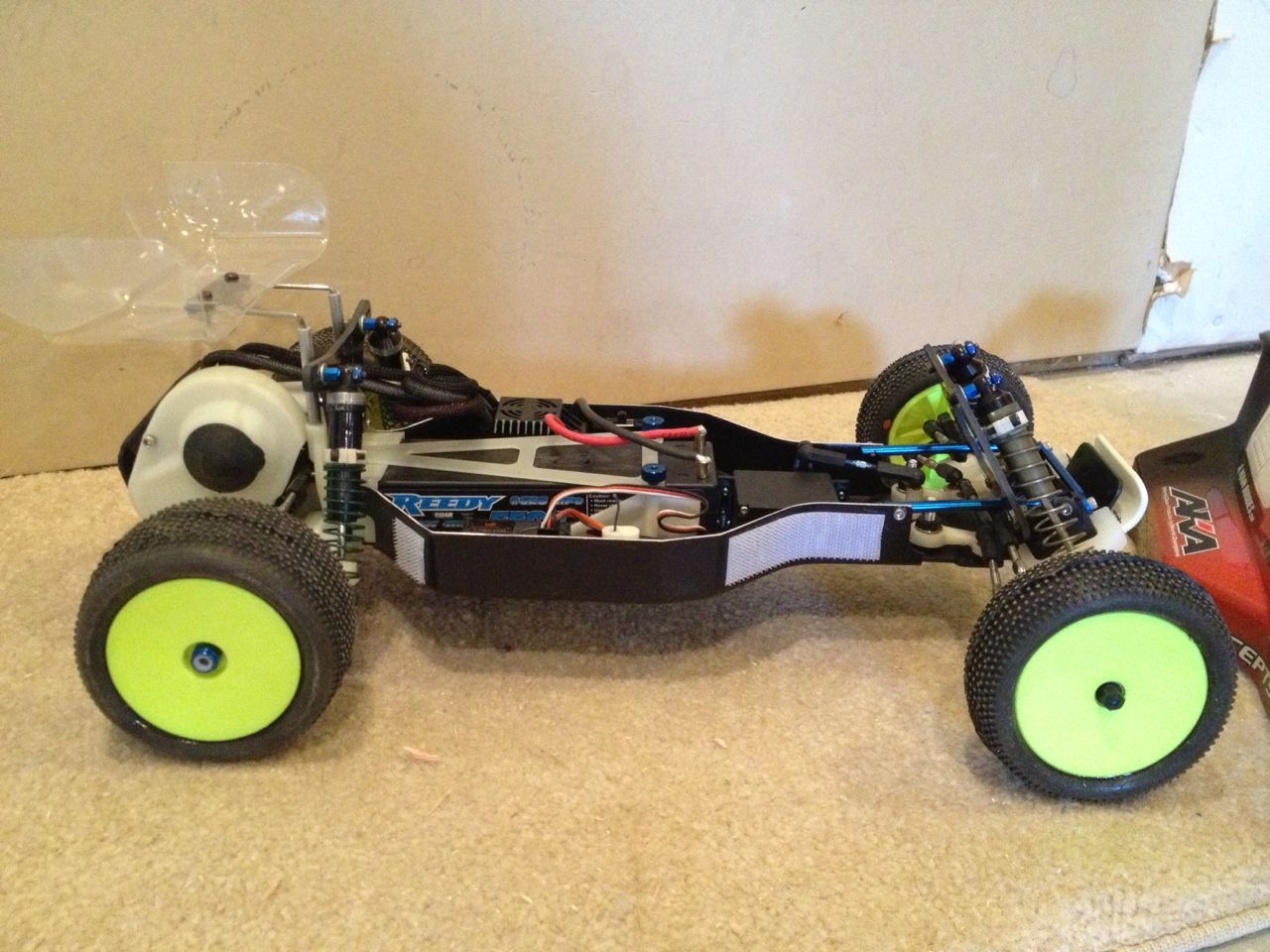

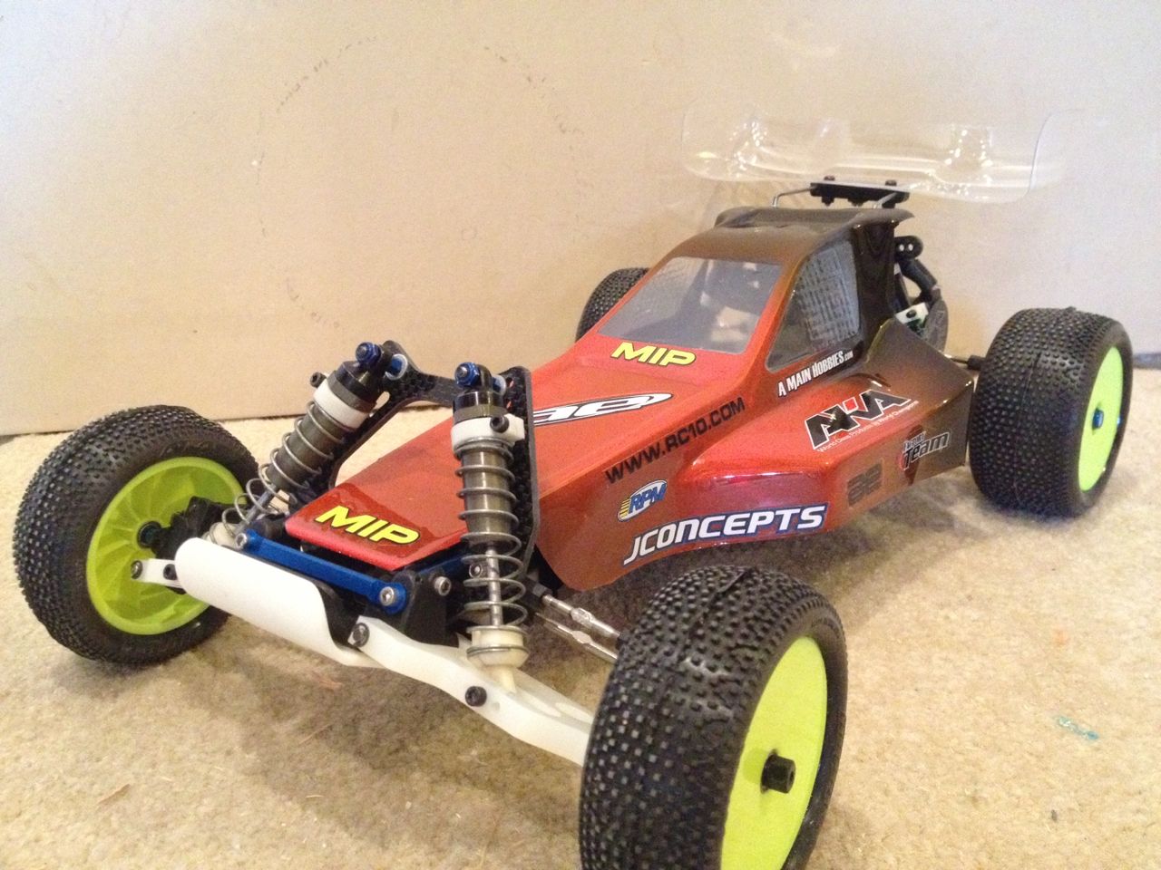

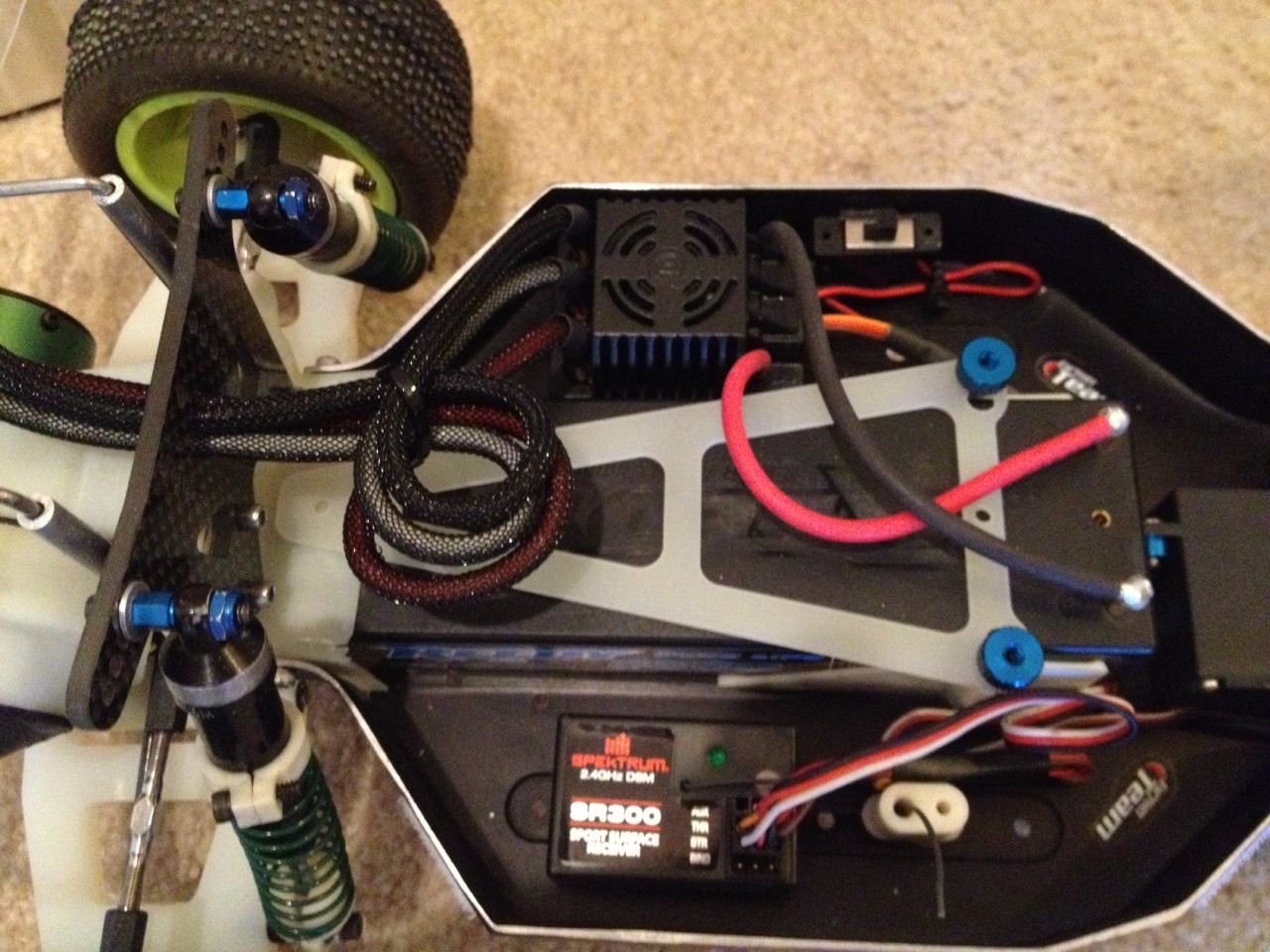

So, here is my latest update. I will let the pictures do the talking first.
I think that it is coming along just fine. What I have done at this time were:
RC Carbon Works Rear Shock Tower
B4 spacer and additional spacer on rear axle
Front GT Bulkhead
Front GT Nose Tubes
Front Caster block 30 deg
Moved steering assembly to forward holes
Added electronics (servo is just temporary)
Still to come: B4 Threaded shocks
Enjoy!
