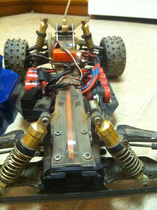

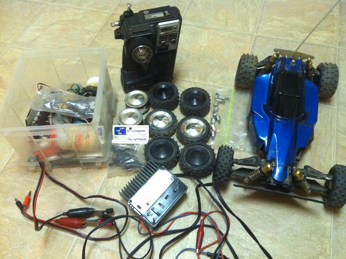

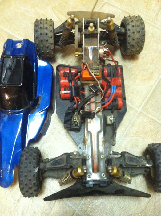

hey guys this is a a car i picked up a few months ago and im getting ready to do a semi rebuild
just basically a good clean up and tighten
from what ive gathered its a procat se due to the dark chassis
please correct me if im wrong
i know this is a kyosho body but that is what it came with
ill get a repro
couple of questions
1. what and why is the crash back system that i have read about
2. im needing some front drive shafts do all the models of the 4wds run the same
can there be others used?
3. wing stays and the correct #for the wing that should be with this car
thx guys for your time this is my first schuey,,, but im really looking at the new 2wd schuey for my modern buggy running
any help would be great
thx farmer

If you cut the zip tie at the front end of the car and install a couple large orings in the same fashion as the zip tie you will see the crash back system. It just allows the front end to fold back if there is an impact.

That looks like it's a CAT XLS rather than a Procat. It has some nice bits on it too
the layshaft looks like MMS/Trinity. I'm can't remember who made the chassis, but it's not a Schumacher item.

Farmer it looks like an XLS Cat. The chassis is definately an after market Procat item (unless the white fibreglass sheet has been dyed or painted black.
To build this car into a Procat SE you'll need a lot of other items if you are to do a descent job of it. However, if you would consider an XLS to be on your want list (and lets face it who wouldn't
) all you'll need is the correct lower chassis plate and a repro CAT bodyset.
In my opinion the XLS is more sought after now days than the Procat. At the very least they fetch higher prices (for your interest).

It´s exactly like this.gomachv wrote:If you cut the zip tie at the front end of the car and install a couple large orings in the same fashion as the zip tie you will see the crash back system. It just allows the front end to fold back if there is an impact.
I'm not too familiar with the 4wd cats so that's about all I can help u with.
The chassis really look like aftermarket, but also like graphite not black fibreglass. Did Composite Craft make such chassis?
I also can see an orange frontbelt so should be a Wasp belt.
CAT XLS is what I did run also back in the days, maybe my most succesful 4WD car after the Kyosho Optima. Just good I got a XLS again last year.

The lower chassis is similar to Procat Schumacher no. U288W but not a complete match.
CAT SWB, XL, XLS, Procat and Bosscat, TopCat, Club10, Nitro10, Cougar mkI /mkII uses the same type of drive shafts.
