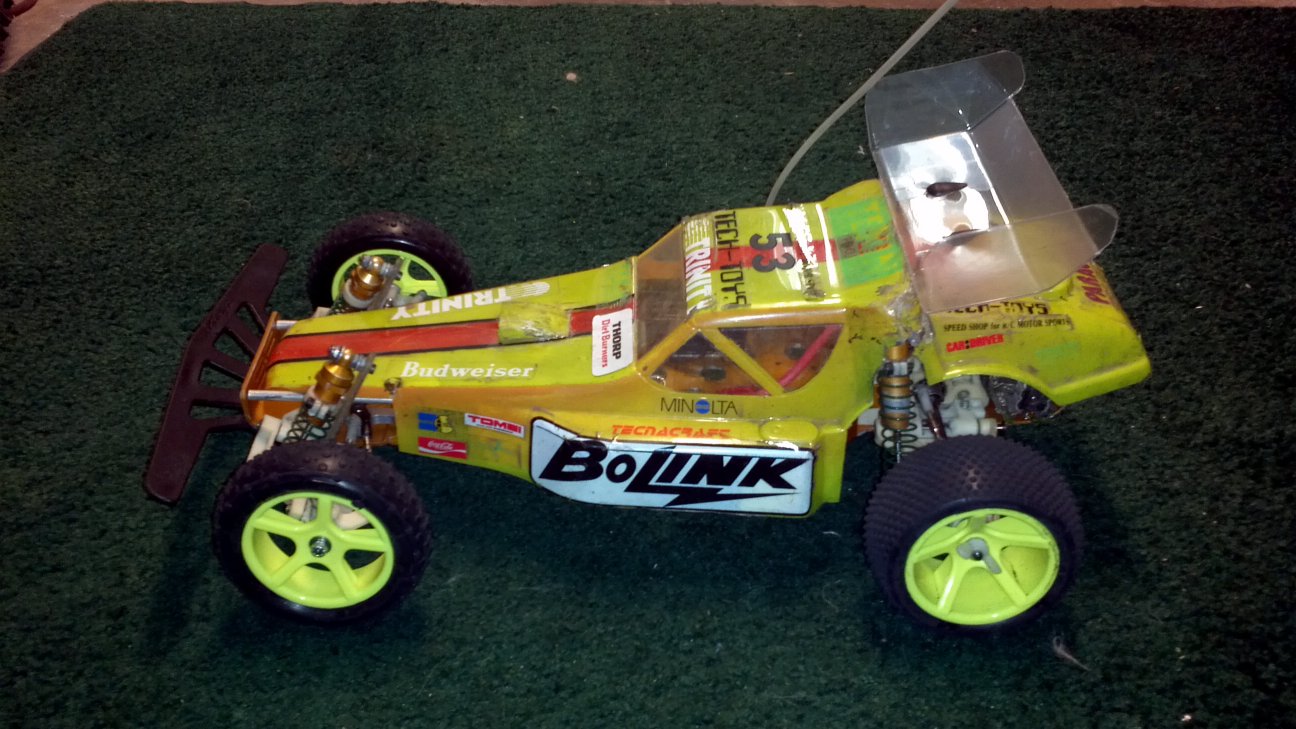

2nd vote on the JC wheels. When you order they are for the front and the back (it's not very clear).
Here is a set of the yellow on my old RC10. They also come in black.

Another vote here for JC Racing Wheels. I've gone through 3 sets already and they are excellent quality and a direct fit.

I ended up ordering the JC Racing wheels. For just under $20 it was cost effective and easy.
