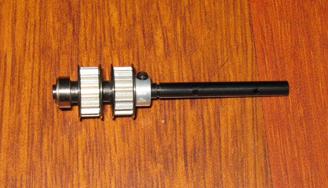

So for the layshaft/slipper I've decided to just try something:
3Racing makes several pulleys for drift cars, including a 14T oneway that fits a 4mm shaft. Although I'm not entirely sure, I suspect it will fit the front belt on a Lazer just fine.
For the layshaft, I'm going to try a HPI Sprint 2 layshaft, which seems to be the right length and have the pin hole for the rearwards pulley in the right place, together with a 15T HPI Sprint 2 pulley (hopefully it will fit in the gearbox).

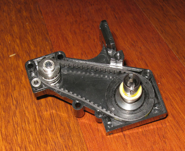

So some preliminary fitting tests show that:
- The rear gearbox will take a 15T pulley :D
- ...but to fit the rear belt some material will have to be sanded off the insides of the gearbox...
- ...and the HPI pulley will need some minor modification to rotate freely (pulley flange too large).
- The HPI layshaft is the proper length, but the hole for the pin is just 2 mm or so too close to the e-clip end. Or: why couldn't Kyosho fit the layshaft bearings from the inside instead of the outside of the gearbox? :(
- However, if the pulley is installed reversed on the center pin hole, the HPI layshaft will fit. :) Some custom spacers and inventive bearing assembly (bearing in bearing :P ) are required.
- Such an assembly limits me to single-pad slippers, unless I find a safe way of extending the layshaft.
Now if that 14T one-way could show up I could make a assembly mock-up and take some pictures... :|

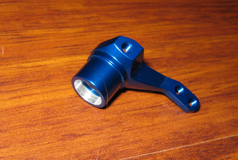

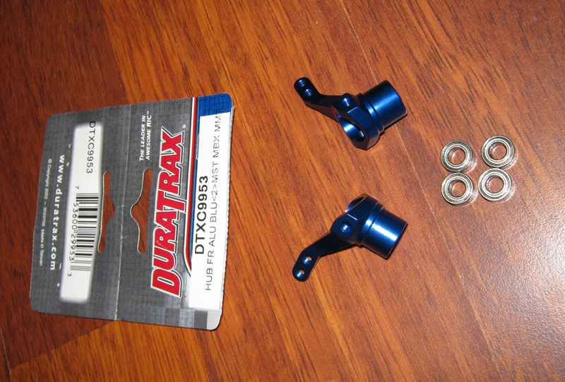

I also picked up a set of alloy Duratrax front uprights:
However, these had a problem: the hole for the outer bearing was too small, and the outer bearing would not fit in whatever I tried. So I found a tube that was just a fraction smaller than the bearing hole, wrapped it in sandpaper, and sanded out the holes until the bearings fitted:

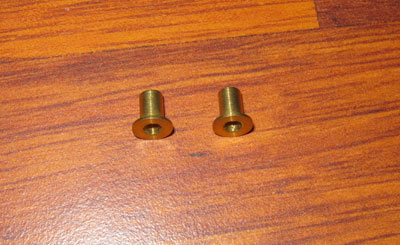

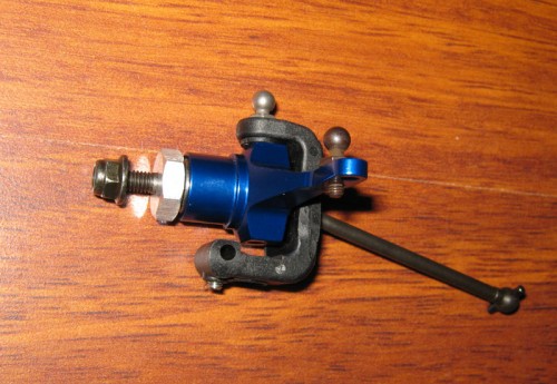

Instlling the Duratrax uprights in the Lazer ZX-5 c-hubs was too much of a challenge, as I got to this point:
...with these spacers sourced in a parts box for the lower kingpins, and in need of more spacers to get everything to fit properly:
Around this time I found some cheap LA-59 c-hubs for the Lazer ZX. Too bad about the ZX-5 parts, but it's too much work to make them fit properly.

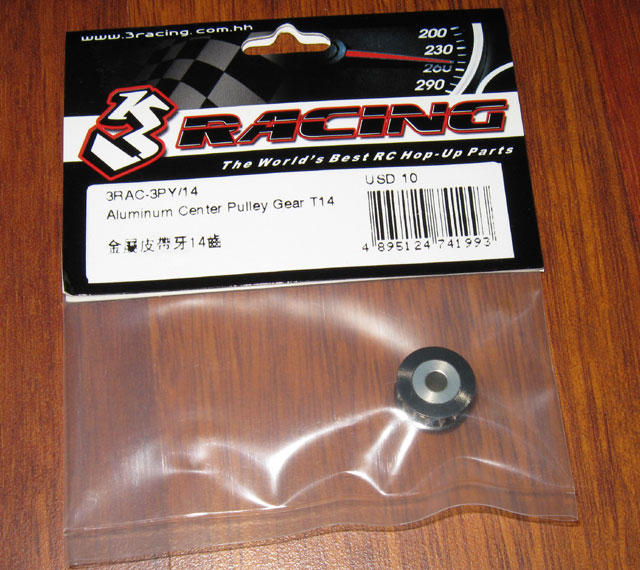

After getting really fed up with trying to make the 15 tooth HPI pulley fit the rear gear box (it doesn't work, the belt's way too tight), I gave up. Untill I recently noticed that 3Racing was planning to release a 14 tooth pulley. When the pulley came available I searched high and low for a reputable place selling it and couldn't find one. :cry:
But 3Racing...accept direct ordering! :mrgreen:
So a 3Racing 14 tooth alloy pulley was ordered, and took about a week to arrive:
I test-fitted the pulley, and it fits perfectly when combined with my homemade spacers.
I filed a small flat spot on my HPI layshaft, and then loctited the pulley's grub screw in place, giving me a functional layshaft:
And look, it fits perfectly into the gearbox:
:mrgreen: :mrgreen: :mrgreen:
