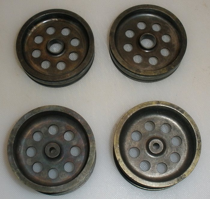

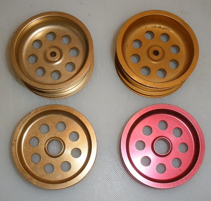

I bought 4 Duratrax wheels from DHood recently. I've always found the anodizing on Duratrax wheels to be dull and lifeless, because it was probably anodized on a matte, dull surface finish. Also, these wheels from DHood were in 2 different shades of gold and red, so the idea was to deanodize and polish them up and at least end up with a matching set.
Before:
After deanodizing with Easy-Off heavy duty oven cleaner; the one with the yellow cap:

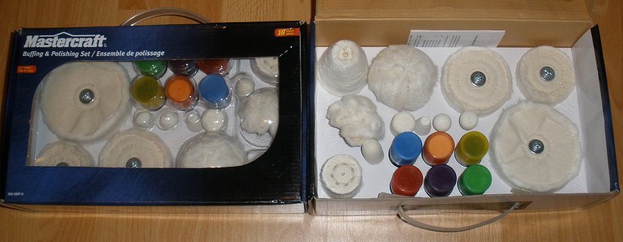

I started using the little Dremel polishing disks that I'd used with very nice results on those Brimod shock caps & bodies, but they just weren't adequate for the task. I went to the local Canadian Tire store to look for a few polishing bits for my drill. Other than really big ones, I couldn't find much, until--lo and behold, what do I spot? Polishing kits, on clearance!
How often is it that you run out to buy something and it just happens to be on sale?? Pretty rare! And on clearance, no less...these kits were $55 each regular price, on sale for $14.99!! :shock: You probably can't even buy 3 separate polishing bits for $15 bucks. So, I bought two kits. :mrgreen: They have all the funky-shaped bits & pads I'll need to reach the nooks & crannies of any aluminum part, 6 kinds of cleaning & polishing compounds...in the summer, I might even have a go at restoring the dull, oxidized aluminum wheels on my Charger.

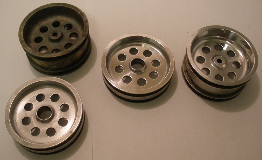

2 down, 2 to go
Post by Coelacanth »
Well, no matter what tools you use, polishing aluminum requires elbow-grease in order to get the best results. I found I got the best results first wet-sanding off the brownish-colored smut. That only takes a few minutes. Then, various polishing tools with rubbing compound to get a decent shine--but still a touch satiny. Next, the same tools with polishing compound. Lastly, I did some hand-polishing as the tools tend to leave circular "machine marks" behind. Not sure what else you call them but the result is a bit inconsistent, as no tool can really reach everywhere. The final hand-polishing with polishing compound got me a nice, consistent glossy finish.

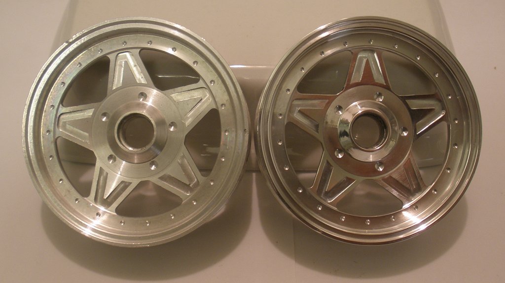

I polished up one of a pair of front JPS wheels I got from a forum member to show the before/after. The wheel on the left is brand new but has the original machined, semi-polished finish. The wheel on the right got a half-hour's elbow grease polishing it up. The difference is significant. Even with good power tools, polishing is a pain in the ass, but I commend & respect people who put in the extra effort to do it, it definitely sets the car apart.
And here are the finished Duratrax wheels...they sure look a lot nicer than how they started out! 8)
