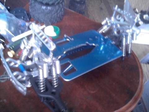

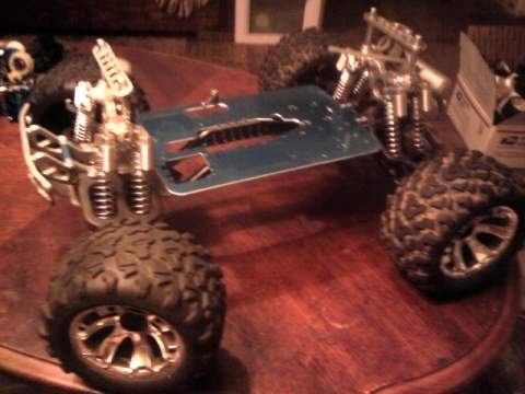

I have the extended chassis with some Geode wheels with splines for it. Even with the longer arms, it should look to scale. I have decided to go with the RPM arms all the way around, Well RPM in the front and commons in the rear. Besides, I only have a half set of the aluminum arms. I was going to put them in the back but I don't like the idea of aluminum on aluminum against the bulkheads. Besides, if the truck is all aluminum, there won't be any give when I hit stuff and the aluminum will bend. I got busy yesterday and didn't get to work on it. I just started putting the truck together this morning and here is where we are at.

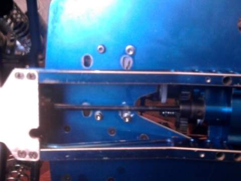

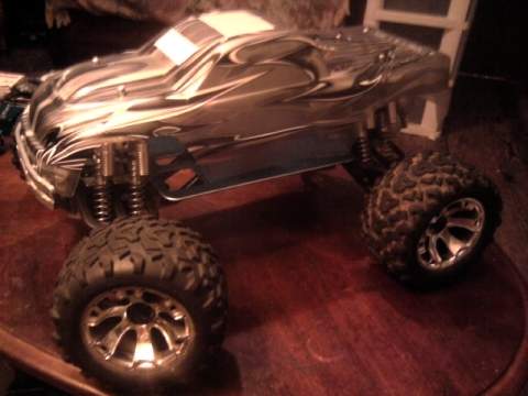

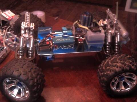

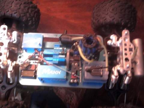

Here is how far I have gotten today.

As for our rebuild, I have the truck mostly together. Only had to take the trans apart 4 times to get it right. My black pawl kept getting stuck so it was like the truck was stuck in forward. Every time I took the trans apart, the pawl would pop back into place. After I figured out what was happening, I had to adjust it twice. I thought I had gremlins in there. I figured out the chassis is setup for at least a big block if not a 2 stroke weed wacker engine. At that point, after messing with the tranny for 6 hours, I said hell with it. I figured what spur I wanted, got the engine together and on the stock 3.3 mount, and scratched a template out on the chassis. Then I just drilled out the chassis. I just hope the ratio is right. If nothing else, I can go with a bigger spur and smaller pinion bell or the other way around. The only problem I can for see is the body. The engine hole on the body doesn't line up with the placement of the body that I have which is there version of the 3.3 extended. I am going to have to see if there is a extended chassis E-Maxx body out there. If not I'm going to have to start looking at savage flux bodies as alternative. I also have to plum the dual exhaust. I just have the old stock muffler on there so I could start the truck. I have to cut the exhaust manifold and run a longer piece of hose to the pipe.Create an account or sign in to join the discussion
