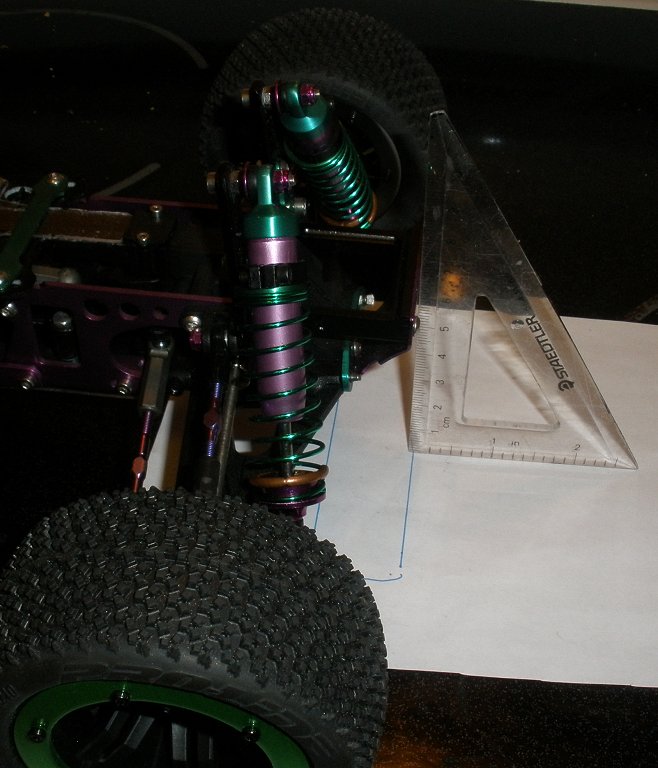

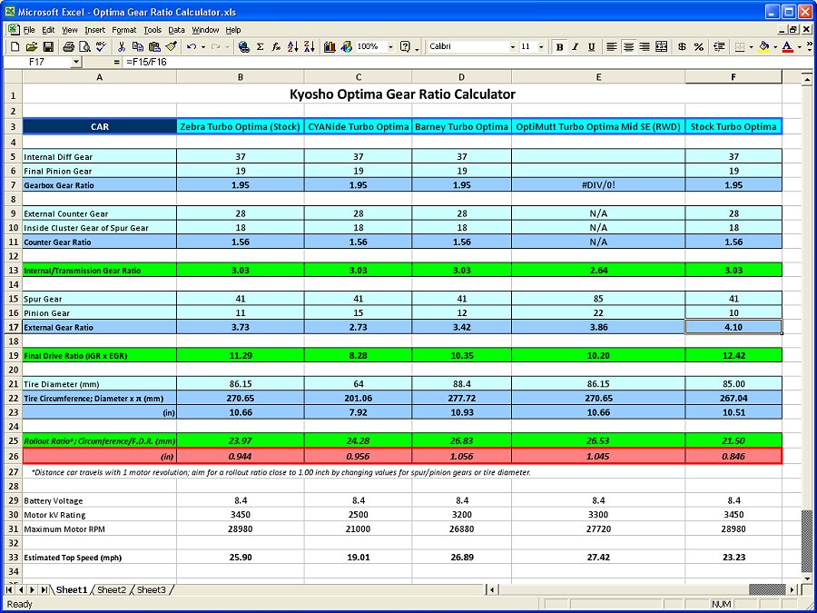

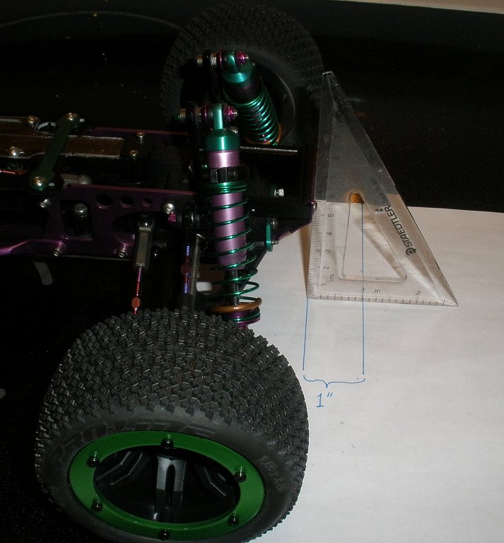

Calculating Barney's Rollout Ratio
Here's a thread revival--I already had the electrics setup for Barney other than the fine-tuning stuff like punch, but with all the changes I made to the car, it wasn't comparable to stock anymore, and I wasn't sure what pinion gear I should be using with the larger tires' diameter. I did a LOT of research into the actual math, and my gawd, there's a buttload of inaccurate, even totally wrong, info out there...and much of it was right on RCTech.net.
You wouldn't BELIEVE some of the formulas I encountered that were totally out-to-lunch!
Sure there's gear ratio calculators and such on various sites, one of those was incorrect, too. The ones that were accurate, didn't show the math...the math is crucial to understanding how gear ratios, rollout, and optimal pinion gear/spur gear sizes correlate. Using a web calculator is easy for those who don't want to waste the time to understand, but calculators of any kind just contribute to our society's attitude of lazy ignorance.
I finally dug deep enough in my research and did a WHOLE lot of trial-and-error until I could make my own spreadsheet to calculate the results *I* needed to know. And here's my rather lame method of estimating rollout. Apparently, most sources seem to agree that a rollout of 1"--i.e. your car moves forward 1", plus/minus 10% or so, for one full revolution of the motor--is what you aim for. This is supposedly the most efficient gear ratio for the motor, transmission, spur/pinion and tire diameter.
Here's a screenshot of my spreadsheet. I dialed in Barney's rollout almost perfectly with a 12T pinion, to 1.056". The spreadsheet also shows that I'll need to increase my Zebra and CYANide Optimas' pinion gears by 1T each to get a similar rollout, just a shade over 1". For OptiMutt, a 22T pinion would be optimal.
I think the spreadsheet would work for most other cars as long as you know the important variables. These days, most of those variables are published right on the 'net, but that wasn't the case for the old vintage Optima series. Please disregard the estimated top speed calculations, they're out-of-whack...I haven't sorted that out yet.
Here is how I estimated the actual physical rollout, marking a 1-inch distance on a piece of paper and using a triangle to quite accurately measure the distance Barney rolls with one motor revolution. I just rotated the pinion gear one full turn and checked the distance travelled. It was very close to 1". There's a bit of play in the drivetrain, so I tried to account for that, but at least I know it's fairly close to the math.

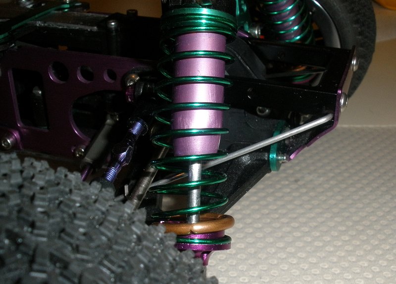

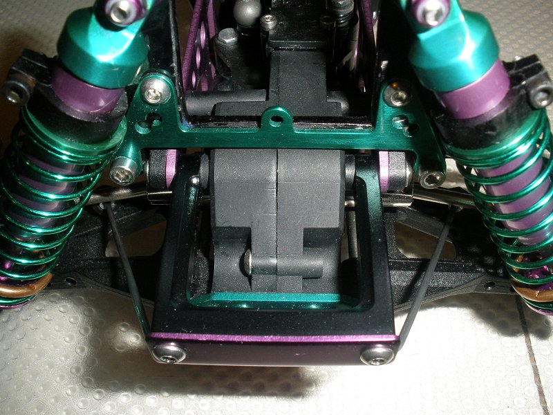

Barney gets wing mounts, front stabilizer

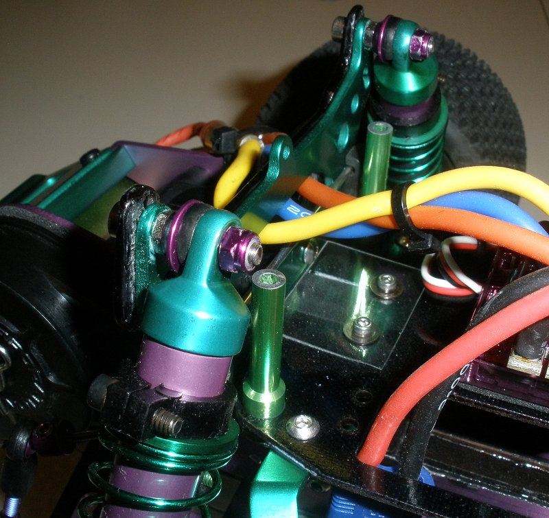

I installed a couple wing mounts from some cut-down Axial spacers, chose them mainly because they were green, had wider bases, and 3mm threaded ends.
The wing tubes were cut just below the height of the shock tower so they won't get in the way of the body, and are long enough to insert the wing wires, which will be bent a bit at the ends for a tight, secure fit.

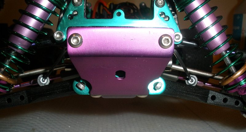

I actually didn't think I would be able to install a front stabilizer on this car because of those big front shocks & everything else barely recognizable from a stock Turbo Optima...but I was seeing how low-profile the Optima Mid's stabilizer assembly was, and since Barney uses the same Maxxum front arms as OptiMutt (which are functionally the same dimensions as regular Turbo Optima Mid arms), I had another look. There wouldn't be much room but in the end, it was possible!
I bent some 1.5mm steel piano wire to fit inside the Optima bumper brace and extending through the Mid-style stab ball-ends. It had to be a custom piece because neither an Optima nor the Mid's stabilizer wire would work. Their front ends and arms are totally different as far as stabilizer mounting locations go. Also, to keep the wire position as low as possible, as close to the arm as possible, I flipped the bumper brace upside-down and reinstalled it so the stabilizer wire groove was on the bottom instead of the top. That's a pargu2000 alloy bumper brace by the way, anodized black.
You can see that it's close, but it clears the CVD bones with a little room to spare, and doesn't come close to the CVD throughout the shock compression. Oh, I couldn't find any 4.8mm balls so I used some spare 4.8mm ball nuts, which work just as well. The stabilizer wire just has to protrude through the holes; the balls inside don't really need to move for the stab to work.
