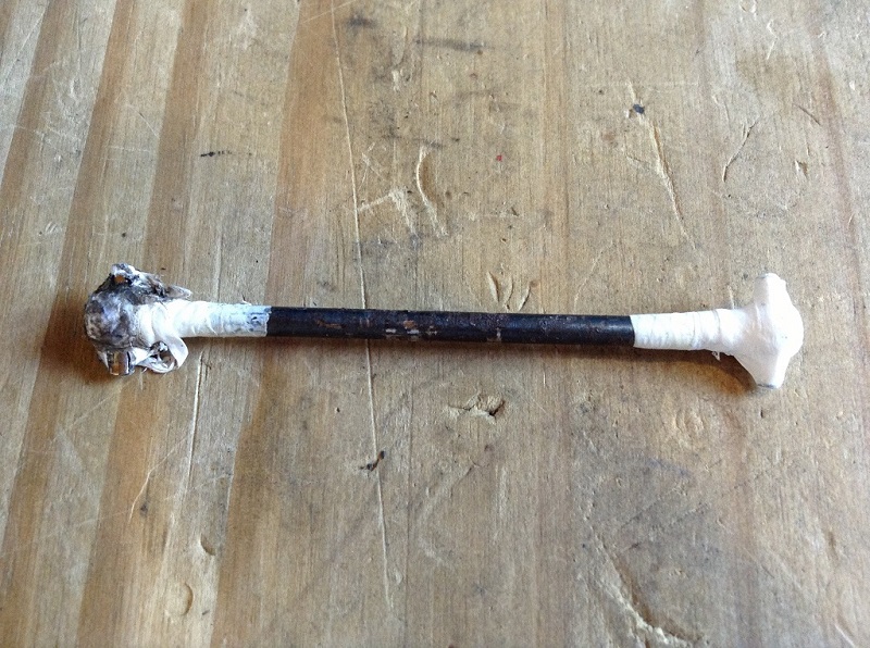

Re: Optima Mid Custom CVD conversion info needed.
This is a quick pick of the little tip mentioned above...it does help to reduce the amount of play if you're running an car with worn parts.
Mike.
Mike.

If it was either run that or not run the car--I wouldn't run the car.
