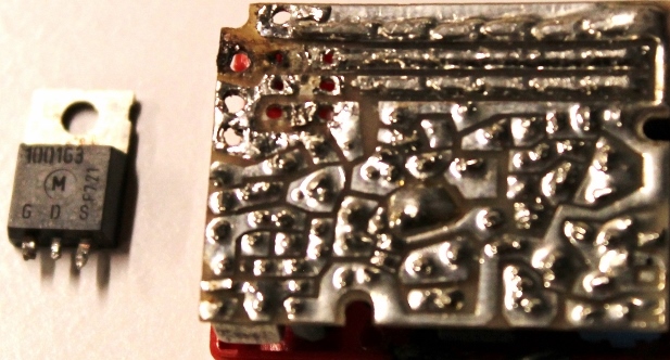

Ok, I have seen what you have done. Most of your problem is because you did not remove the solder. Before you can get the part from the board you have to get as much solder away from the board as possible. You do this with using one of the following techniques: solder wick (good), solder vacuums (better), heated solder vacuum (best) like the tool I showed you in the link in a earlier post. You will need a good quality soldering iron. Not a crappy 25w job, more like a 40w, better still a 60w. Remember that these tools are a investment and they will save you lots of money not jut in RC but other things that need repair around your house. Having goods tools will make the job easier. The trace is only held on by a bit of epoxy and if you heat it up too much it will separate. All is not lost with the board. Remove as much solder as possible and press the traces back into place. It is bridge soldered there anyways so you can put the new components in and put a fat solder job and you should be good to go.

My solder iron looks as if it is rated as 40w unit. My equipment may not be trade duty, but I don't think it's poor quality either. I think the problem is my lack of knowledge and skill/technique in this area. I can only learn by my own trial and error. I never did any electronics kits as a kid and I have had no training in any facet of this area.
I tried to remove as much solder as I could with my solder sucker and I thought I was going ok except for where the prong/leg of the FET was longer than the others and bent over on the board. I could not seem to get the solder sucker to remove the solder from under and around the long legs. I decided to try to heat these legs up and free them using the soldering iron, this is when the trace separated from the board.

Sunseeker, I did not have and formal training till I was working in a electronics factory. My father taught me how to solder and take things apart when I was 6 years old. I just kept plugging away at it. Your iron is ok. The vacuum tool is the problem. They are hard to use. To use that tool you have to heat the board a lot which causes the trace to separate. If you plan to continue with electronic repair I suggest that you get the de-soldering tool that I suggested. It has a heated tip so you can take out the solder much more easily.
Can you make out the markings on the FET? Do you know a good place to buy new FETs from?
From the picture it looks like a old motorolla fet.
the G,D,S means Gate,Drain,Source that is the name of each pin.
The F721 is most likely the model number.
More likely that not that fet has been disconnected. In most cases there is an equivalent part.

Can you post a good sharp photo of the fet. I am having some trouble reading the numbers. I can see the deeper marking but the series numbers are debatable. Hopefully I can help you more.

I have a bit of bad news. I tried to replace the FETs today, it seemed to work for a few seconds but then smoked out :oops: . I think it's safe to say we've done as much as we can.

Typically, because of its age, I would recommend replacing all of the forward fets with all of the same new part. Reason is that all those guys are in parallel so if they aren't all the exact same one guy takes more than the others and can exceed the individual current capacity quickly leading to heat and smoke.
