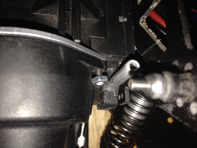

After searching for a while I finally scored the much sought-after RPM cover for my LRM slipper set-up, and I can't get anything on the forward-most screw. The old scans say to use a nylon 4-40 nut, and the smallest one I could find doesn't fit. Went to the hardware store and bought the smallest 4-40 nut they have, and that doesn't fit either. It fits the screw, but there isn't enough room for it to turn on the threads.
I read something about super gluing a washer to the end of a ball cup...is that the easiest or best way to attach this stupid thing?
