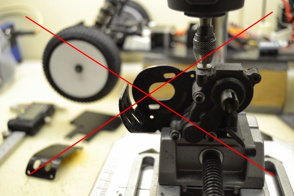

Now I don't need to worry about the wobbling motor mount anymore.
Maybe I'll cut chassis rear end a little shorter.
-Niki-
EDIT: This mod not needed anymore. Check out page 9.
http://www.rc10talk.com/viewtopic.php?f=35&t=32679&start=120#p413108

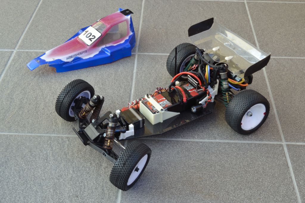

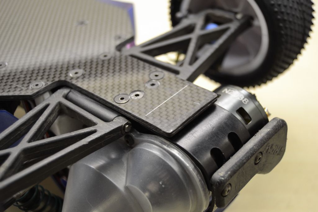

Shortened chassis 15mm from back (white line). All drawings updated.
Visited track today. Car handles better every time.
-Niki-

Seems to work nicely. 1000+ full speed test laps done. Zero broken parts.
I have tested B4 front rims with narrow and wide tyres. B2/B3 front rims with narrow tyres feels like the best option at the moment.
Added 2 shims to front shocks and changed 30wt oils to 25wt in all shocks.
Haven't tested B3 arms yet.
I just got my B4.1 Worlds ready yesterday. It's going to be a good reference.
-Niki-
