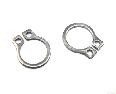

They are almost the very first thing the ground touches when landing hard and moving forward, not only are they low but they are angled to a point in which it is even easier to catch anything below them.
You could try using a bit of shoe goo to keep them there, another option is picking up snap ring fitted external retaining clips.
Chris
Chris
