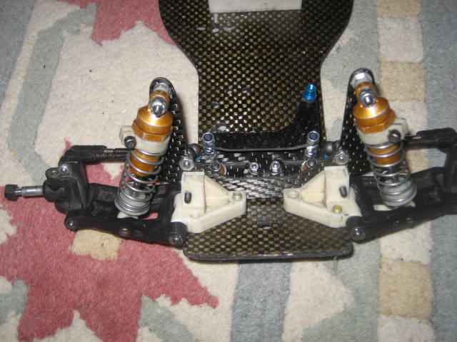

Here is my newest project.
To fit andys trailarms to the ae carbon chassis.
I did an plate out of 3mm carbon and will fit the arms on and then the plate to the chassisi.
More pics will follow up.

More pics.
Question.
Have somebody allready done this kind of setup
Jerzi

Re: TQ10 CHASSIS WITH ANDYS TRAILARMS
looks great .. i would just add one bolt throu the chassy battery hole to help suport the stress
May I ask how did you figure out the measurement of the add on graphite plates??
I used an original andys trailarm chassis that i borrowed from my friend.
I did an rear shockstay and now it got new holes that are arround 1cm higher than the original holes and now the shock works great.
so whats your wheel base and track now ? ive got the andys rear shock tower template on my andys build if you want it
Stay tuned..
Ill today trye to make an carbon version on the original Andys ballcrank
wich is ballraced.
Idea is simple and I think it is easy to make. Huh I say.
Thanks but no thanks.
It is almost ready and it look very sharp.
No flop and very smooth.
Im sure this is an very oneofkind part to the rc10.
5hour I worked on this part today.
Pics soon.
Jerzi
I have to make some small changes to the item.
Will be ready very soon...
Jerzi
Oboy how good the ballcrank is.
Smooth and very little flop.
Now the servo is like in the cars today.
Enjoy my friends.
Jerzi
