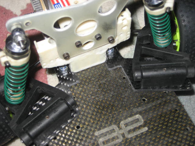

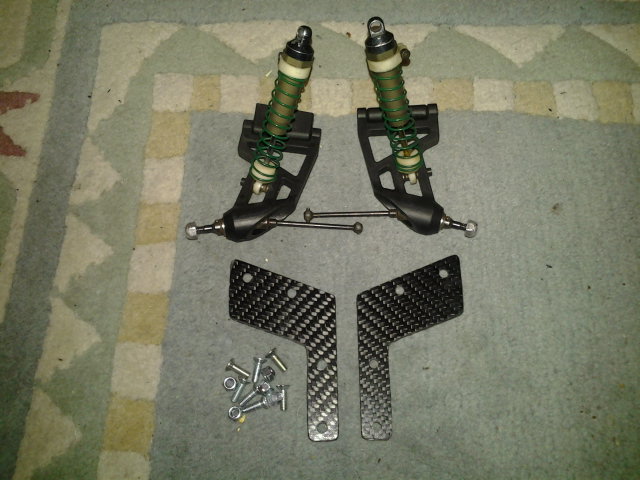

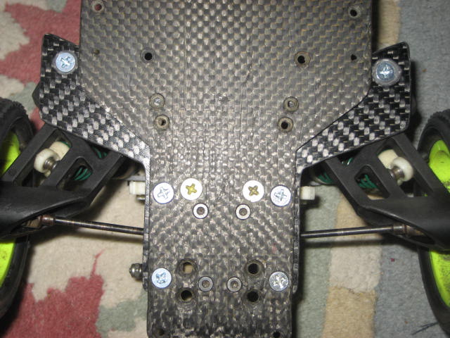

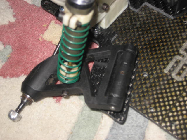

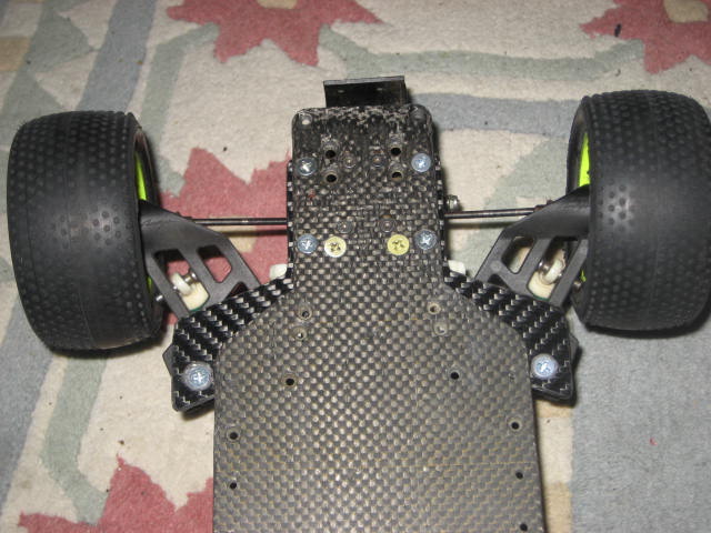

Here is my newest project.
To fit andys trailarms to the ae carbon chassis.
I did an plate out of 3mm carbon and will fit the arms on and then the plate to the chassisi.
More pics will follow up.
Jerzi
Jerzi

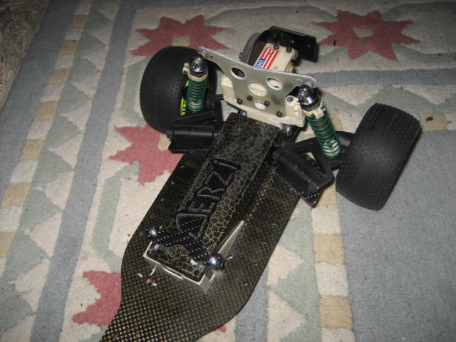

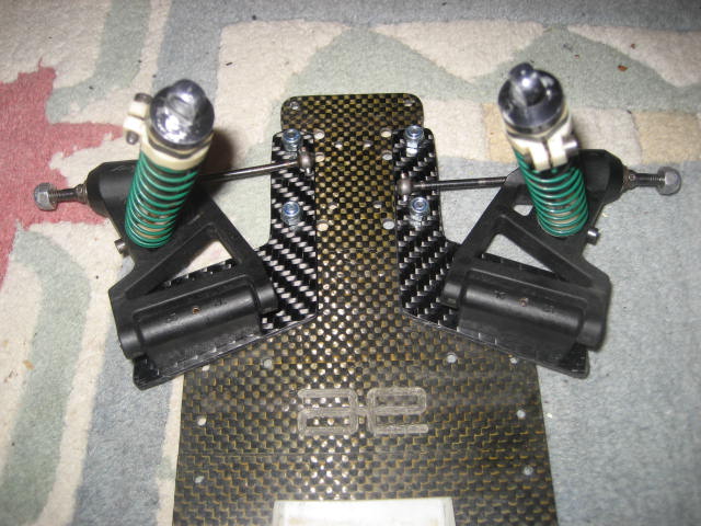

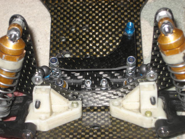

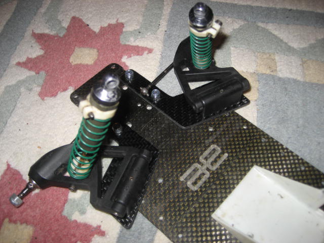

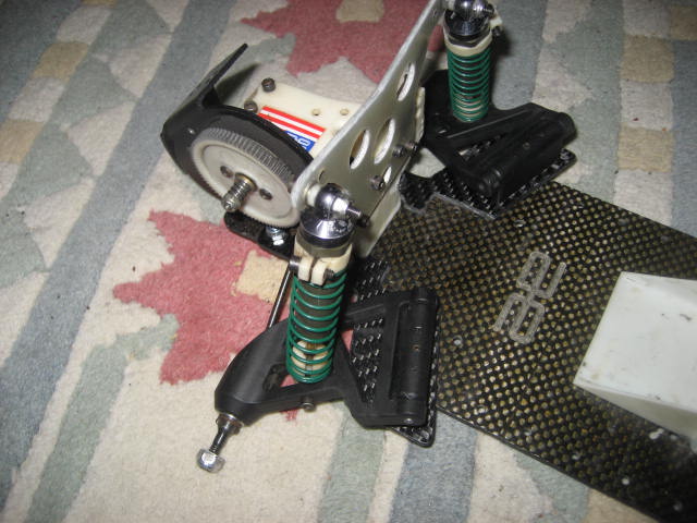

More pics.
Question.
Have somebody allready done this kind of setup
Jerzi
PS This idea come directly from A&L and thanks for that
Question.
Jerzi

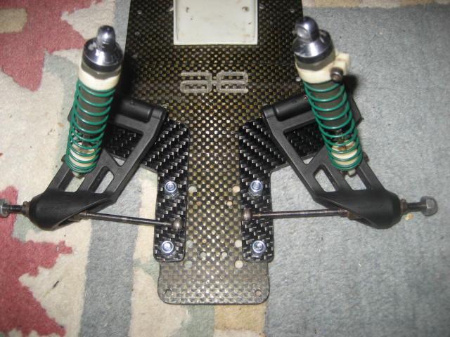

Re: TQ10 CHASSIS WITH ANDYS TRAILARMS
looks great .. i would just add one bolt throu the chassy battery hole to help suport the stress
i had these on my rc10 back in the day but never cared for how the car felt after and whent back to a arms
May I ask how did you figure out the measurement of the add on graphite plates??
- Posts: 549
- Joined: Sun Nov 07, 2010 3:58 pm
- Location: SUOMI/ FINLAND
I used an original andys trailarm chassis that i borrowed from my friend.
Jerzi
Jerzi
I did an rear shockstay and now it got new holes that are arround 1cm higher than the original holes and now the shock works great.
Jerzi
Jerzi

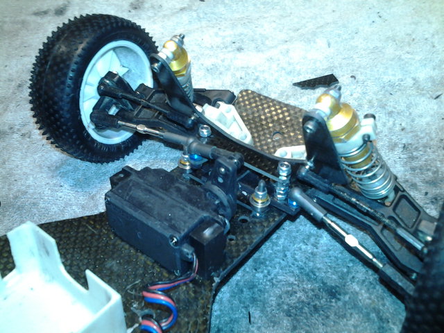

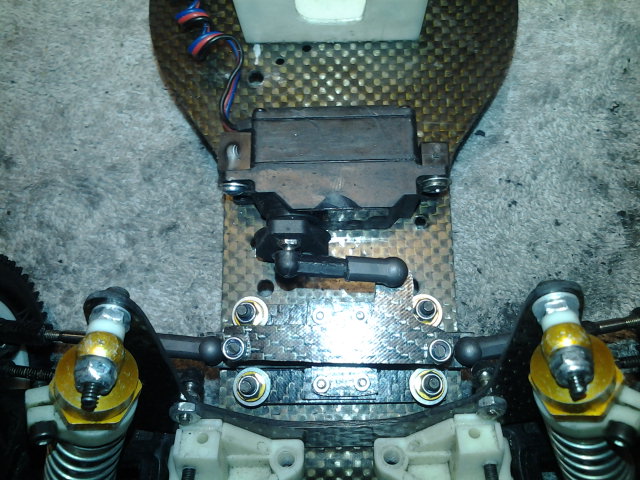

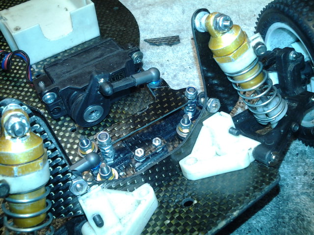

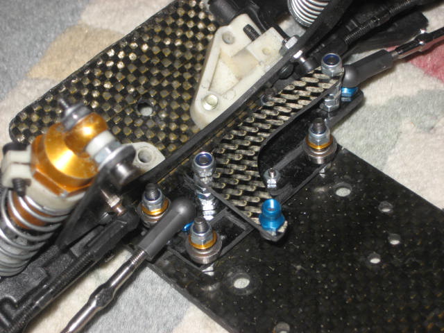

Stay tuned..

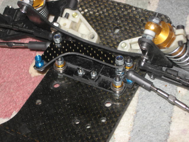

Ill today trye to make an carbon version on the original Andys ballcrank
wich is ballraced.
Idea is simple and I think it is easy to make. Huh I say.
Jerzi
Jerzi
Thanks but no thanks.
It is almost ready and it look very sharp.
No flop and very smooth.
Im sure this is an very oneofkind part to the rc10.
5hour I worked on this part today.
Pics soon.
Jerzi
Pics soon.
Jerzi

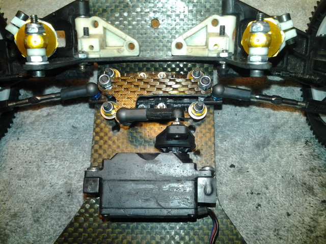

Oboy how good the ballcrank is.
Smooth and very little flop.
Now the servo is like in the cars today.
Enjoy my friends.
Jerzi
Enjoy my friends.
Jerzi
