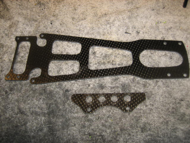

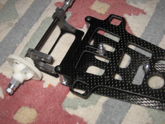

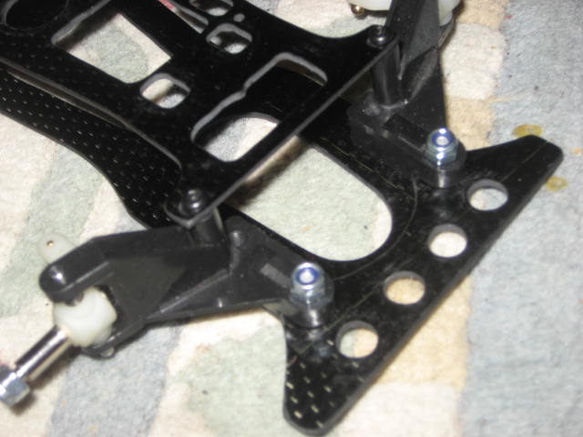

I started today an new project.
Will copy the original plates and the carbon is 2mm thick.
Will do the bumpper also out of carbon.
The main chassis is ready and it looks very high tech.
Jerzi
Jerzi

It's going to look very cool in carbon fiber but will the rear pod flex enough to allow for rear suspension?

This car will be in display use only.
But the flex with the 2mm carbon is pretty ok.

Looks great so far! I still can't believe you cut those out with only a Dremel!

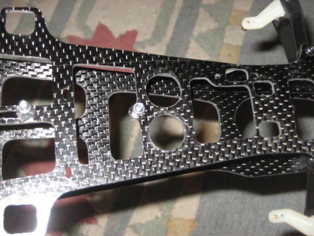

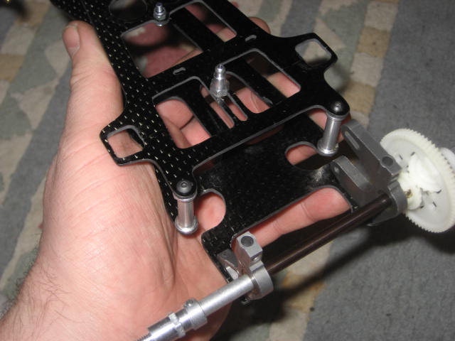

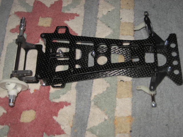

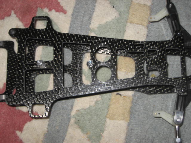

Thanks.
Well, after you have done as many parts as I have done so I promise you are good as Im. But I really think I can do better finish.
But now the car is ready so here it is.
I can say that the radioplate was an pain in the axx...
With that one I had many troubles with but I think the ready part is quite good looking.
I hope everyone will enjoy this project.
Jerzi
Jerzi
