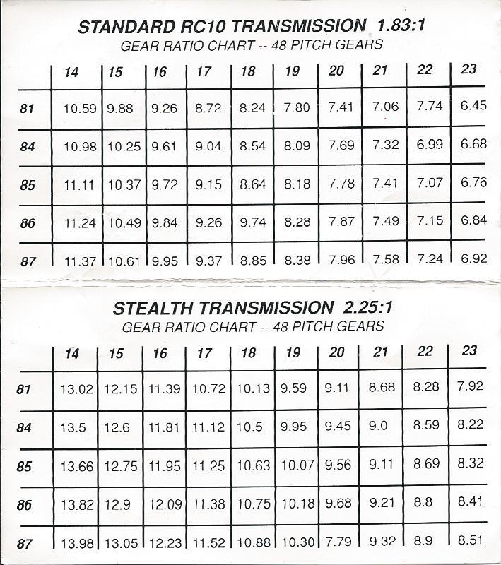

Re: Gear charts?
How about these?
From a small Reedy wallet-sized chart I found in my carp the other day.....
