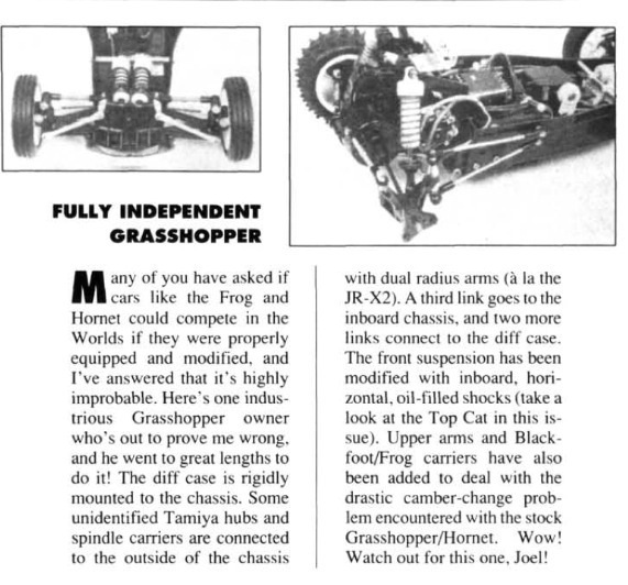

This one always intrigued me! RCCA Oct '89

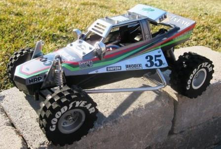

I did a rebuild of my old Hopper.. Is this "racey" enough?
Nothing too much but "Hopped" up a bit.. CRP front shock conversion, Hornet rear shock conversion, full bearings and Proline tires.. Added an ESC and a 540 silvercan motor for my nephew but I did run an old Trinity "Monster Horsepower" stock motor for a little bit before I "retired" my hopper until last year.. There are more pics at Tamiya base or in my photobucket..

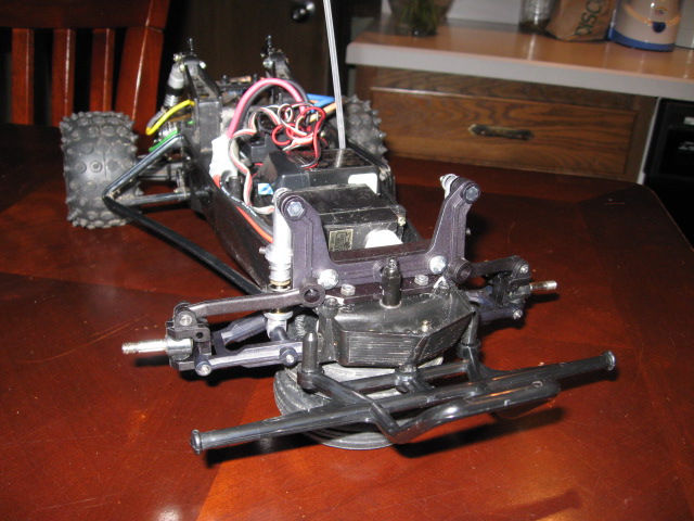

the fx10 front end kit works much better then the alloy shock mount kit:

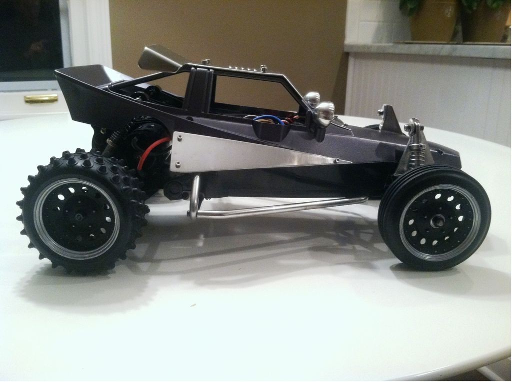

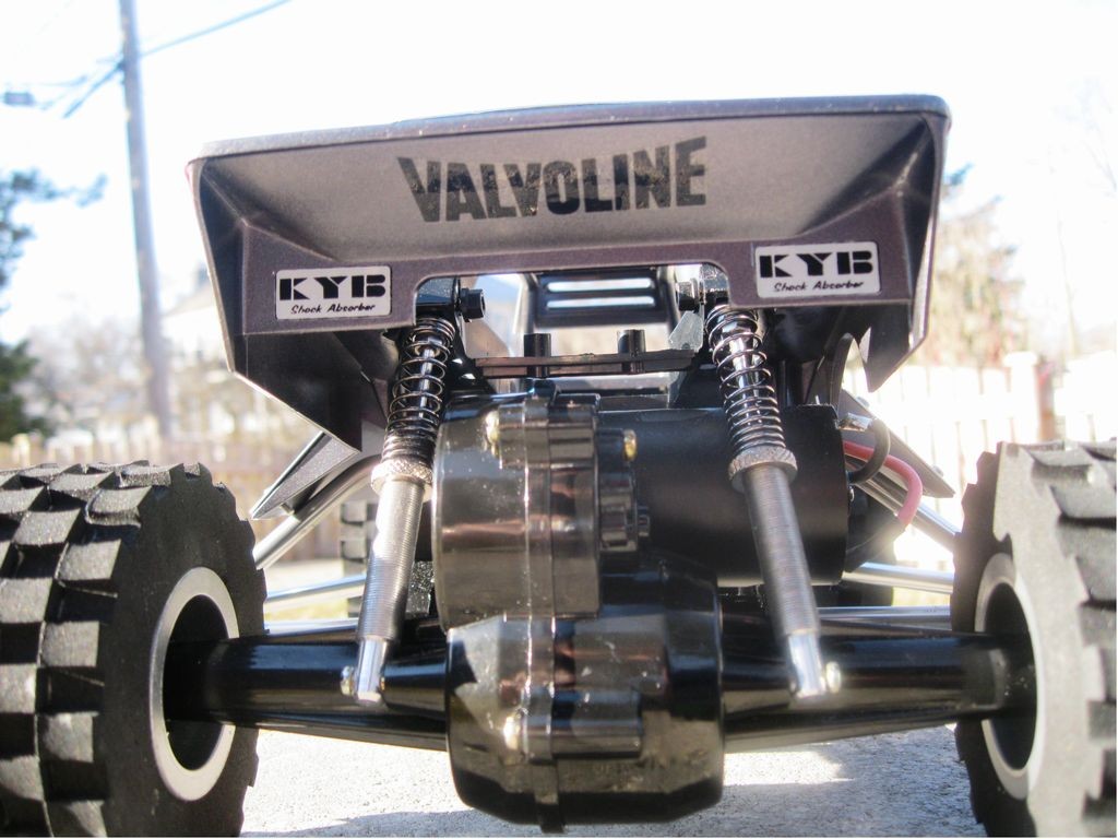

Here's mine. Mostly cosmetic upgrades with some homemade alloy body panels.
I added nerf bars, front and rear shock upgrades, sport tuned and later on soem alloy wheels hubs.
The original wheels / tires shown pre decals are traxxas bullet.
Actually one of my cars that is going on the bay to fund other more expensive projects!

gomachv wrote:This one always intrigued me! RCCA Oct '89
ive thoguht about four linking the rear before. i never seen this article though.
