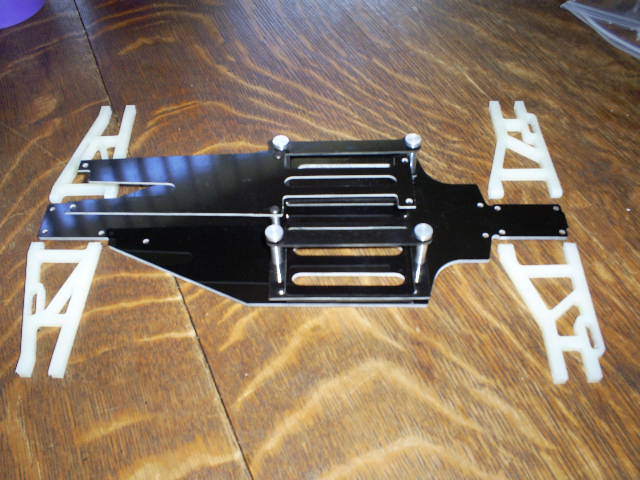

So I have decided to build a Optima Mid racer with a big thanks to Jake for the custom chassis, suspension arms and tranny top shaft. Im just waiting on a belt to get started on this.

Wowsers! Going with lazer length arms? I think with all the opt mid racer builds, we should have a get together,, and RACE THEM! Im ready with my lwb blue blinger.

How much longer, exactly, are Lazer arms to the Mid arms, from hinge pin hole to hinge pin hole? With both Barney & OptiMutt, I'm running GPM alloy arms that are 5mm longer than stock, and 68mm CVDs work perfectly. Just wondering.mikea96 wrote:There custom lengths for running ZX5 hubs and wheels.

These arms are exact measurements of the Lazer ZX arms.
The front arms with ZX5 c hubs and steering arms need the 73mm swing shaft. The rear uses ZX5 rear carriers and 62.5mm swing shafts.
Mike even though I am biased, those parts do look good and will give you one heck of a race car. Looking forward to more pictures.
Jake

Re: Optima Mid Racer Build
when using zx5 c hubs LA-219-4/7/9
65.5 in the front and 62.5 in the rear.
LA-232 front and UM-510 bone and La 231-02 axle in the rear.
Are those arms machined ????
the 73mm unis are for the sp aka losi style front suspension
mvh Isobarik

That would make perfect sense for the rears, then. So the rear arms are basically the same general specs as Optima/Optima Mid arms, which require 62.5mm swing shafts. They look longer but that's probably because the rear hubs for the Lazer ZX5 have far less offset.Seabass wrote:These arms are exact measurements of the Lazer ZX arms.

When I built my car I actually purchased the 65.5 unis initially to find out they were too short for the setup I was running. I was able to get the 73mm to fit perfect without throwing the wheelbase out of whack.isobarik wrote:when using zx5 c hubs LA-219-4/7/9

if you are using the c hubs from the mid on the lazer arms the 65.5 unis will be to short but then again it will also be to wide to race with.
65.5 unis and lazer arms and zx5 c-hubs la-219-7 there is now way jose they are to short i use them myself.
the 73 mm unis are for the zx-5 sp / sp2 since they have copied losis setup i think the axle itself should be to short for the zx-5 hubs la 219-4/7/9
mvh Isobarik

If it´s for racing purpose, I don´t get the idea of using nylon arms over the fibre reinforced plastic original lazer arms?
I agree it looks sweet, but a downgrade from the originals if You want to race the thing

yes but you said it youre self they look SWEET..DennisM wrote:If it´s for racing purpose, I don´t get the idea of using nylon arms over the fibre reinforced plastic original lazer arms?
