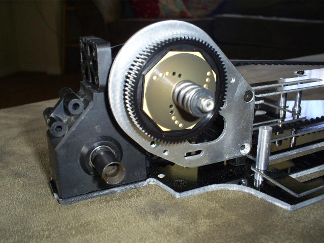

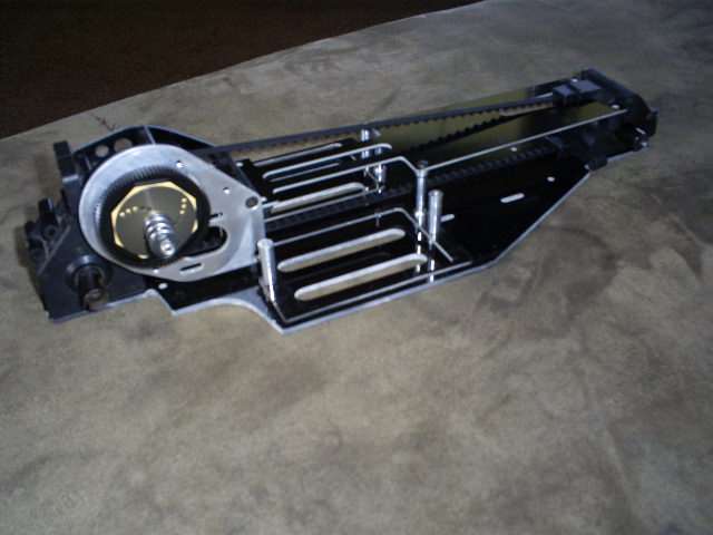

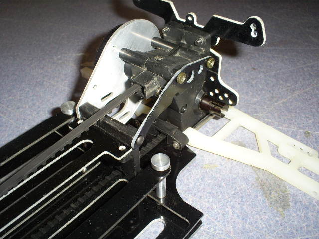

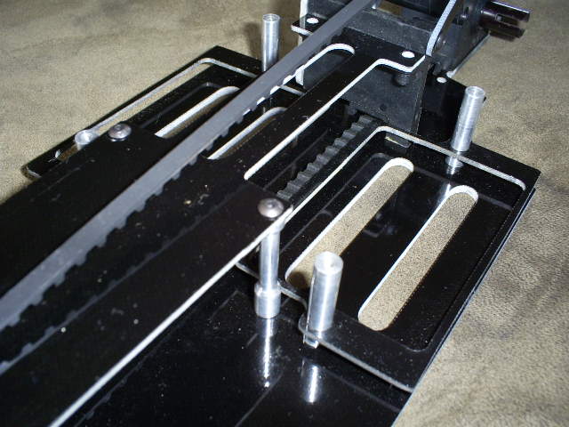

Small update! I rebuilt the diffs and assembled the b4 slipper assembly and mounted gearboxes to the chassis!

Nice, glad to see some progress on this one. I am looking forward to seeing more.

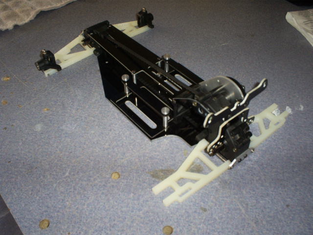

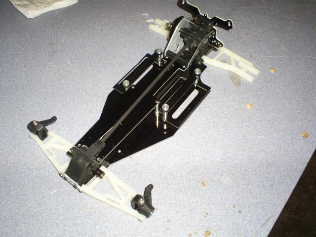

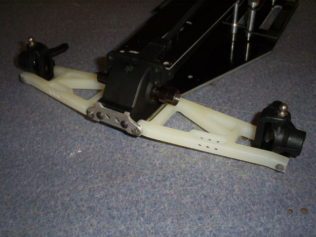

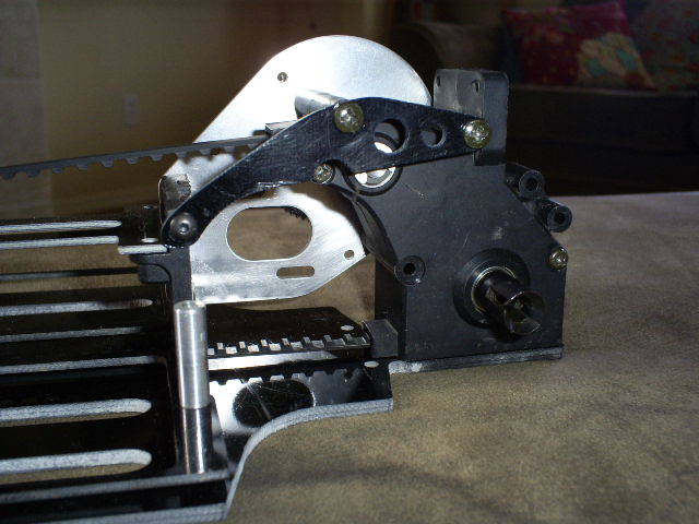

Had a little RC time today so i got some more done on the mid. I need to order universals for this, and shocks and figure out my turn buckle lengths.

I really like the B4 slipper setup, that easy to do? Thinking I would add one to my Lazer project.
mikea96
Posts: 3601
Location: Puyallup, WA
Has thanked: 659 times
Been thanked: 878 times
Re: Optima Mid Racer Build
Post by mikea96 »
Jake (seabass) made the shaft for running the b4 slipper
