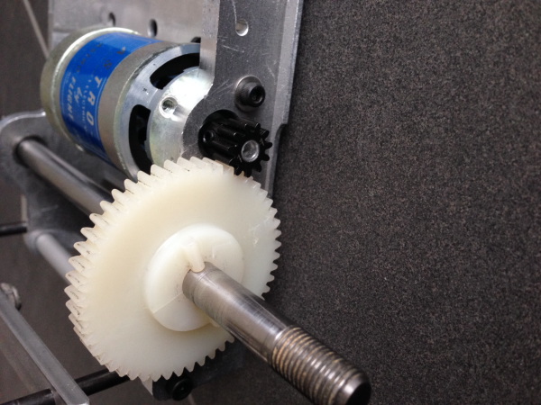

Re: Pitch/module of 1:8 Delta/Associated clutch/drive gears?
Received the Losi module1 11tooth pinion.
My motor shaft is 4mm, and the hole in the pinion is 5mm so I used my lathe to fabricate a small adapter (more like a bushing) and now it fits!

aip47-2008 wrote:Nice work there Mick!
Thanks Aaron!!
