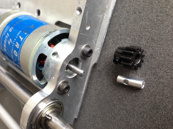

Received the Losi module1 11tooth pinion.
My motor shaft is 4mm, and the hole in the pinion is 5mm so I used my lathe to fabricate a small adapter (more like a bushing) and now it fits!
