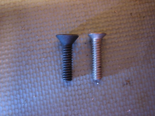

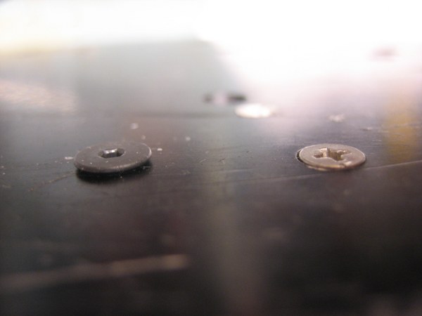

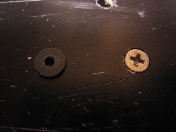

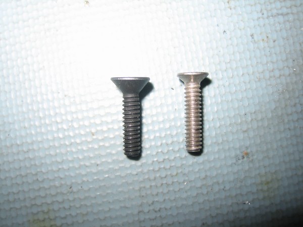

Re: Countersinking
OK, here are some sample pics. An 82 degree standard screw compared to a 100 degree aerospace screw, both #4 mounted into one of the stock countersunk holes in the rc10 chassis, B stamp.
the 82 degree screw would not tighten up against the chassis with just a nut, I had to add some washers to allow it to pull up tight. The 100 was snug with just the nut, but not overly so.
you can use either type on the factory countersinking without much worry.
