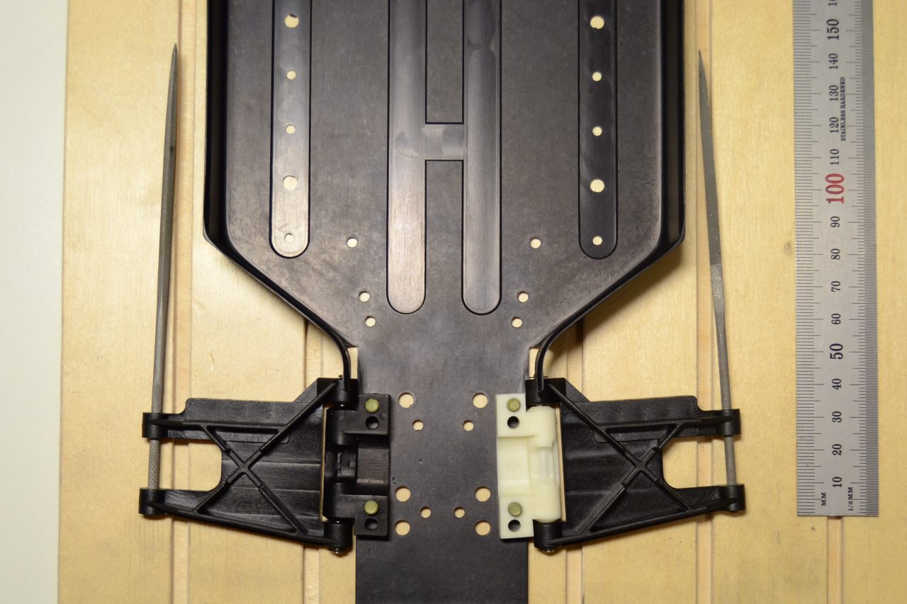

Chassis holes are ok.
So if reproduction #6360 mounts are 1.5 degrees (like originals) what are these mounts that comes in Worlds kit? Instruction manual update coming?
As you all can see in the picture below mount is far from beeing 1.5 degrees. I took that black mount out of my old racer replica.
If angle is 1.5 degrees, in 150mm distance pin line should move inwards 4mm.
If angle is 3 degrees, in 150mm distance pin line should move inwards 8mm.
Groove in wood sheet is 5mm wide...
I don't need to look after 3 degree mounts. Just use those in the kit. I'm :D

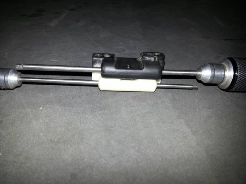

Sorry for a late reply but here's a pic of Tims RC10 worlds rere. Tim did say his car was stock out of the box. You can decide for yourself. Looks like more than 1.5 to me.

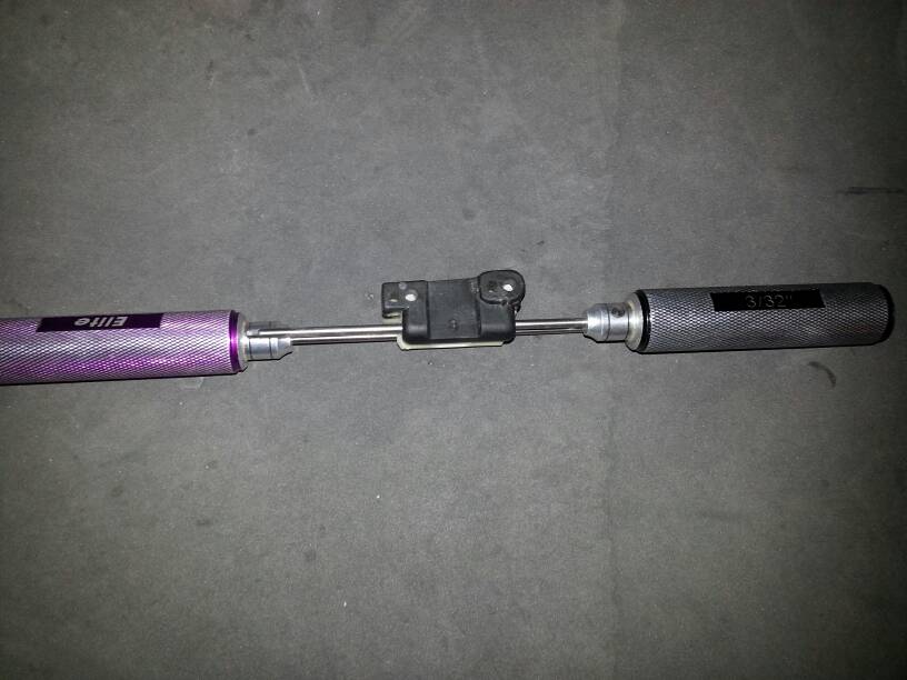

New out of pack re-re with a T2 mount. They are 3

But the T2 mount is moved back a hair

#6360, I opened the pack to take those pictures. Ran them on the car last night as well...:)
