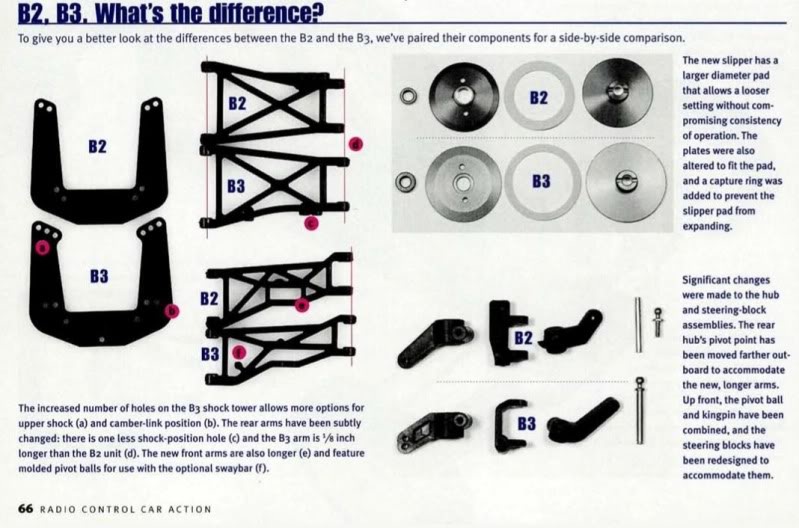

Re: B3 help, or maybe it's a B2, but guy in store said B3 lo
Based on info in other threads, the tower is a B3 tower (B2 has only two shock and one camber
hole) and B3 spindles (B2 used older style blocks and arms). For the parts you need, B3
The rpm steering arms should be great. For a Tower, you want this one (or an equivalent)
Fiberlyte will make them for you, otherwise you will need to locate one. They are out of production and I don't see any on eBay
http://www.fibre-lyte.co.uk/fl/cars/associated/b3.html

Gomachv, thanks for the post, saved the file to my phone.

There's plenty of replacement parts. They're just under a different name. Thunder tiger bought out Team Associated and they still sell a buggy based almost 100 percent on the B3.
http://www3.towerhobbies.com/cgi-bin/wti0005p?&I=TTRD8761&P=Z
there's a few a differences but all the things that commonly brake seem to be a direct fit. I've replaced suspension arms, hub carriers, castor blocks, steering blocks, shock towers, wheels, battery hold down straps, and suspension arm mounts. All direct fits. The shock tower, though, isn't nearly as stiff as the stock B3 tower. That should make it less prone to breaking though. If you're able to find actual B3 parts, stick to those as they seem to be slightly more durable.
