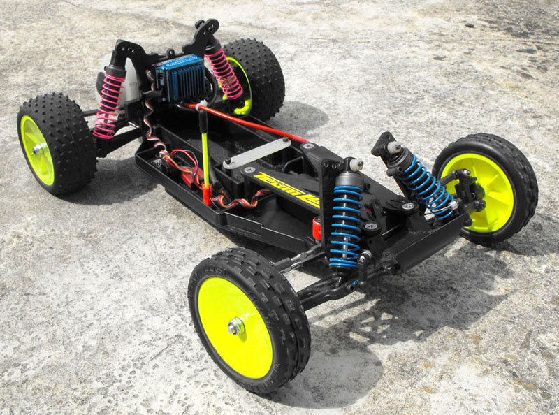

Re: My Losi Pro SE Racer Project
Thanks Jirka for the suggestions, some very useful input from you for me to try.
I had already fitted about 4mm of limiters in the shocks and running outside holes on wishbones front and rear. Tried Black springs on front for one round and car would hop around over small bumps and ruts, but with no significant improvement to front end dipping. A hole further out on front wishbone I feel would make for a huge improvement, but not possible. May try some more spacers in shocks as car still seemed to have plenty of droop and ride height, probably to much. The rear of the car seemed very good, perhaps to good as it felt planted compared to the front that just felt to soft.
My shock set up if it helps was:
4mm limiters between cartridge and pistons front and rear.
3mm limiters between cartridge and shock bottom to reduce upward travel front and rear.
Outer holes on wishbones front and rear.
Middle hole on towers front and rear.
No.56 pistons all round.
50wt oil front, 30wt rear.
Blue springs front, red springs rear.
Trevor.
Trevor.

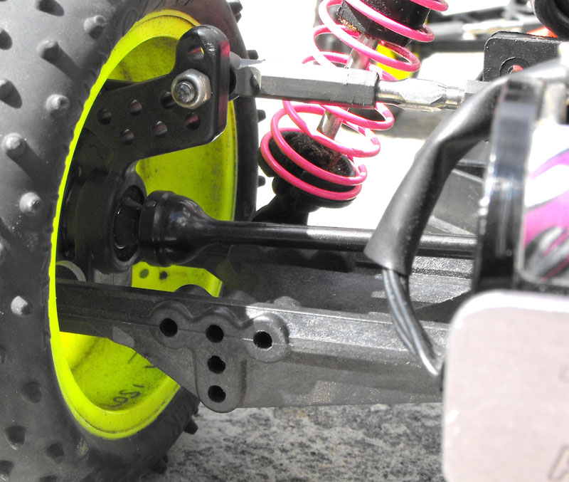

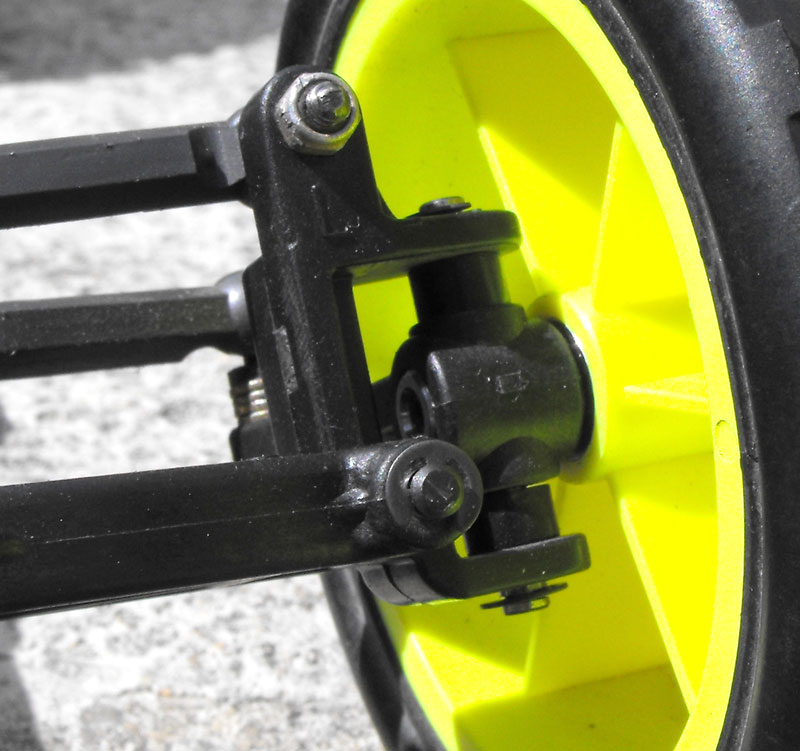

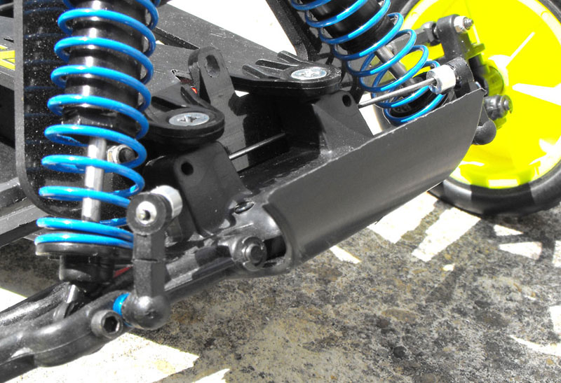

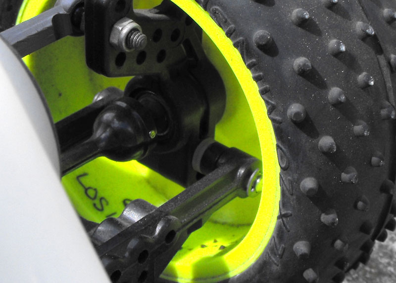

Made a few changes since last meeting, some made minor differences but found changing front tyres to Losi stagger ribs transformed the car completely and made it a whole different car. Have some Schumacher blue compounds and Proline M3 ribs to try next time.
Changes made, as I said some didn't make much difference but worth trying:
Front oil changed from 45wt to 50wt.
Front piston changed from red to smaller black.
Jammin steering enhancement kit.
Homemade front anti roll bar fitted.
Front top link moved to innermost hole.
Front shock mount position moved to inner hole.
MIP CVD driveshafts.
Rear pink springs instead of red.
Changed rear outer hingepin to one with e-clips and fitted spacers.
I found the harder compound front tyres made the biggest change, so for next round I think I can soften the front end slightly.

I'm interested as to which company makes/ made the neon yellow front wheels that you have fitted as I've not seen them before...jaro wrote:Made a few changes since last meeting, some made minor differences but found changing front tyres to Losi stagger ribs transformed the car completely and made it a whole different car. Have some Schumacher blue compounds and Proline M3 ribs to try next time.
