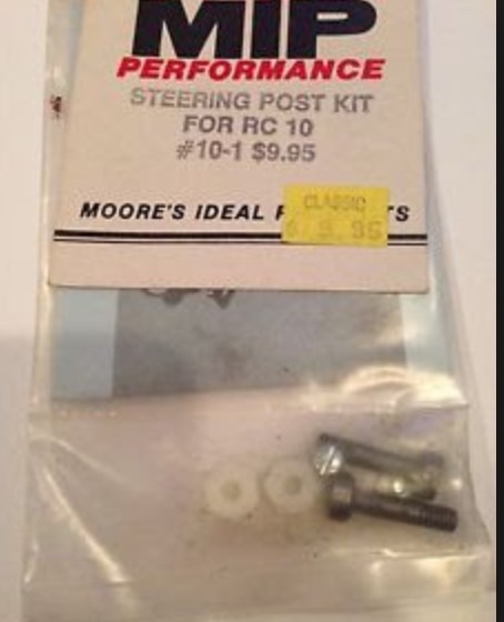

Mip made a steering post kit for stock bellcranks, but they used a 4-40 screw to secure it to the chassis. IMO not worth loosing the 8-32 screws
Re: Stock steering bellcranks galled up
So how does that work? Do you need to drill the chassis for the 4-40's?
- jwscab
- Posts: 6580
- Location: Chalfont, PA
- Been thanked: 505 times
no, they just replace the #8 hardware with #4 hardware and those posts. I suppose a steel #4 is stronger than an aluminum #8.
