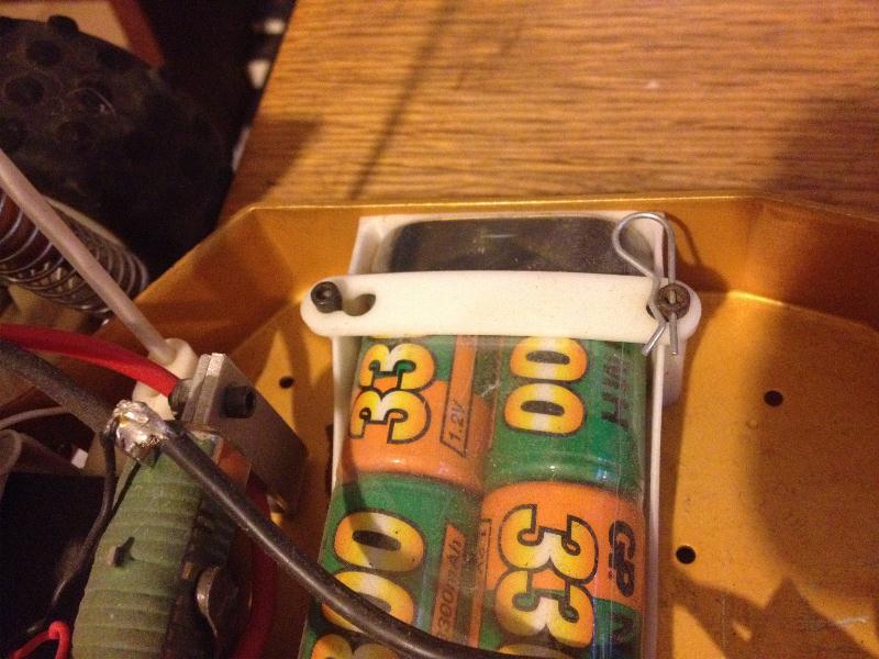

Hey everyone - I'm almost finished building my rere World's kit. The transmission is tight but I'm going to run it HARD and see what happens.
But my question for you all is - how in the heck are you supposed to get the battery holder on and off? If you screw in the screws (not all the way I'm guessing), you can squeeze the sides of the battery tray when there isn't a battery in there. But once you put a battery in, there's no way to get it out. I'm thinking of swapping them for the thumb screw holders.

Shouldn't need to squeeze the box, slot the slotted side over one screw and then slide it into the locked position then drop the non slotted hole over the other screw and run a body clip through the hole in the head of the screw to secure the battery strap.

I wish it was as easy as the older ones! Doesn't seem to make 'sense' on the World's car. There SHOULD be some kind of screw with a hole in it that you can put a body clip through it and that would make sense. But both sides have larger holes and its tight on both sides to literally the only way to get the holder off.

For Lipo's I reamed out the holes a bit larger and used both screws with body pins. I also ground down the part of the battery strap that slides under the rear bulkhead/battery slot. About half the width, but I use pretty thick Reedy 5500 packs.
