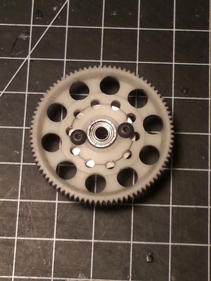

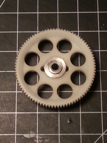

I don't think I express my selves good enough
The bottom spur in the picture is compete with inner metal gear. The spur in the top of the picture is a replacement one. You have to be able to replace it otherwise they wouldn't sell replacement gears in different sizes!
So my question is how do I replace the spur, is the a special tool for this?
Re: How to replace Ultima/Optima spur gears?

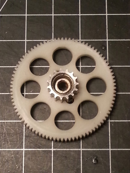

IF this is the same as on the other RRP's, They made two different systems.. One was a non replaceable gear and one that is replaceable.. The non replaceable ones had the gear molded to the smaller gear.. The other one had small screws to swap the spur gear.. It looks like the bottom one in your picture is the non replaceable type.. I don't have the RRP part like your bottom one, for the Ultima anymore (I had one many many moons ago
) when I had an Ultima for a month then sold it (got a Yokomo for it and the Ultima was a basket case) but I do have both systems for my Yokomo.. I'll pull them out and snaps some pictures to show you what I mean..
And then..........Oh I had these on my computer.. RRP non replaceable spur: I'll get you some better pictures in a bit..
Shawn
Shawn

Ok here are the pictures of the two Yokomo parts I have.. These are the two systems I have seen for RRP spur gears:
Non Replaceable: Replaceable: Hope this helps you..
Shawn
Shawn
