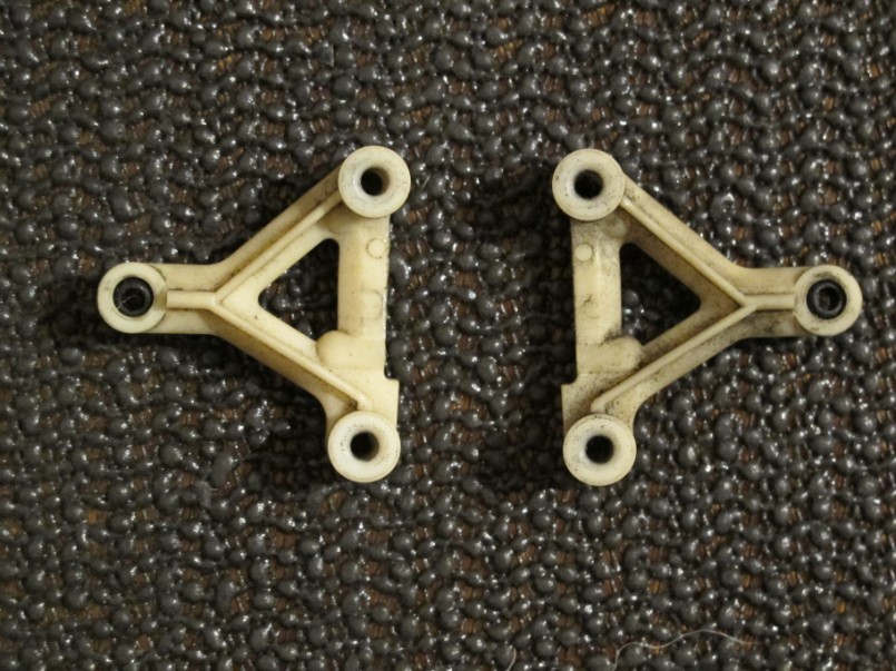

Finding parts was a real problem for the white lower arms. Actually I try using new parts when building a car, in the end these came up. Not really looking nice.

After an extended session at the supersonic cleaner they look much nicer. :)

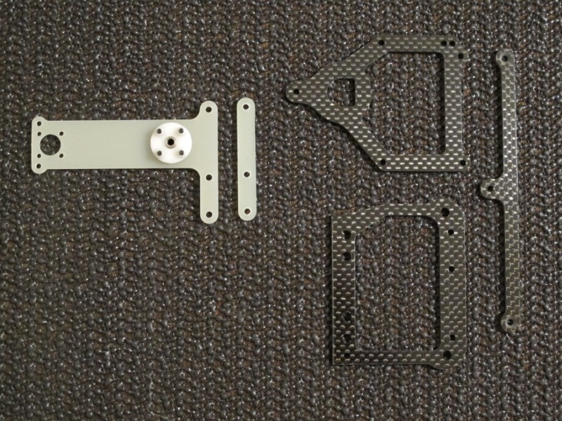

Next step t-bar and pivot assembly.
Also graphite parts deburred.

Seems I bought the wrong motor-plate. Threads don´t match with lower pod plate.
OK, have to strip my RC10L now. One of the white plastic pivot sockets had gone to the RC12LS t-bar already.

Re: RC12LS 1995 Euro Champs Special
Looks like a 4537 bulkhead instead of the proper 4347. Very cool build!

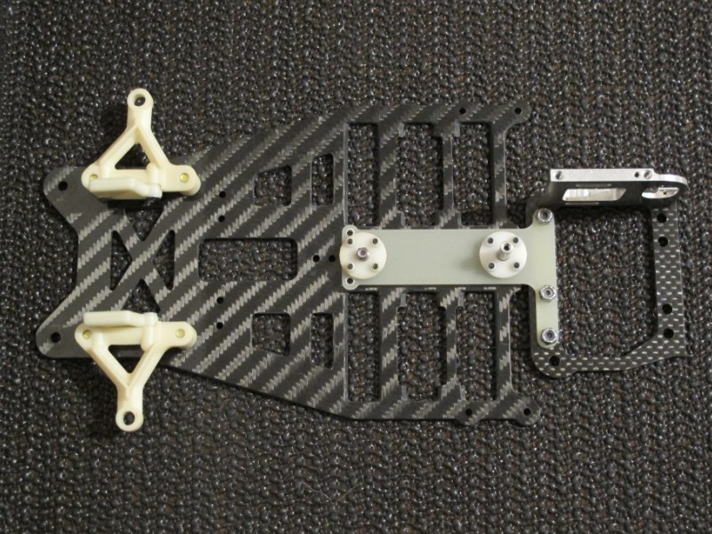

Preassembled parts mounted to the special chassis.
Upper arm mounts at the front end is 10° version, as used by most top drivers.
Correct motorplate at the t-bar now.

Left pod plate added now, also tweak screws at the t-bar.
