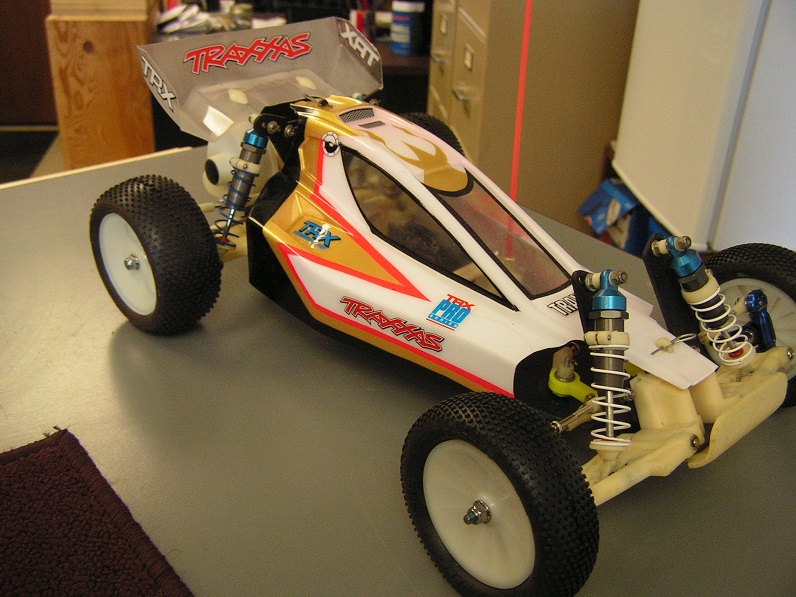

Re: trx1 short car
Lookin' good. Nice paint. Looks aggressive. What are you thinking for tires?

Re: trx1 short car
The rear wheels are TRX3 , 2.2 inch. I bought a set of Bandit front wheels that have the same look. Gonna look into aftermarket,bandit style caster block/steering knuckles that have the inboard bearings. If that works I be able to put any current 2.2 front and rear tires on it. the bandit front wheels I bought are either 2.1 or 2.2TRX-1-3 wrote:Lookin' good. Nice paint. Looks aggressive. What are you thinking for tires?

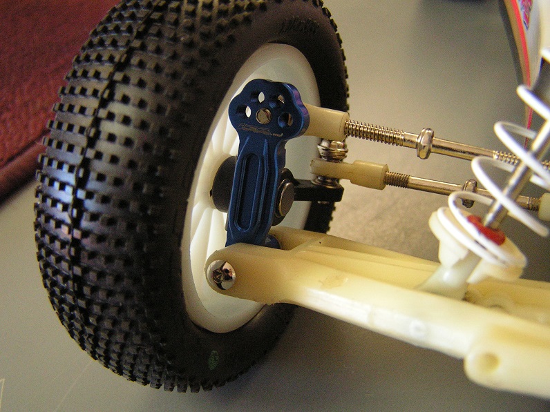

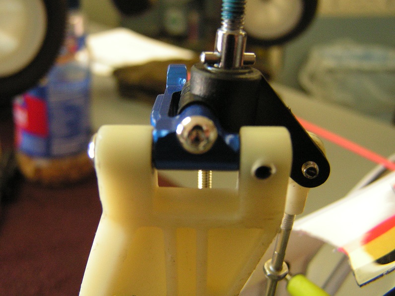

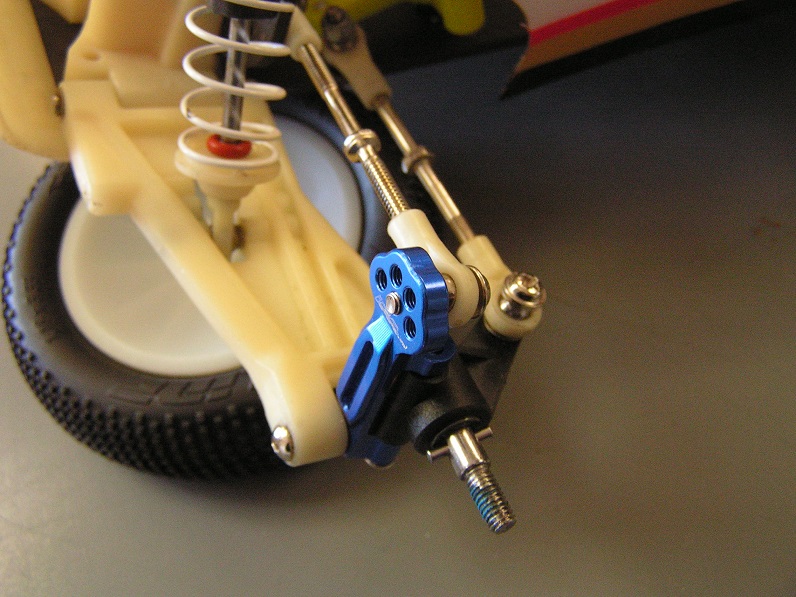

update!
Integy front caster blocks with bandit steering knuckle. The bandit hinge pin that goes through the arm is a smaller diameter than the hole in the arm. Drilled a hole and used a set screw. I have other new old stock arms otherwise I wouldn't have drilled the holes

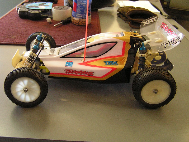

Re: trx1 short car
Here she sits with modern treads....trx3 rear wheels, bandit front wheels....pink aerial too

Re: trx1 short car
OSR wrote:update!
Looks great!
If it were me, I would have drilled out the hole in the caster block instead. But that's just me. Looks like it worked great either way!

Re: trx1 short car
awesome looks! Agree with drilling the castor block... that small grub screw has a lot of work to do to hold that wobbling pin....
