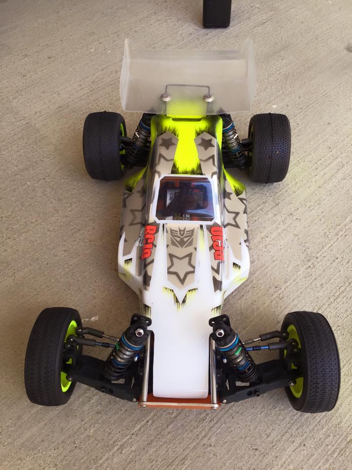

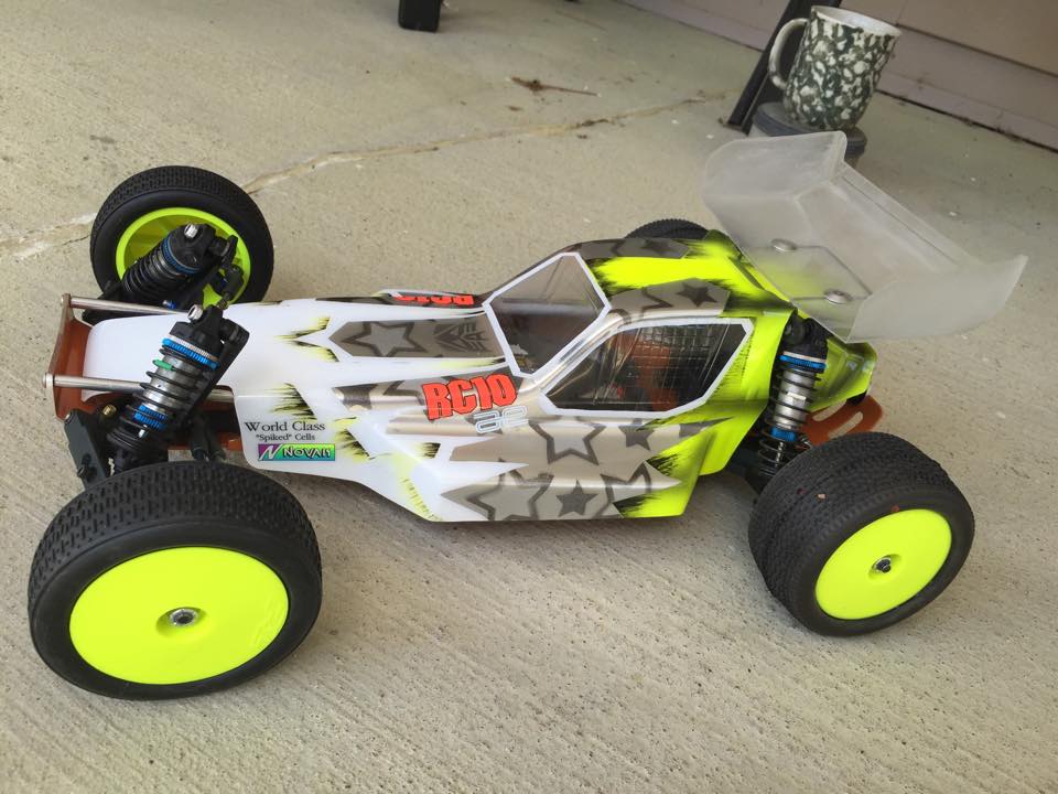

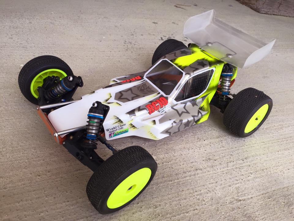

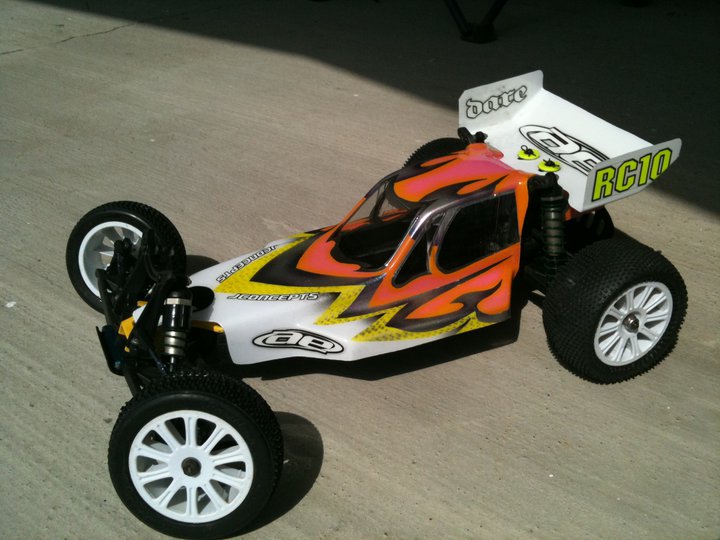

Closer to being finished but trying to get it mostly track ready for this wknd before they tear up the track for the race in 2wks. I still need longer front tower & fine tune some lil hardware quirks.
Using the B5m battery cradle, and running the shorty pack sideways; the ESC bullet connectors need to LowProfile 4mm Bullets, bcz the edge on the cab of the body is direct above the battery power ports. I also remove the 3 Foam strips from the chassis which gave me about 2-3mm more body clearance. This one of the area of the body that will rub, and will have tape on it.
I've also cut the battery cradle to run the shorty pack inline.. Lots of battery configurations to test...
