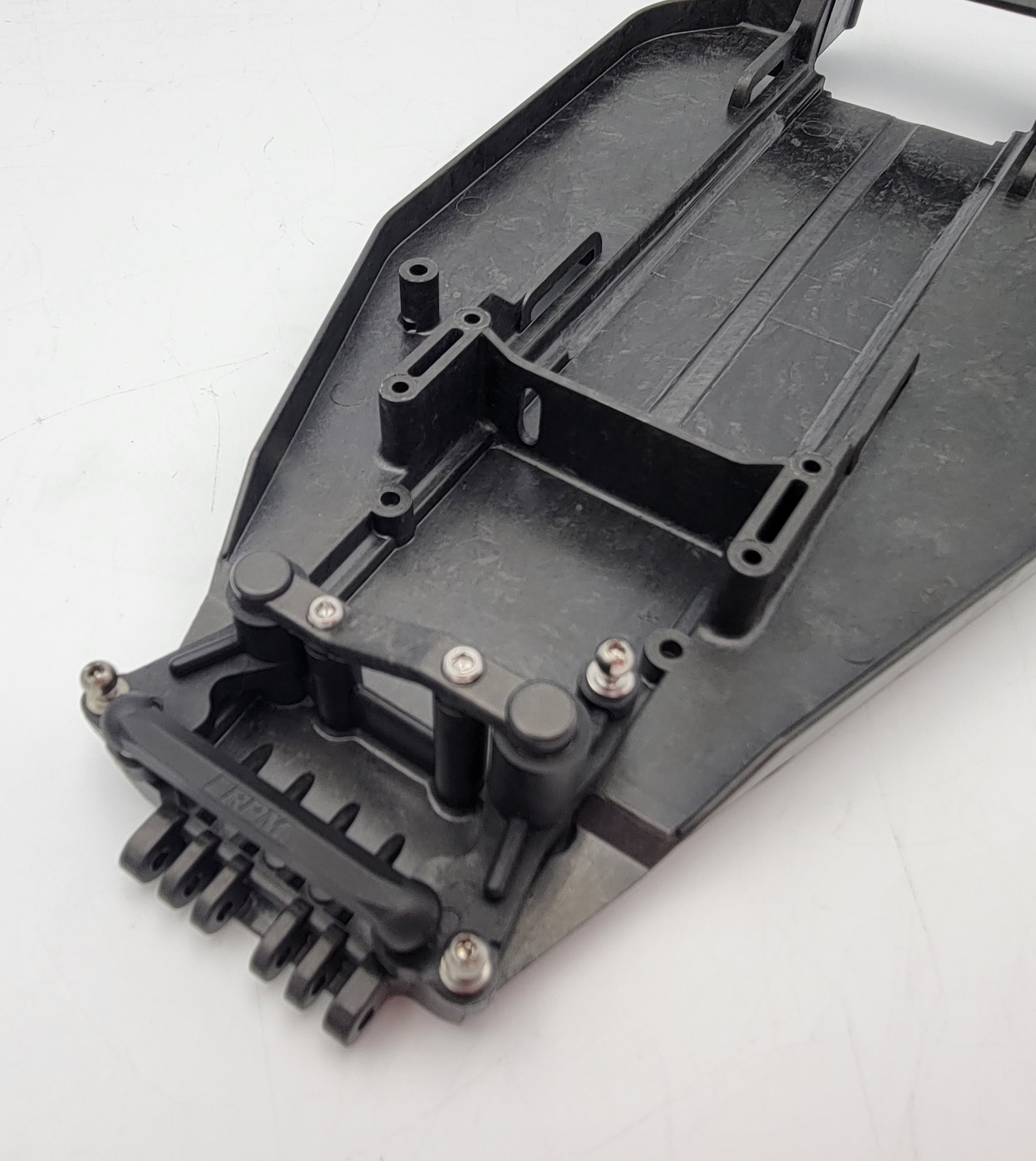

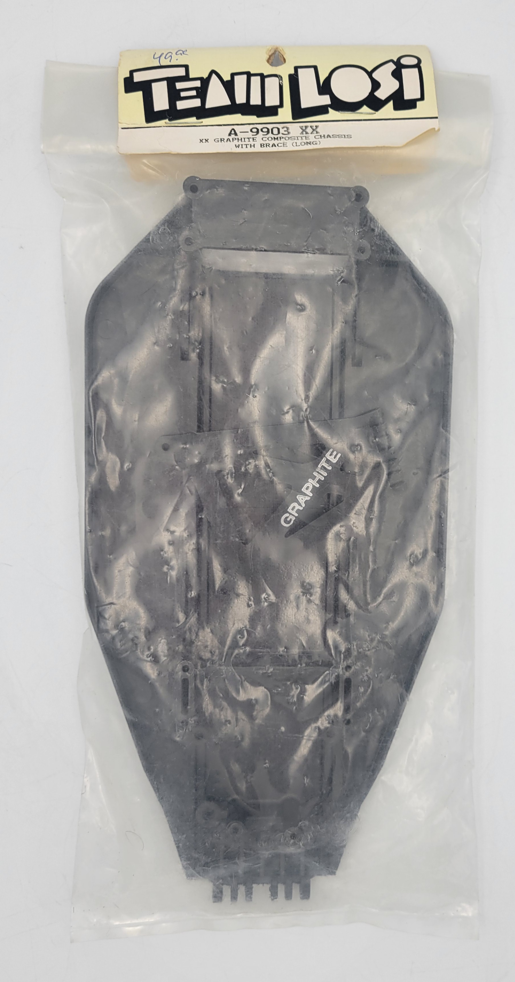

I'm planning this to be my last XX build. It will be a very clean racer with modern electronics. No blue bits. All silver and black.
I'm using the L length chassis, which is longer than the regular buggy length. I did this on one of my other XX builds, and I really like it. It should put the wheelbase close to that of a current 22 5.0.

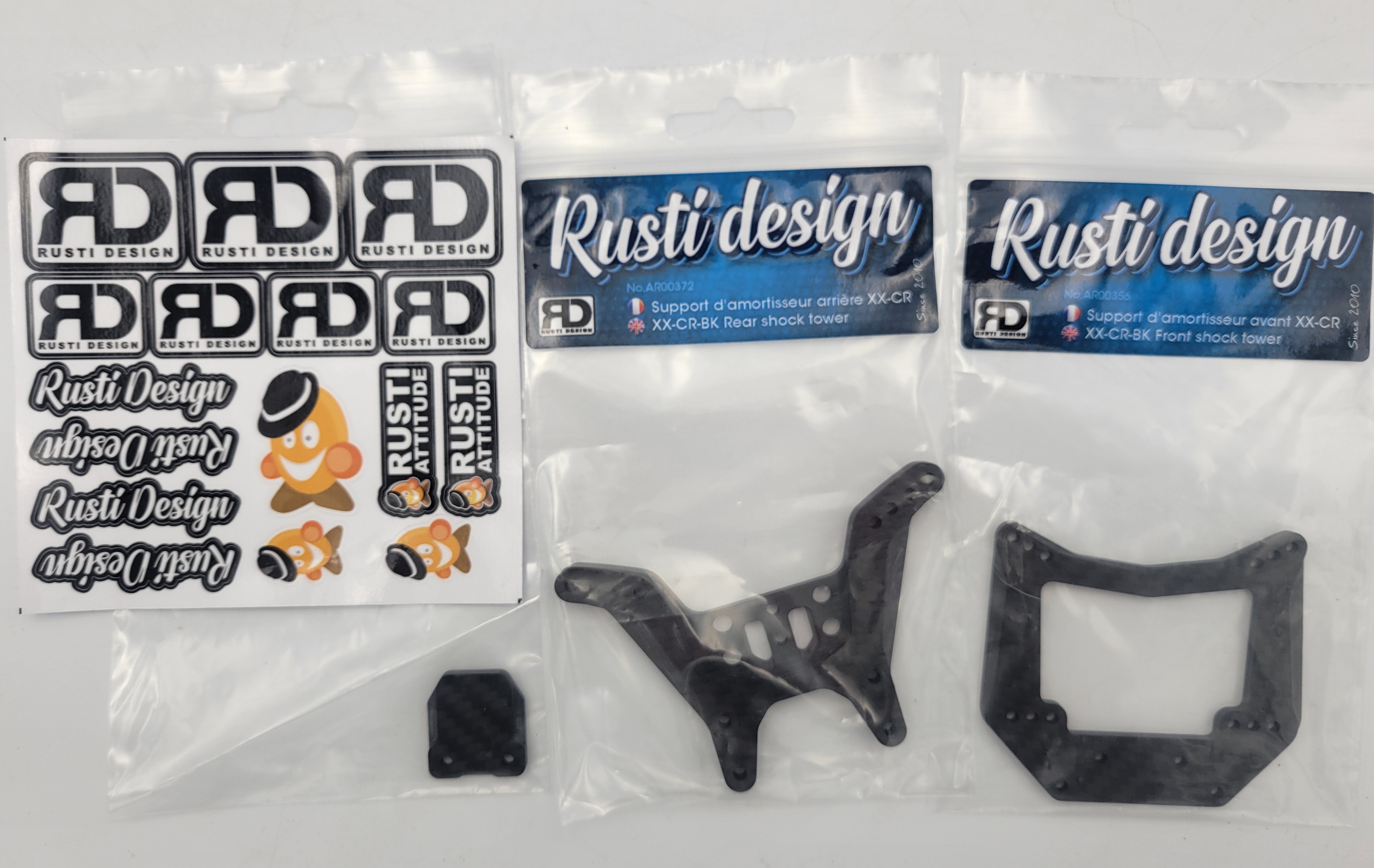

I'm using Rusti Designs towers. The shocks will be XXX units. All Trinity parts used will be stripped and polished.

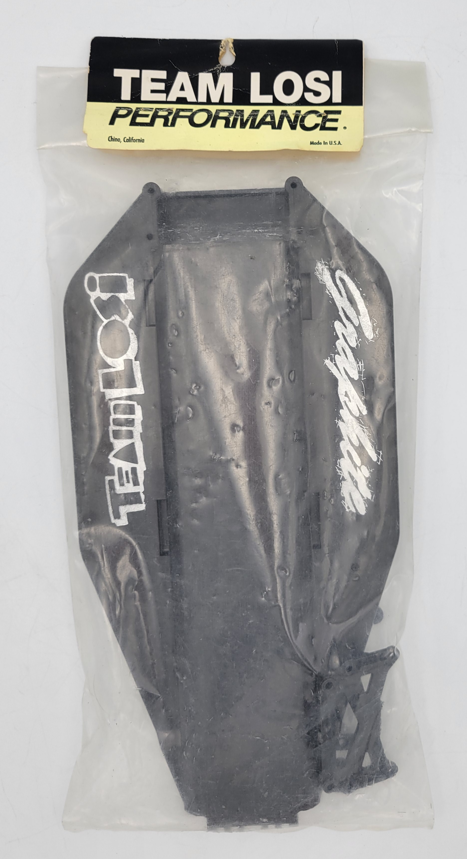

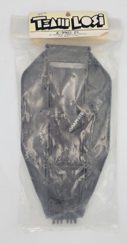

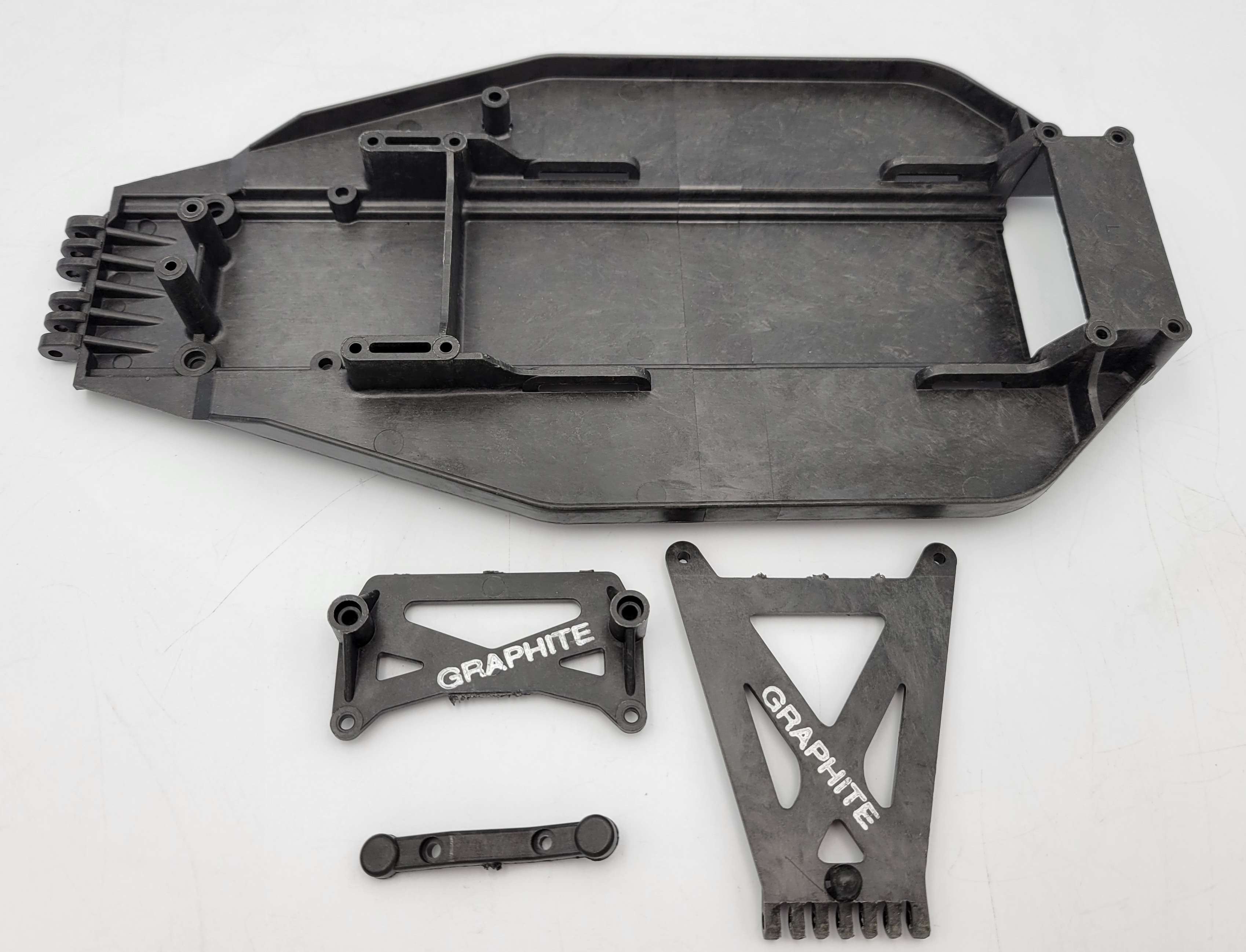

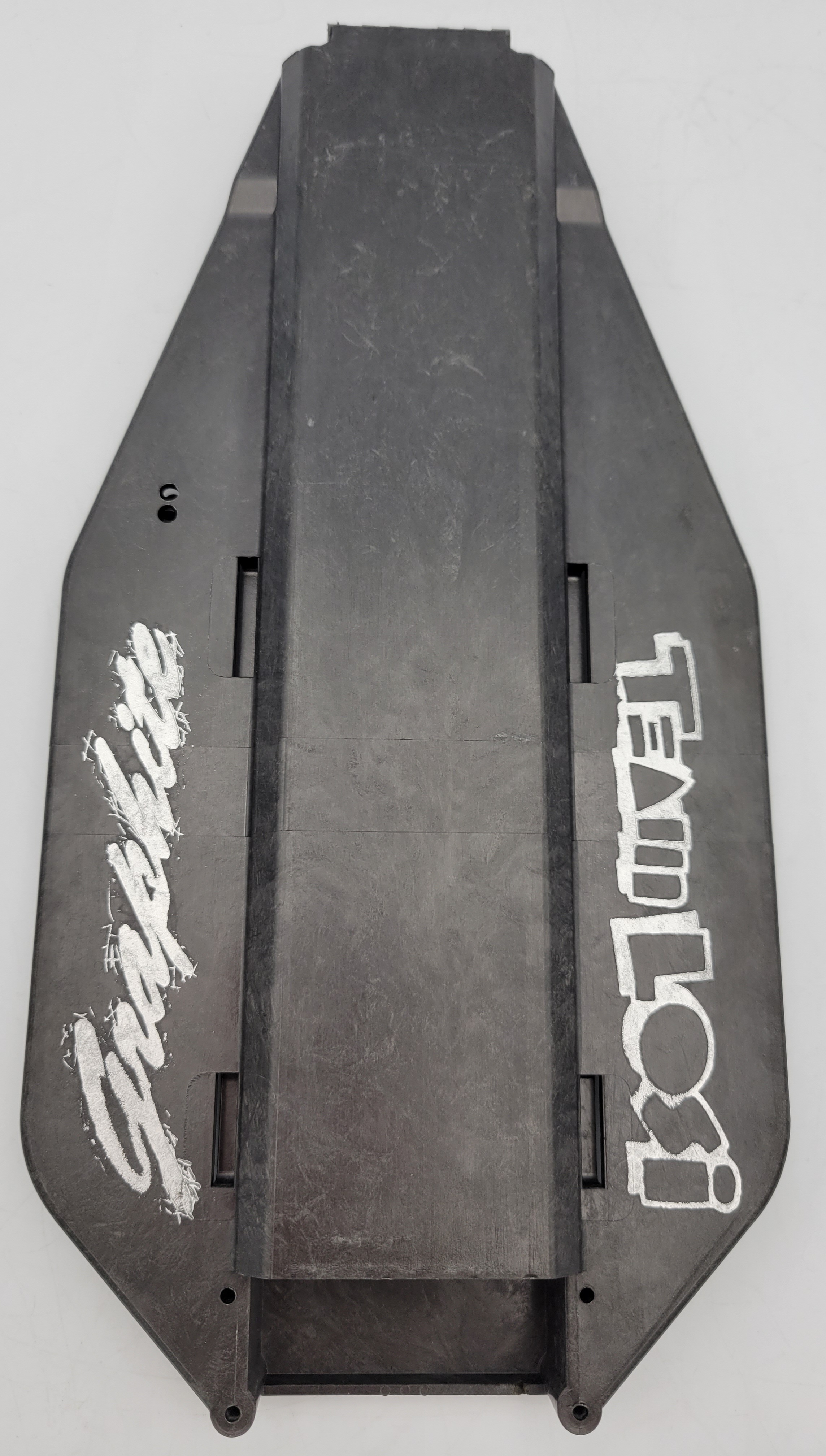

Nothing better than a brand new Graphite chassis. I love the look of the graphite pattern.

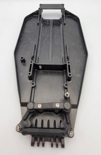

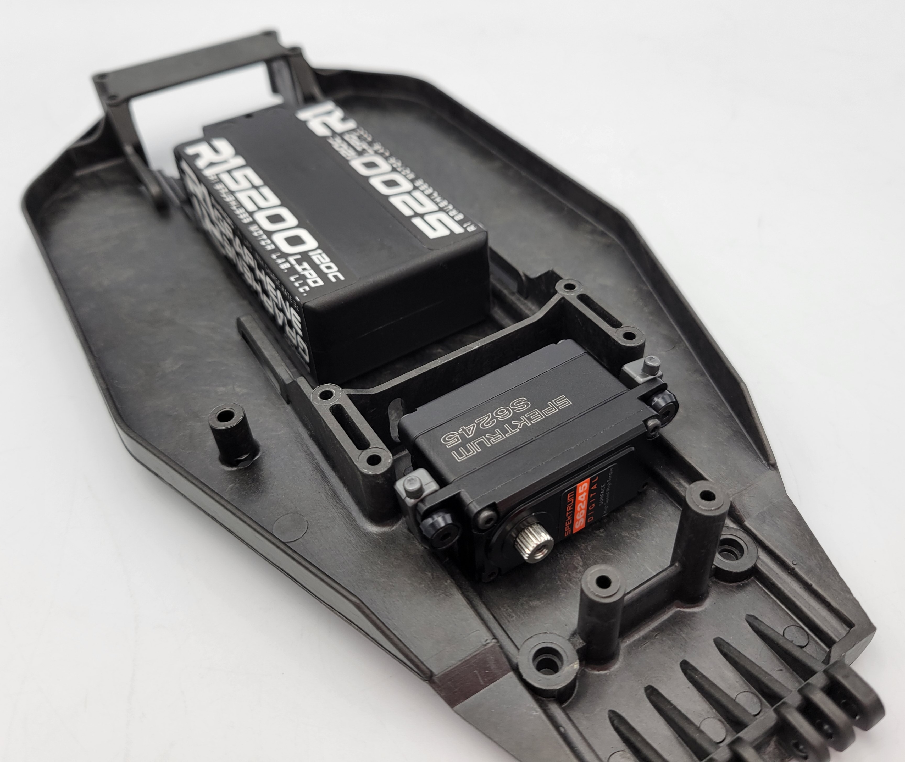

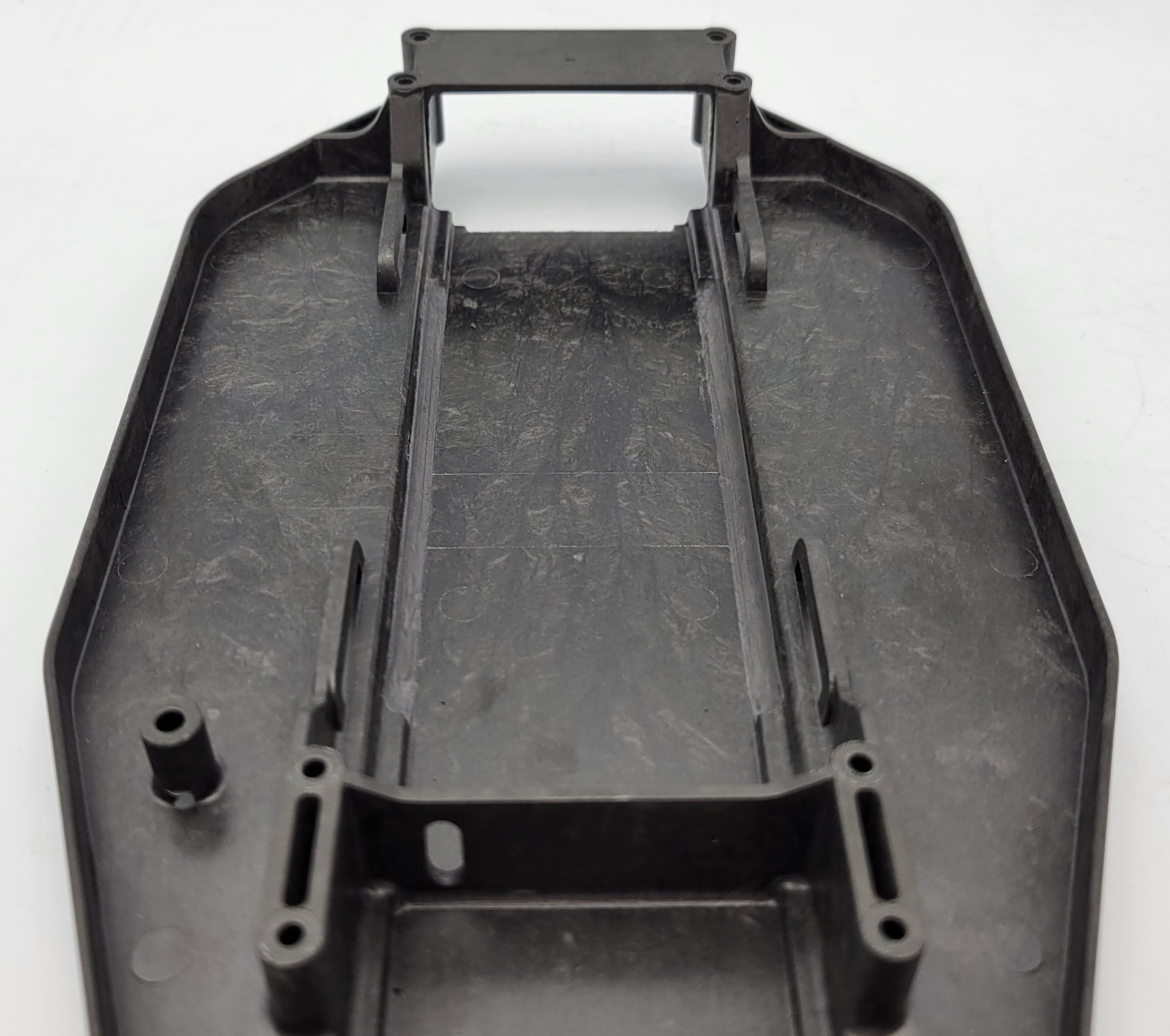

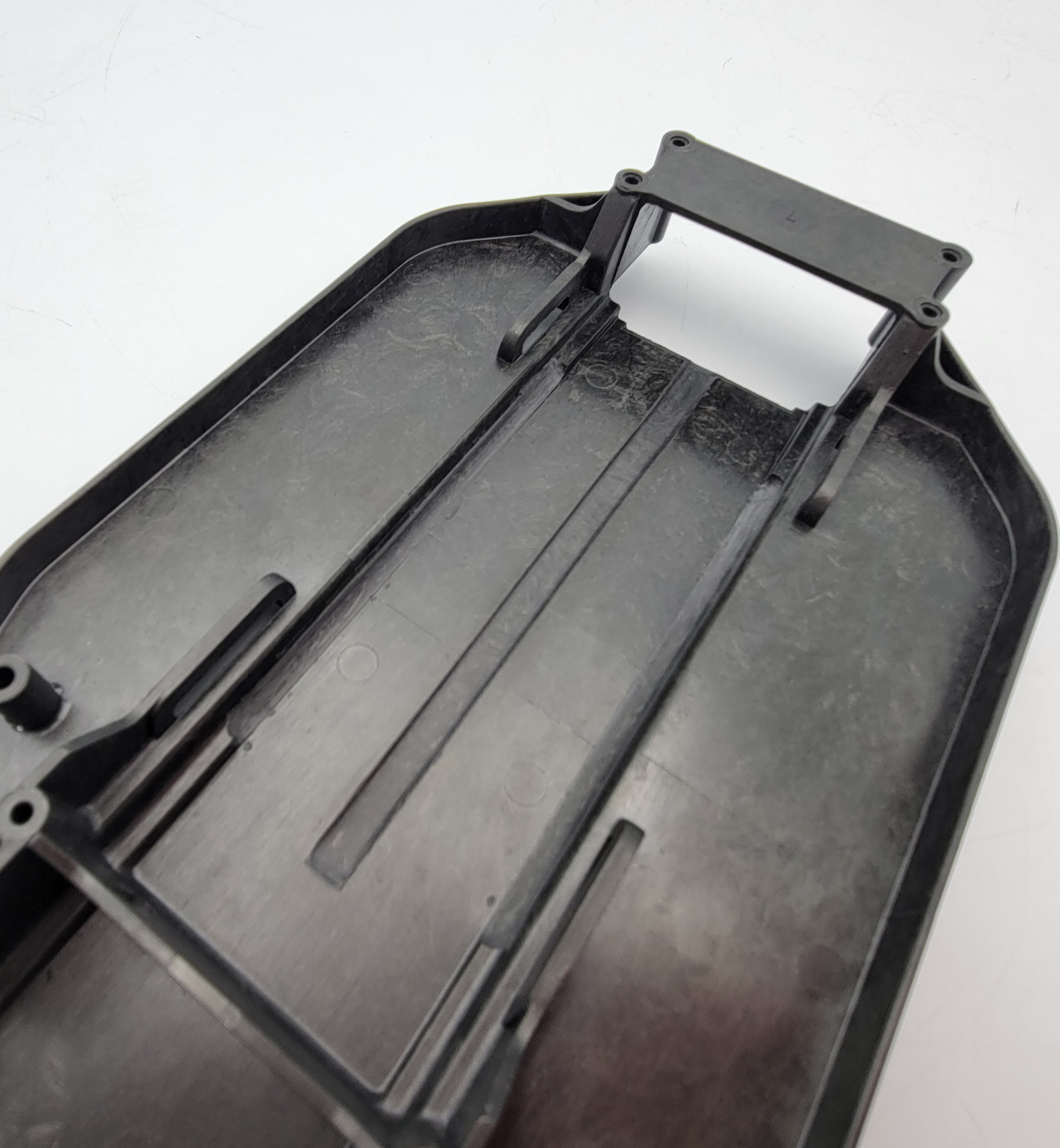

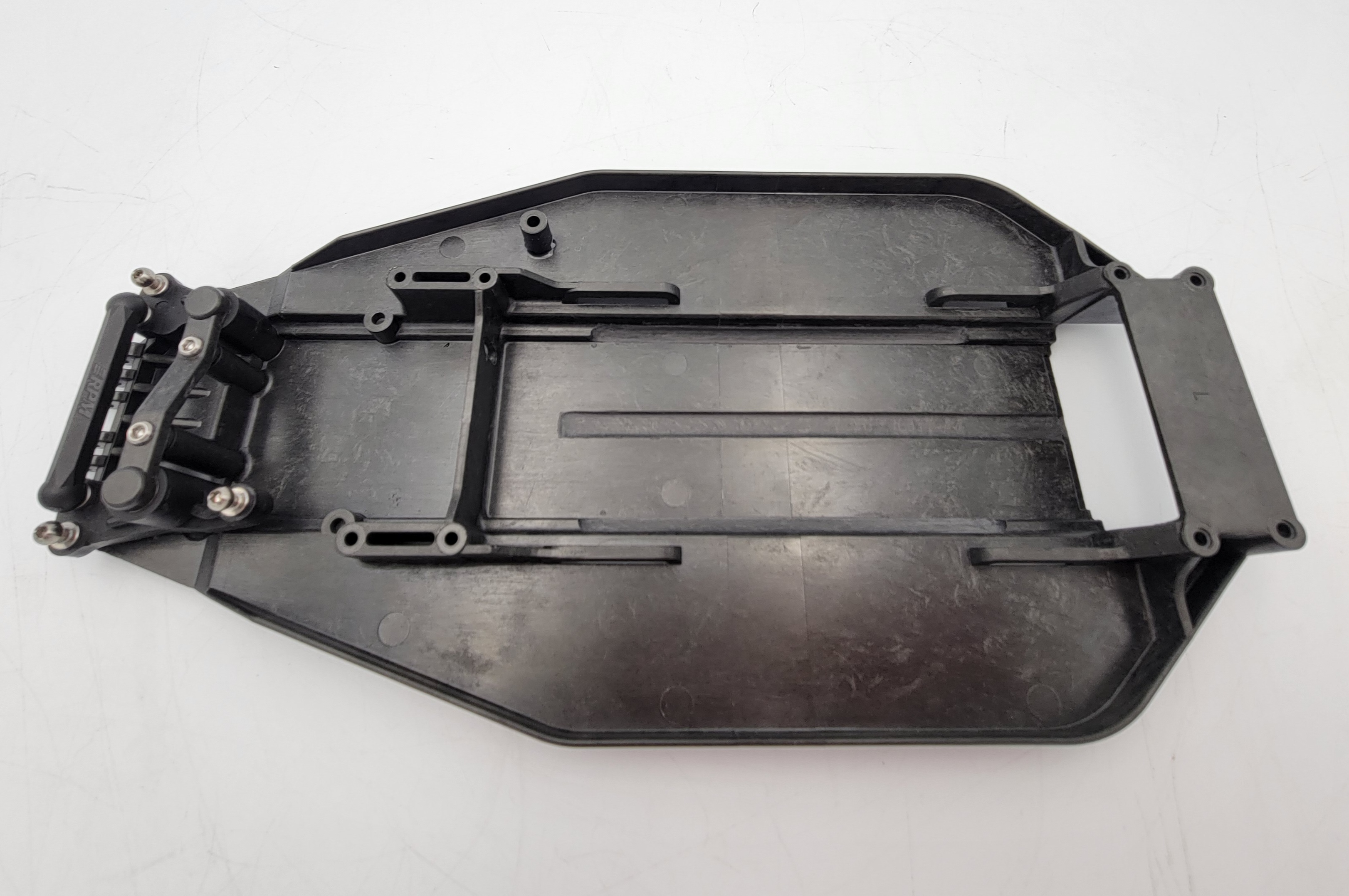

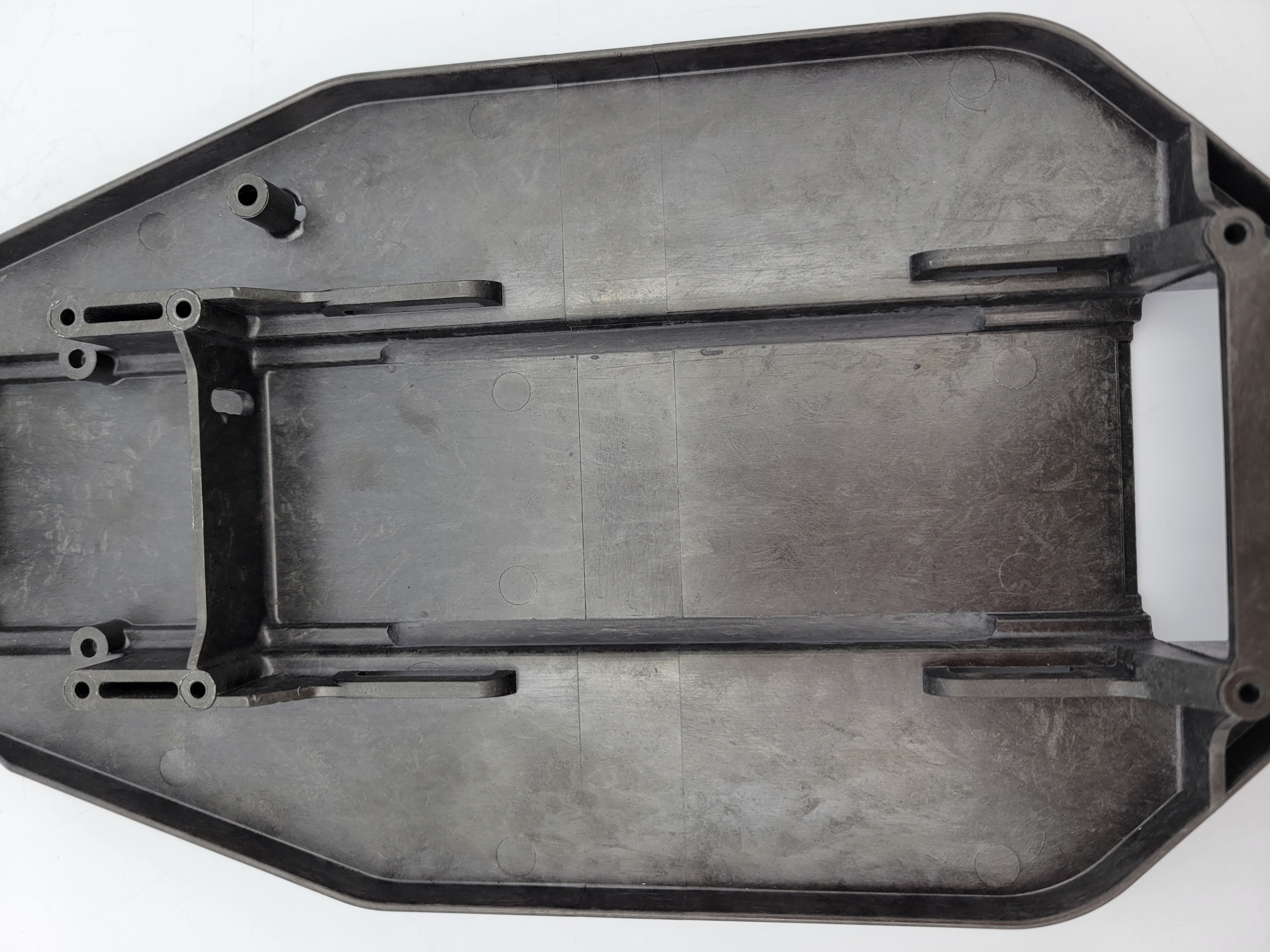

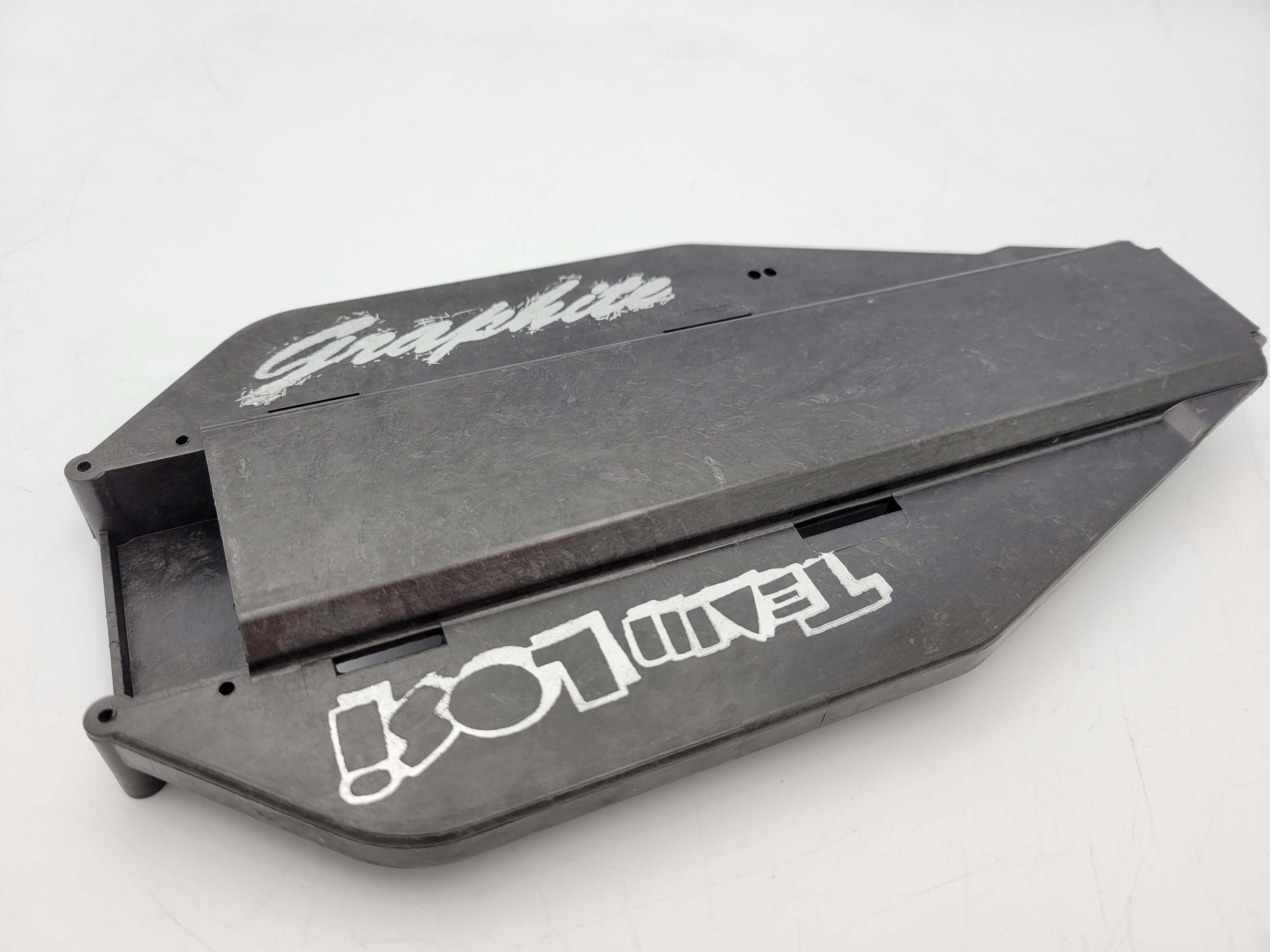

It was difficult taking the dremel to this brand new chassis. I cut the 2 sides of the middle channel so the battery can sit flat. I also cut a steering servo lead pass through hole. It's difficult cutting the lip cleanly by hand, but I'm pretty happy with the results. The battery covers it regardless.

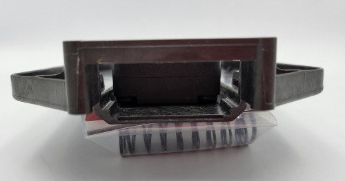

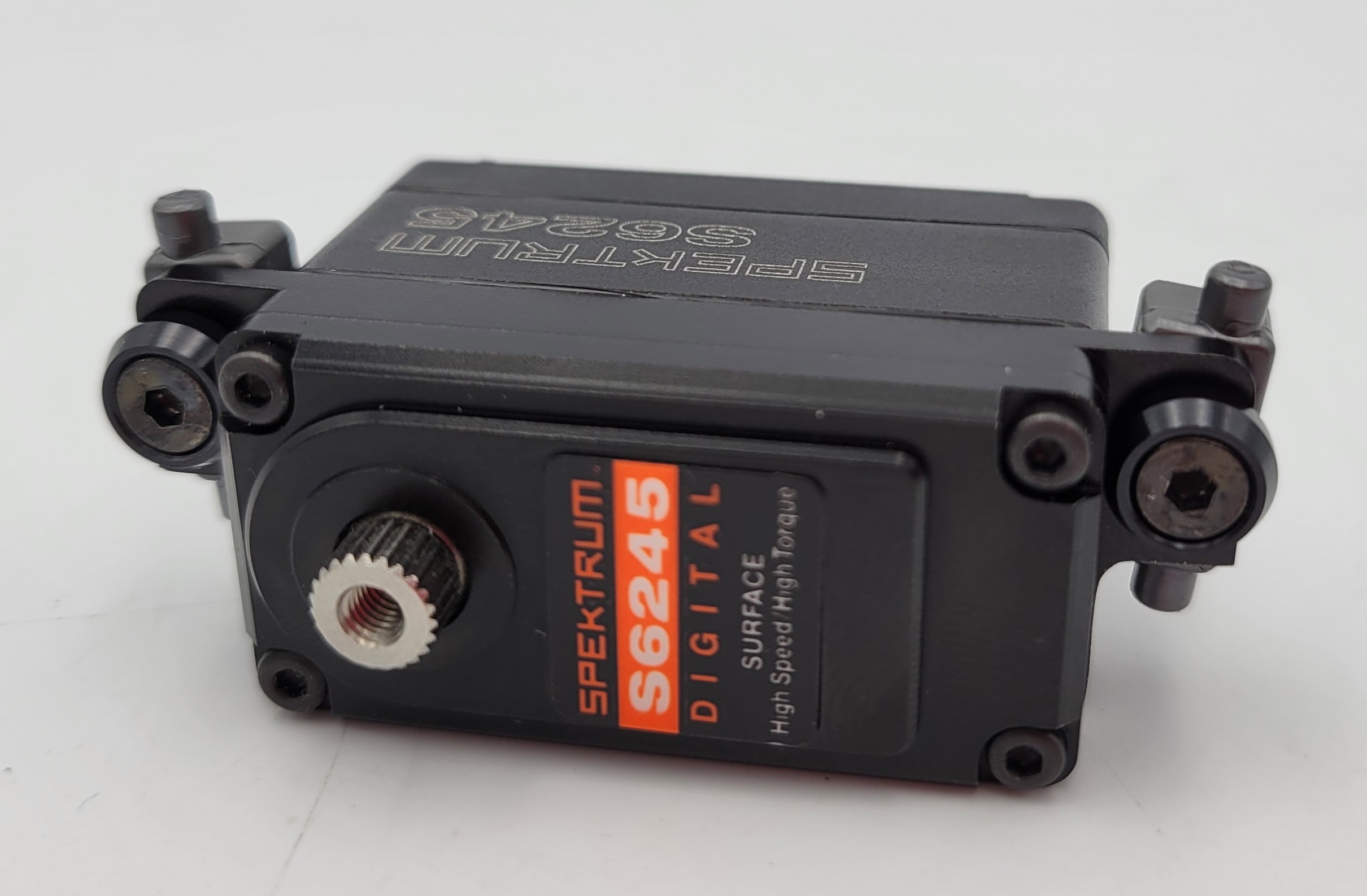

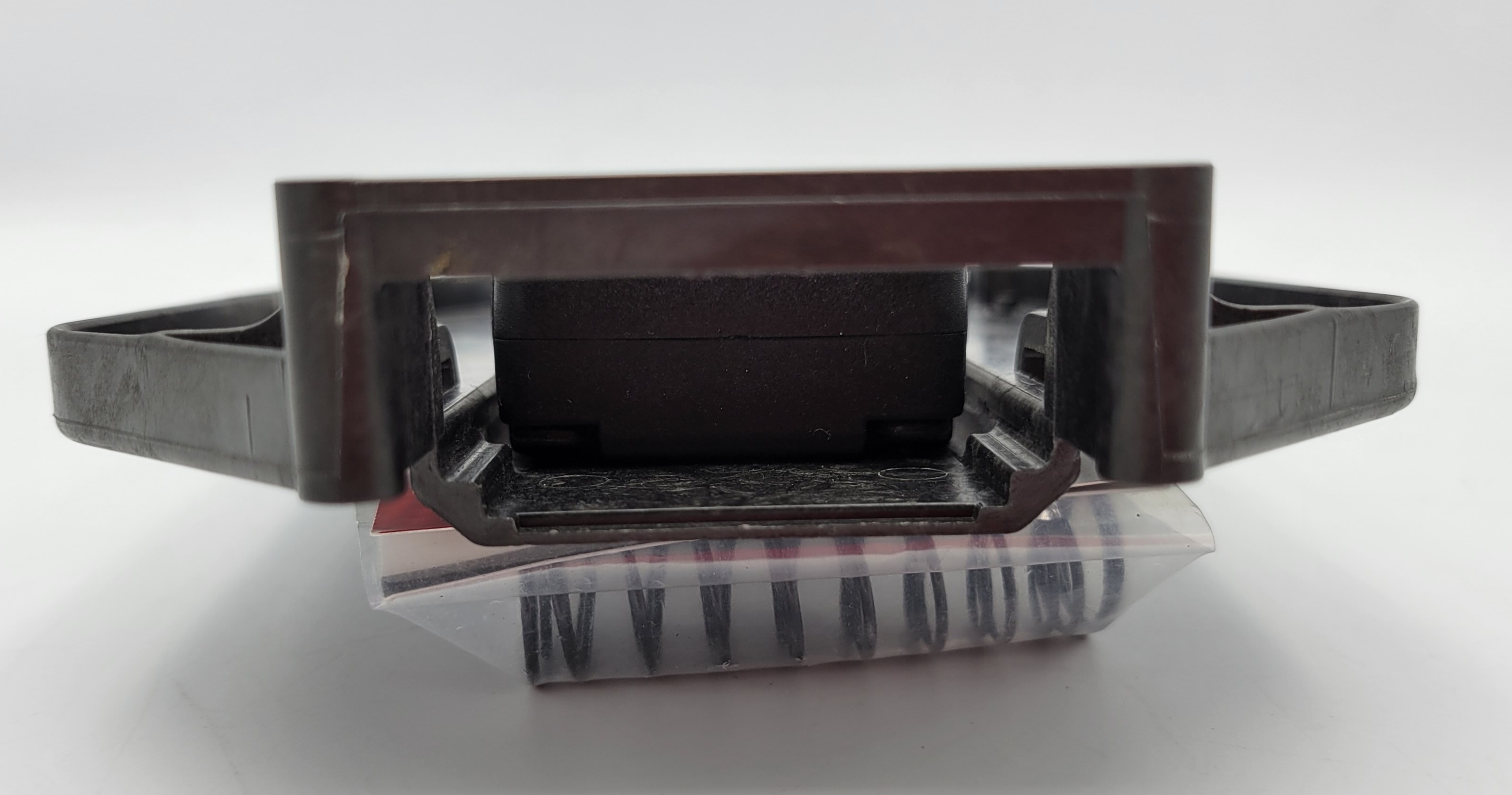

It was also difficult cutting the ears off this pretty Spektrum servo, but necessary for this chassis.

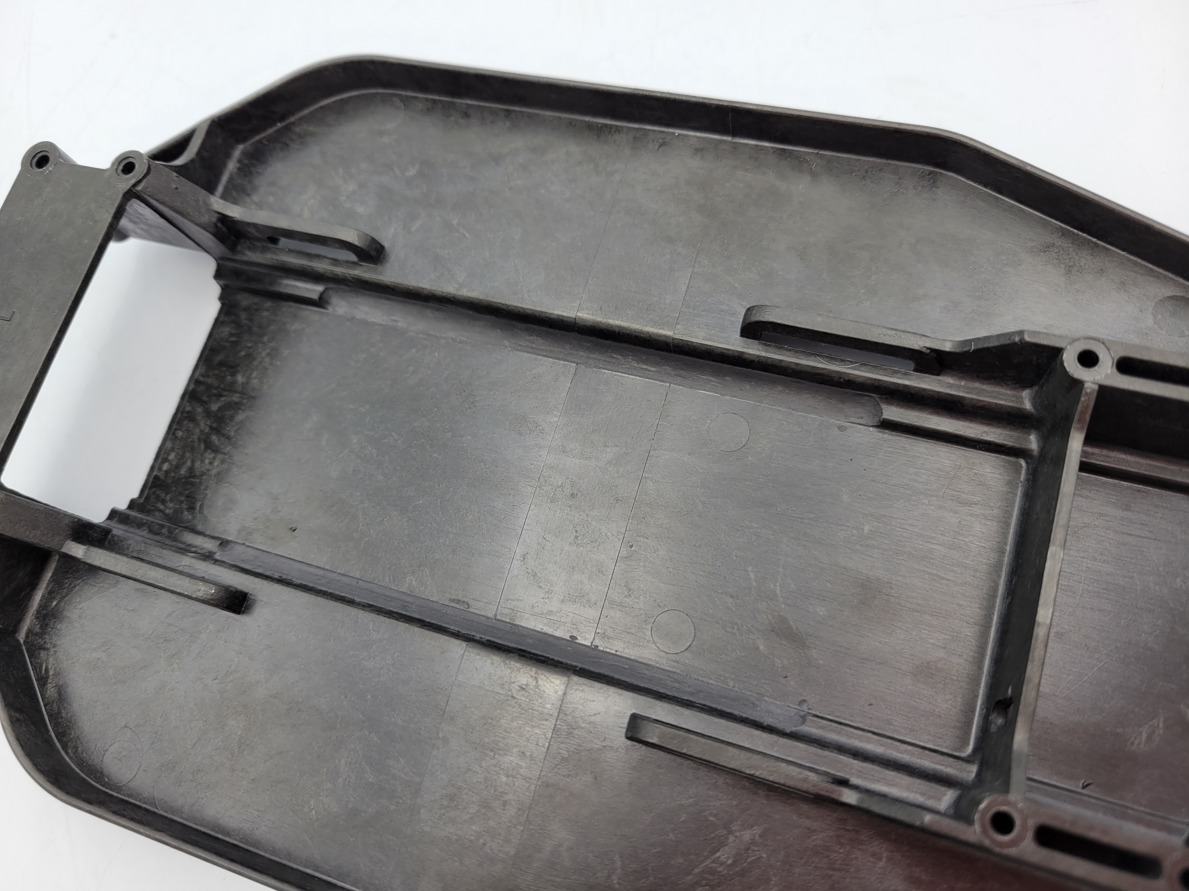

I also used a dremel to cut this servo/esc lead channel in the center of the tunnel. What a pain to do by hand!

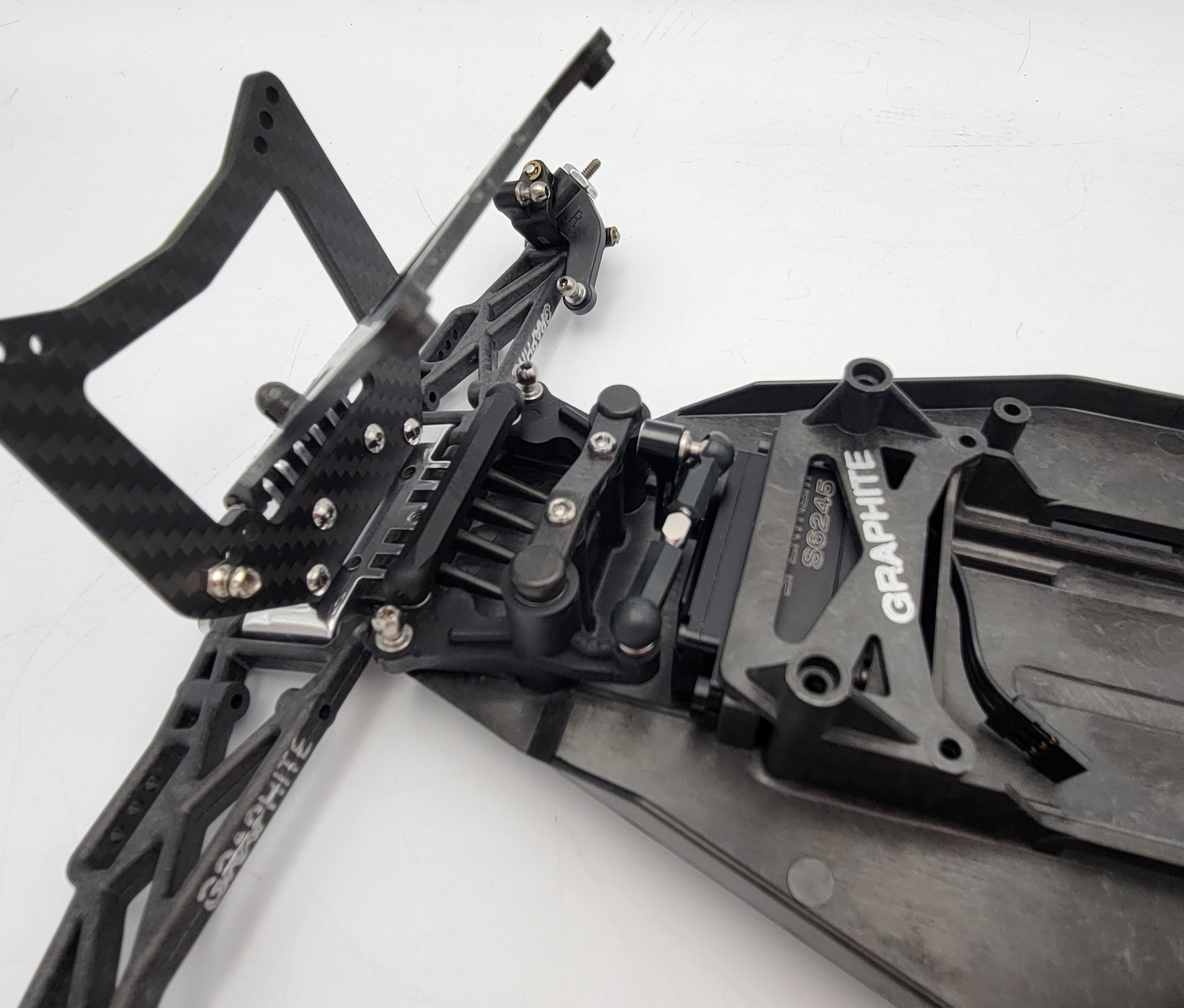

I'm a big fan of the MIP steering kit for the XX series. It's a huge improvement over the stock setup. After some tinkering and adjusting, this steering is perfectly smooth and slop free

I got this MIP steering from a parts XX buggy I bought awhile back. The MIP steering has become quite difficult or expensive to find.

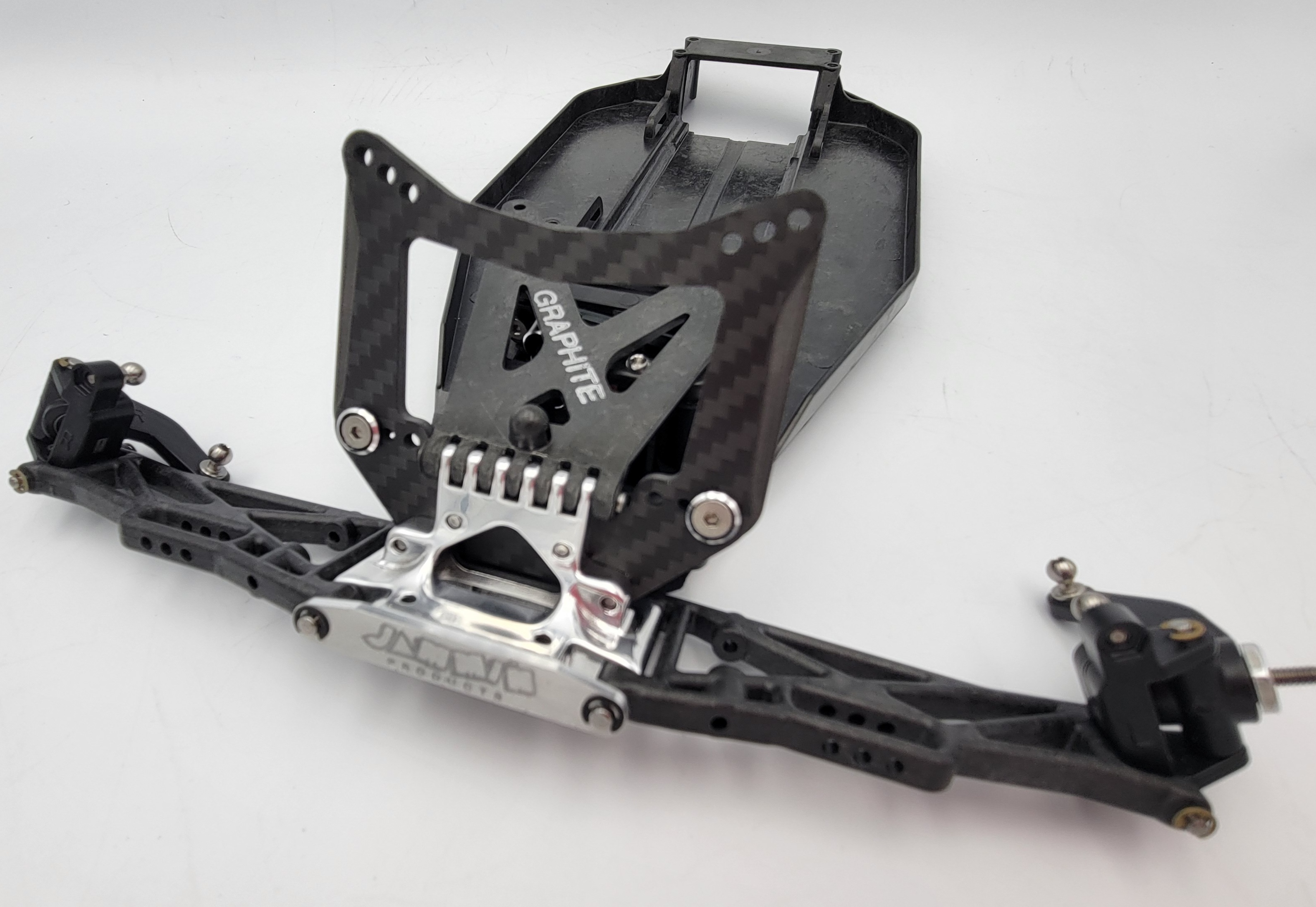

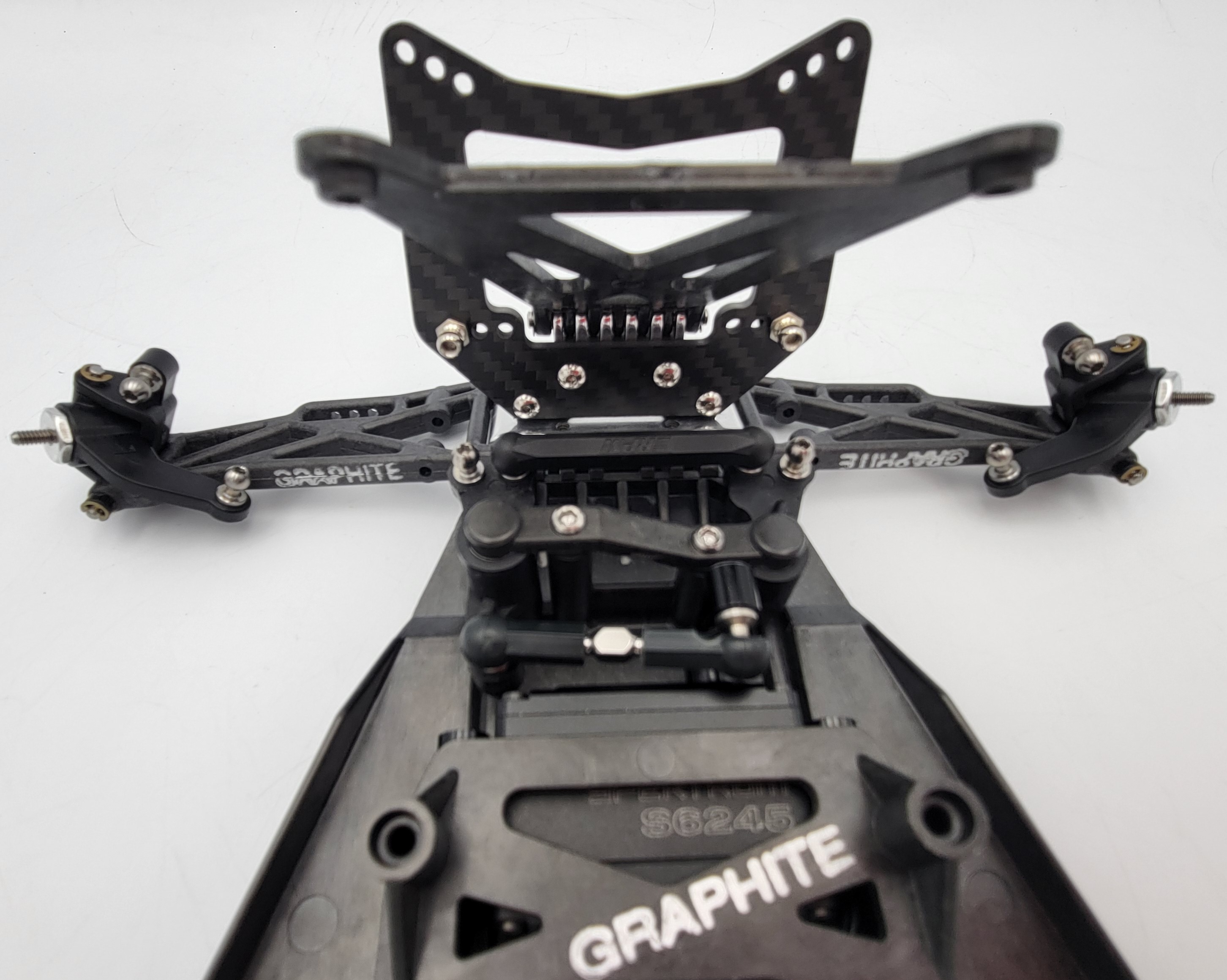

Re: Losi XX WOIN Racer build

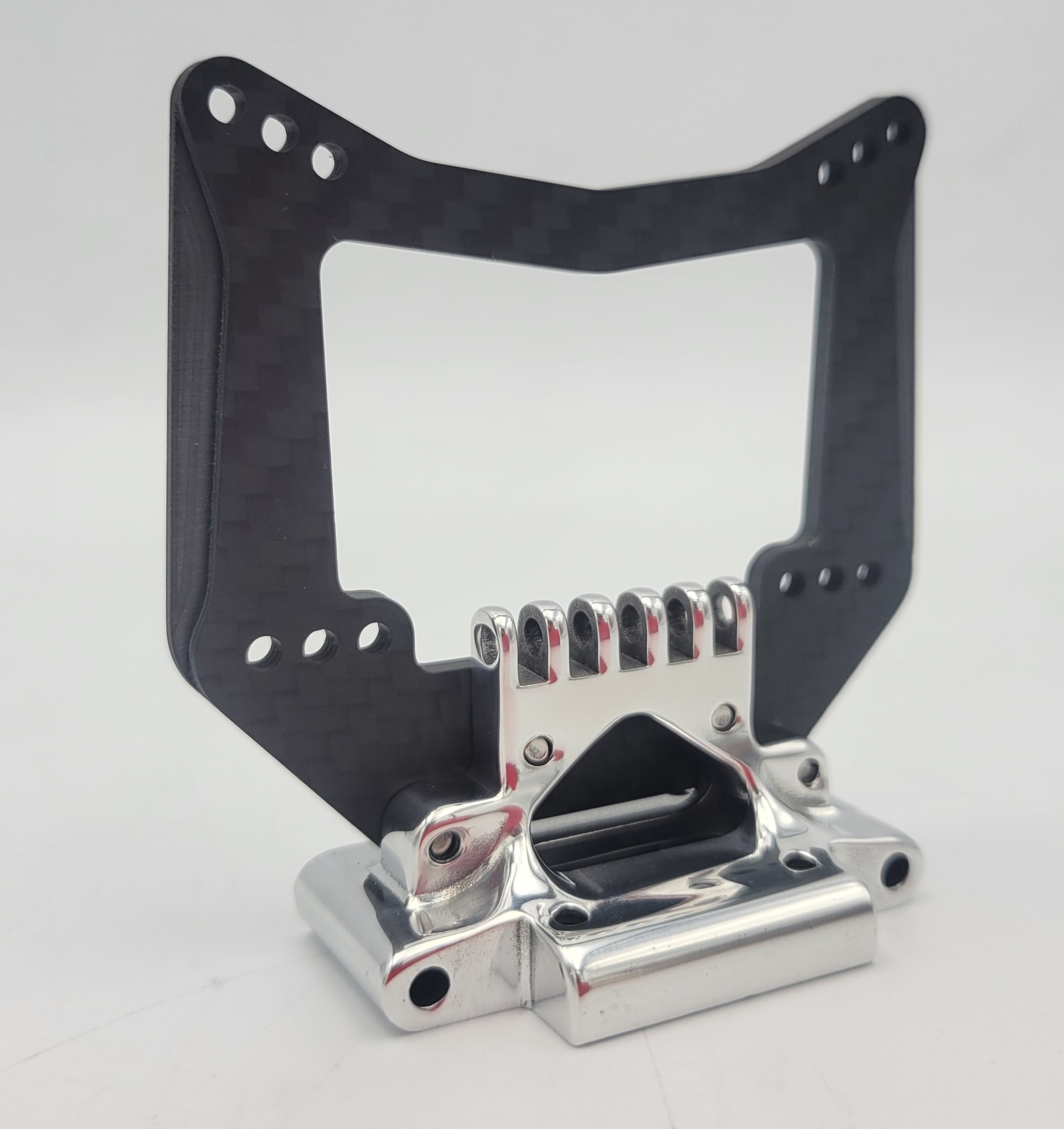

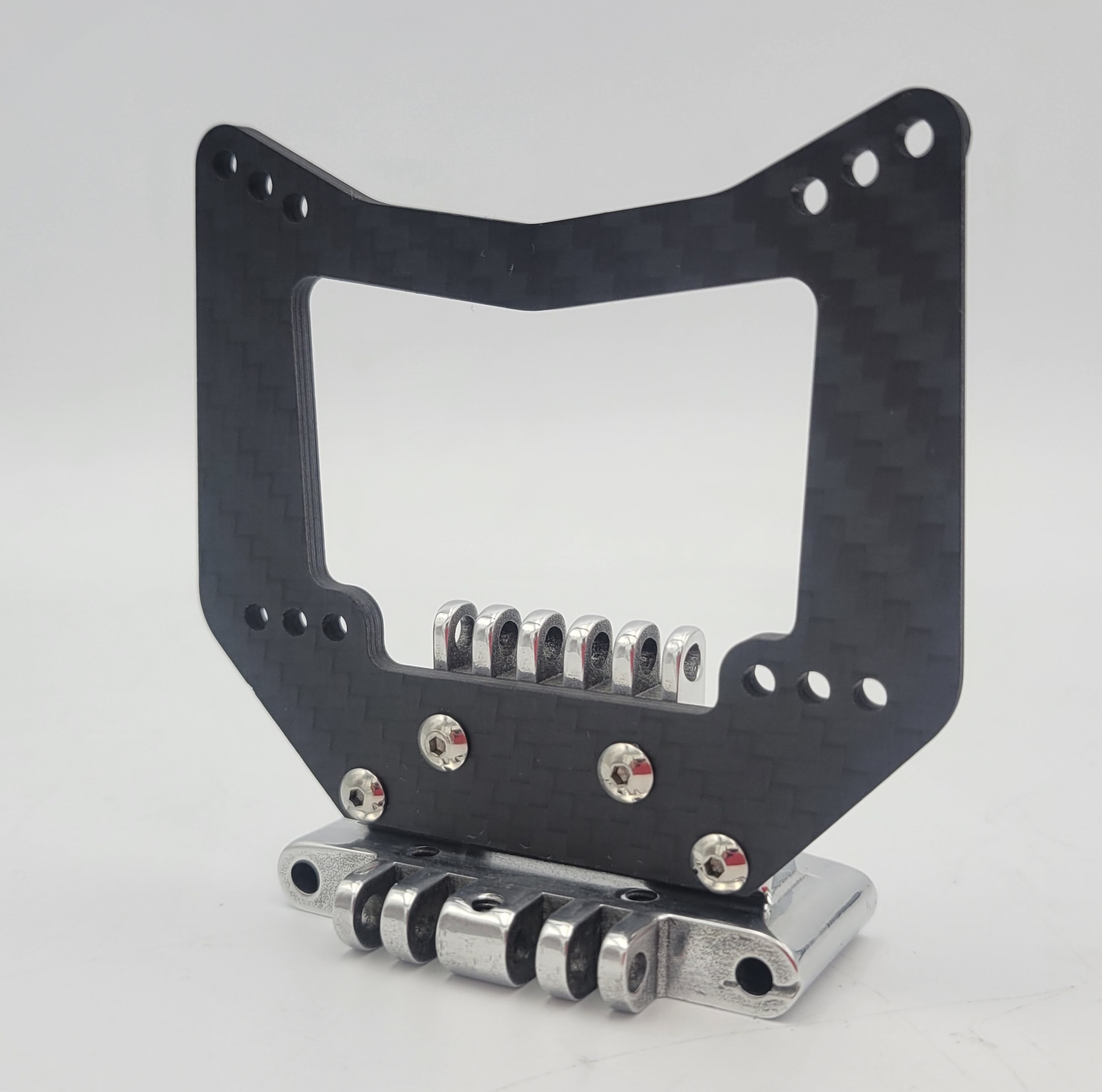

Front end is coming together. Titanium hinge pins and hardware is being used throughout. Rusti tower and Jammin front brace.
