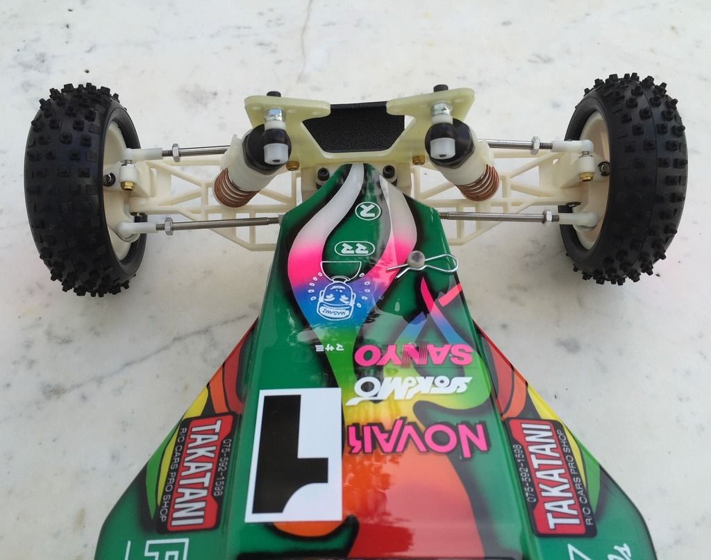

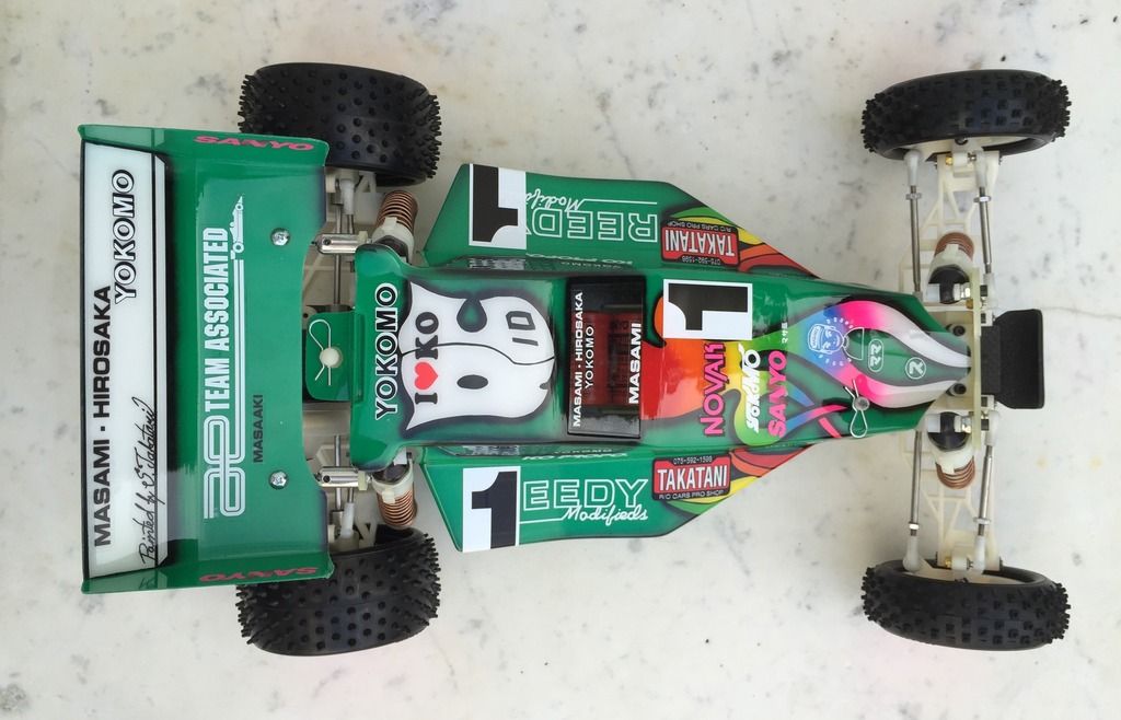

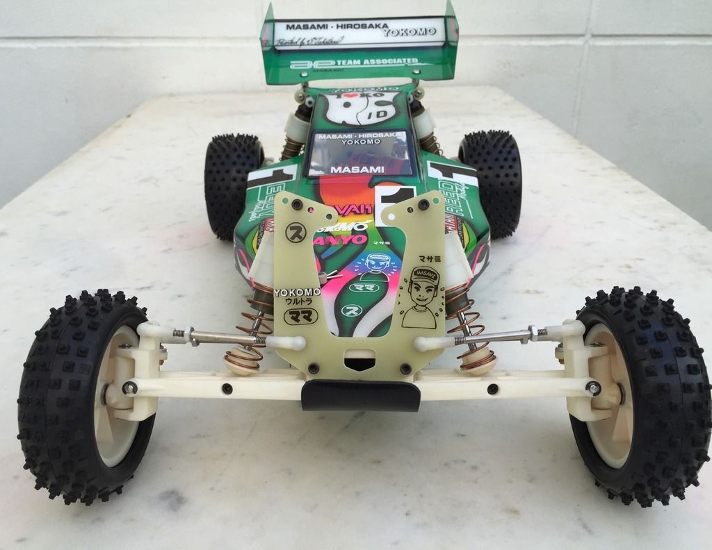

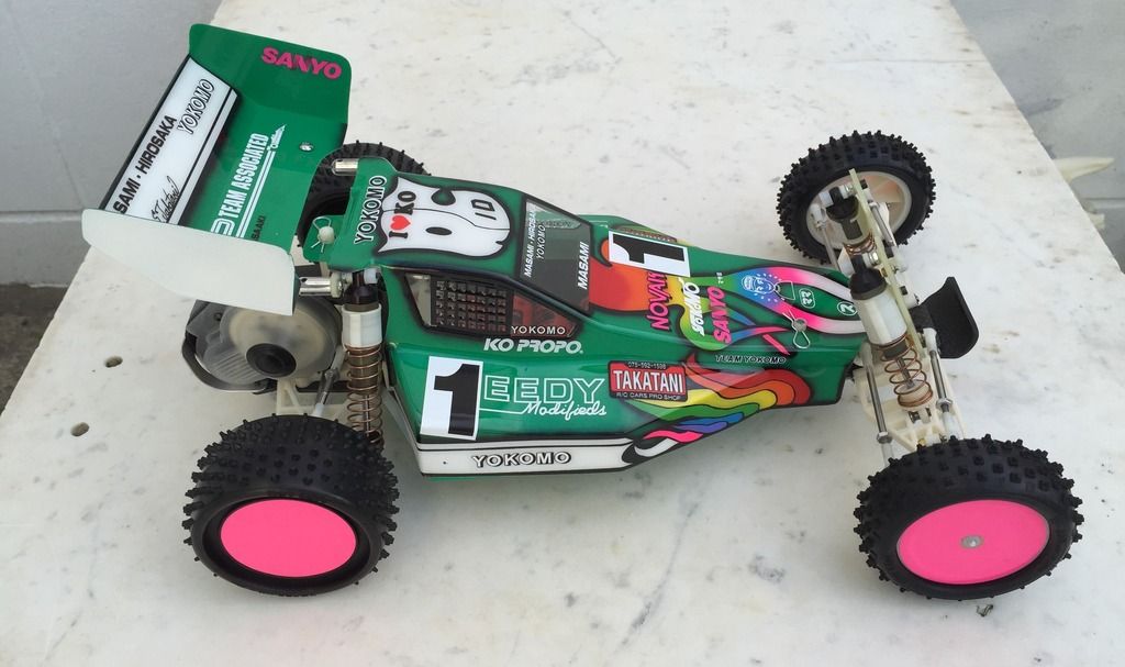

Worked a bit on the car over the weekend and mounted the wing, undertray and body. There are still a number of finer details to fix but it's getting closer and closer!
To do list:
- get wing mounts gold anodised
- change front bulkhead to 30°
- mill/modify rear wheel adapters
- source or custom make missing decals
- tune front camber/toe-in
- change motor capacitors to yellowish ones
- source missing electronics (Novak M1c ESC without the fuse, Ko Propo KR-285A (?) receiver and Ko Propo EX-5 transmitter(?))
- add velcro straps to the body/undertray
- cut vents into teh body
- drill the chassis and add antenna mount
- fabricate the Worlds orange label with the proper number
- etc.

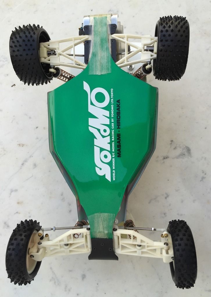

Here's how it sits right now:
Comparison shots: 1st is replica second is original
To do list:
- etc.

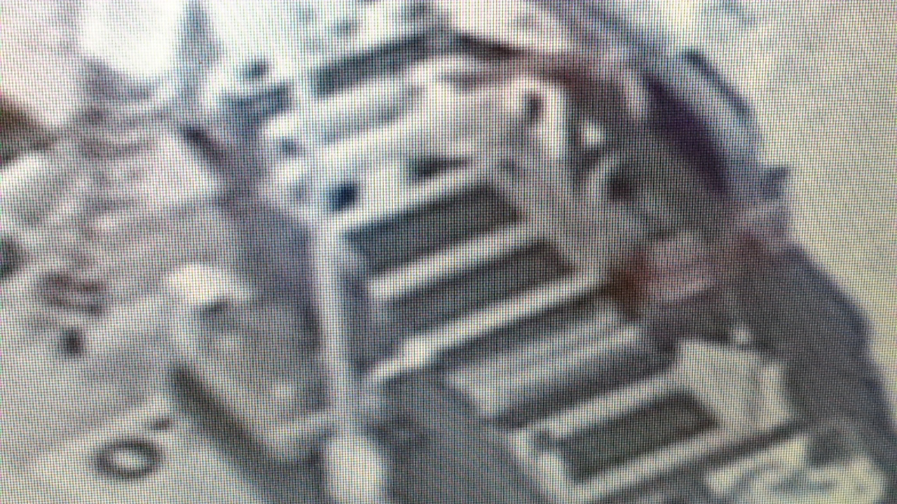

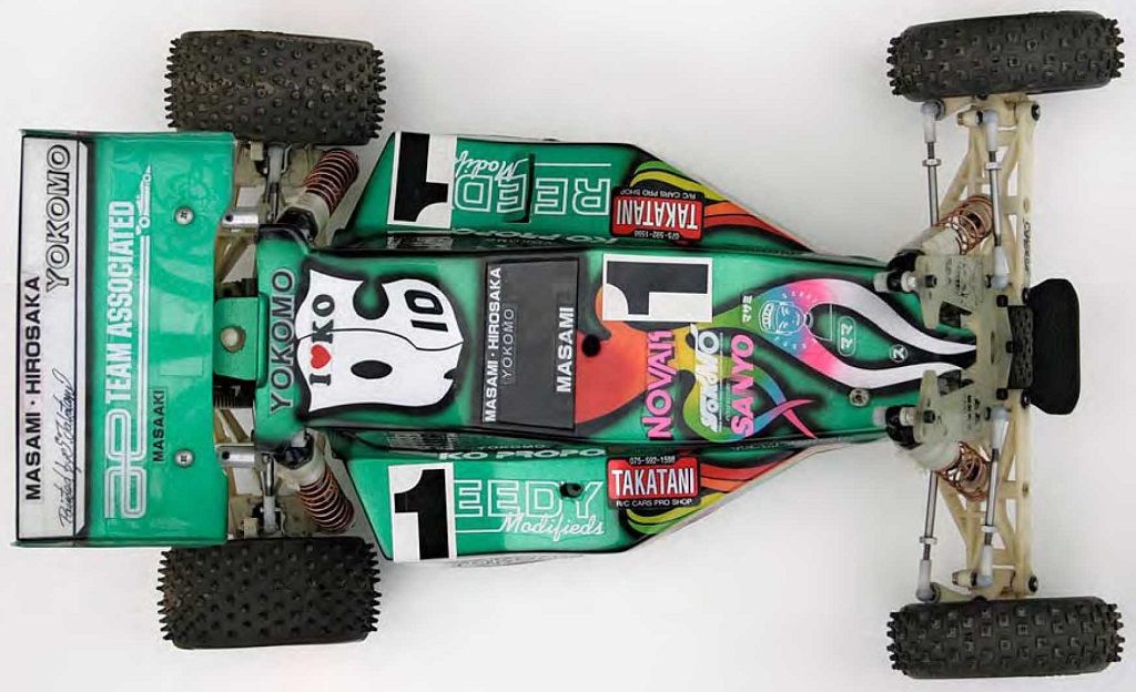

Different wings than the book car and the add, wonder what he won with?
Rod Littau
- Seabass
- Business Member
- Posts: 1402
- Joined: Mon Jul 27, 2009 8:34 pm
- Location: Mississippi
- Been thanked: 12 times
Re: - '91 Stealth Masami replica -
Looks great and I know you have to be happy with the way the car looks so far. I know as I got closer to finishing mine, I was surprised how well the car came together.
Look forward to the finished product.
Jake
Jake
- Asso_man!
- Posts: 3960
- Location: EU
- Has thanked: 40 times
- Been thanked: 82 times

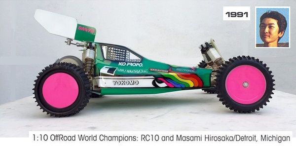

I also noticed that, but it has probably to do with a very poor resolution and distorted picture. Most of the colours are faded and probably that green on the wing side dams is supposed to be white? I went by the book as it is to me the best reference! One thing I'm almost sure though is that Masami used a Japanese version of the gear cover with a wider red plug. I've seen a few pictures where it appears and besides the ad picture, there's is no picture/video showing a US version. No to source such a gear cover is a quest in itself...slotcarrod wrote:Different wings than the book car and the add, wonder what he won with?

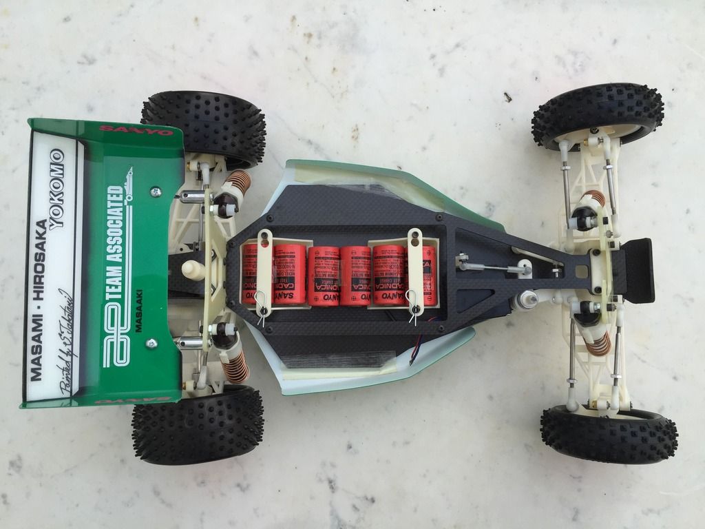

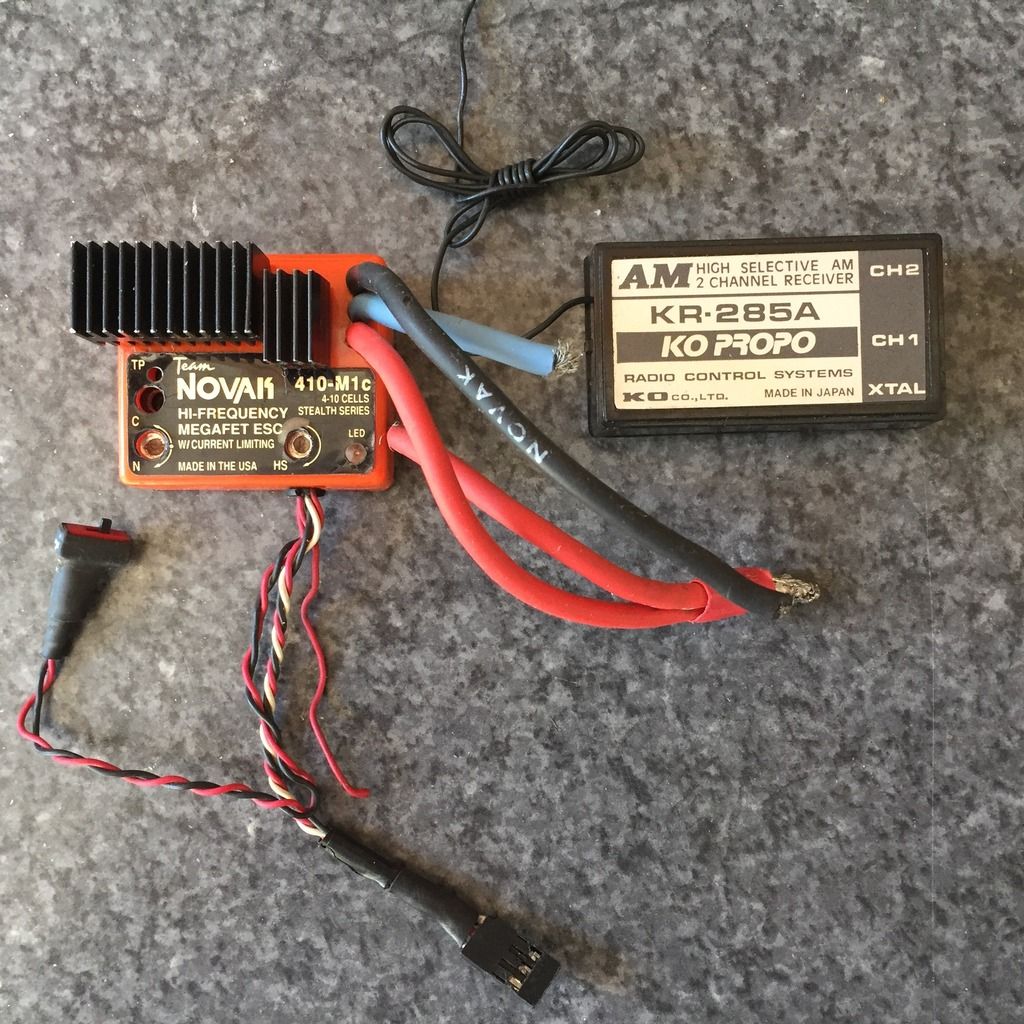

Thanks for the compliments gents! Finally found a nice KR285A together with a 410M1c that will require some painful rewiring. Getting really close to the finish line!

Does anyone know the gauge of the original battery/motor cables on the Novak 410M1c? 12 gauge is my guess but need to be sure not to buy the wrong cables?

I'm sure they are 12g wires but I went through the whole manual and found no reference: http://www.manualslib.com/manual/401695/Novak-410-M1c.html?page=14#manual . It may be written on the box though. The funny thing is, my brain keeps telling me 11 gauge.Asso_man! wrote:Does anyone know the gauge of the original battery/motor cables on the Novak 410M1c? 12 gauge is my guess but need to be sure not to buy the wrong cables?

if you have wire strippers that have the gauge marking on them, you can figure out what size it is by stripping the end of the old wire. It looks by eye to be 12 gauge but it might be an oddball 11 gauge. If it fits nicely in 12, it's a 12, if you trim off a handful of whiskers its 11 gauge.
i would bet 12 and 11 gauge would have the same jacketing diameter, or so close it wouldn't matter either way. I suspect you would have a nightmare of a time trying to find Novak 11 gauge wire as well.
