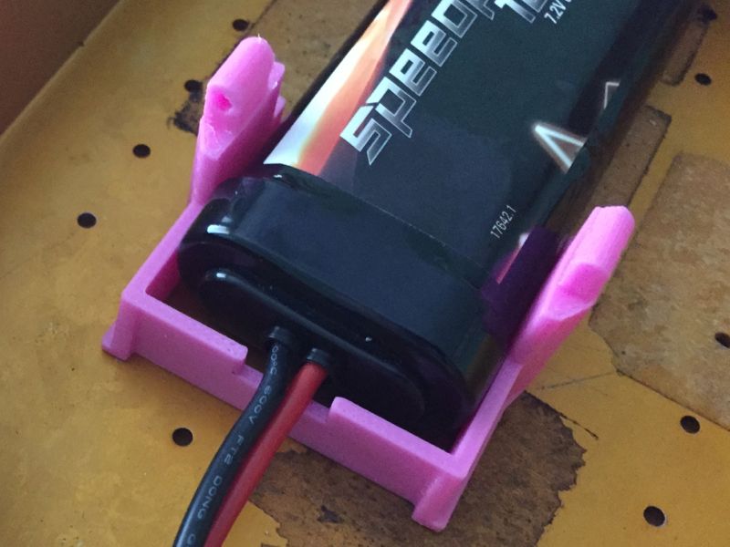

Oh that makes sense now. I actually started with the RC10T chassis and then went to the RC10 Gold Pan and thought I was losing my mind. Thought the chassis holes for the bulkhead had been put in crooked. Couldn't understand why things didn't line up straight.gomachv wrote:They offset the holes for speed control clearance on the side. Originally the battery was to run down the middle with servos on either side.
Ha, nope, but that was addressed as well in these. They wanted the wire routing clip design.jwscab wrote:what is the 'extra wires' part you mention? clearance for end exit of pack wires?
As seen here in the losi version.
- Attachments
- 2829-3217.jpg (25.44 KiB) Viewed 2101 times

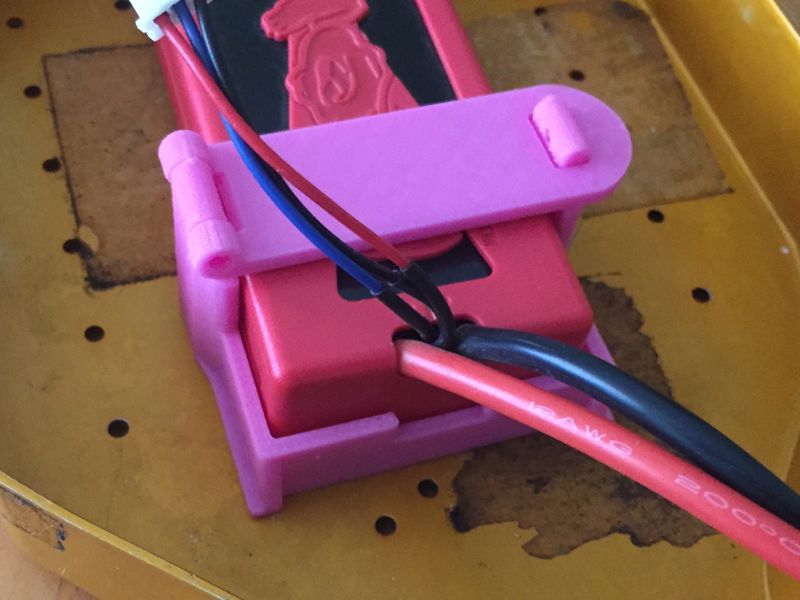

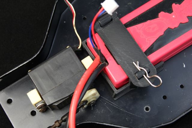

I wasn't going to go into much detail, but after someones great guess on a possible feature I thought I would go into more detail. I have more testing and tweaking to do. Feedback is welcome since I am out of my element on Associated models.
These have been made mainly to address a couple requests to fit the smaller LIPO packs around 45mm in width and height that fits original bulkhead. Also the other request was for one to work with NIMH stick packs which are longer than old NICAD packs. I also have a Losi one that was done custom a while back for the new NIMH stick packs. That will also be coming out soon.
The packs for reference that I know will fit.
http://www.horizonhobby.com/cars-and-trucks/batteries-15134--1/speedpack-1800mah-nimh-6-cell-flat-dyn1050
http://www3.towerhobbies.com/cgi-bin/wti0001p?&I=LXTCE1&P=ML
Here are some early pictures. First 2 pictures are of the holder on offset chassis. Second 2 pictures are holder on black B stamp chassis that has the holes farther forward.

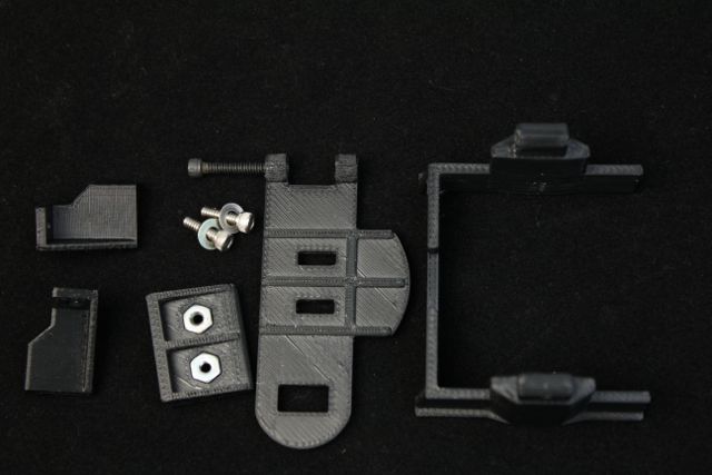

These are pretty much finished now. Right now just have final prints of the versions without the wire clip. Then get them up on the store.
I have now tested on 3 different chassis setups.
Gold Pan A stamp with offset holes.
The TQ chassis with centered holes.
The late model black chassis with centered farther forward holes.
These will allow up to 3 different battery types to be used depending on the setup you buy.
3 different models for each chassis. Universal, Basic, and Shorty Lipo Only. No more hacking your chassis or battery cups. None of them require and permanent changes to your chassis or other parts.
Won't do full write up here, put that in the Business section.
