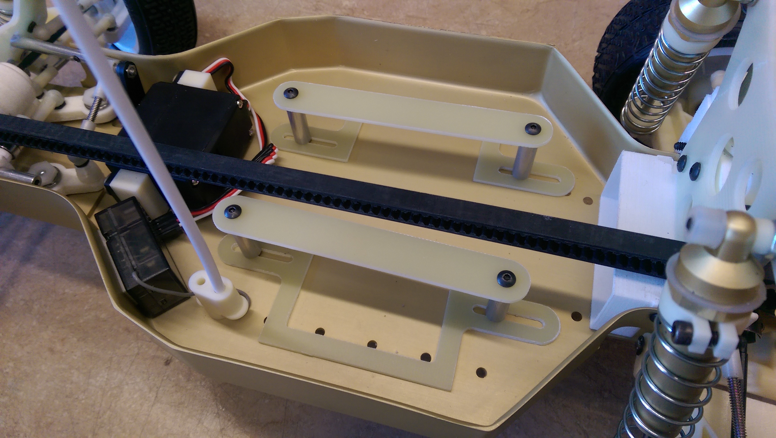

2. I would like to convert to Lipo and I see many people running the battery tray down the centerline on the pan. Do I have to drill and countersink new holes to attach the battery box in this position? Is it better to just keep th battery box spanning the width of the chassis?

If you decide to run a shorty lipo I have bolt in trays that will be for sale soon, once my machine is back together.
No drilling needed
Otherwise you can use a long battery strap and standard battery mount along with foam spacers
No drilling needed

Are they the Original trays? I have the original ones that came with the car but it seems they only line up with the holes in the chassis when they are mounted width-wise.
I am hoping to find a tray that will mount in the existing holes and line up with the battery recess in the rear bulkhead.

For some other lipo battery mounting options, see here: http://www.rc10talk.com/viewtopic.php?f=92&t=38736.

I have decided to swap to the "new" rear bulkhead and drill/tap new holes for the battery tray and run the battery down the centerline. I think I have figuresd out all the other questions too!

Thanks for the replies. It's going together now. I decided to change the rear bulkhead and drill the front battery tray holes....I know, I know! I plan to just run it around the yard a bit and it will really just sit on the shelf.
